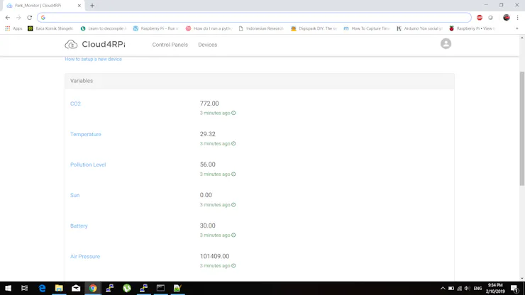

If everything work correctly open your device menu on cloud4rpi and should get this screen
![Data has been retrieved]()

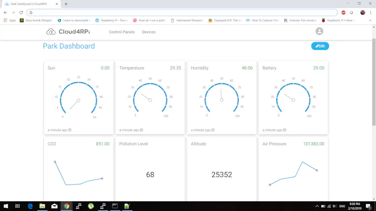

Now you can make your own dashboard on the control panel menu based on the data you just sent
![Project Dashboard]()
Project Dashboard
