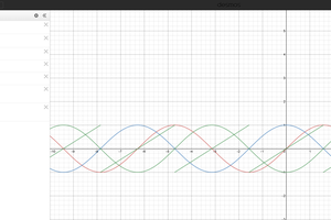

Dan Royer wrote 06/10/2019 at 19:18 • point
I'm even prepared to go RGB sensor and put three colors on the paper.  My hope is that it gives greater precision and no wrap-around error where 0 is mistake briefly for 180.
Simon Merrett wrote 06/10/2019 at 19:38 • point
I haven't thought hard enough about this but is there really a wrap around error? If the transition from black to white is perceived as constant across the rotation and is darker at 45 degrees from the black than it is from the white, at what point do you see the error?
Dan Royer wrote 06/10/2019 at 19:57 • point
Imagine a rectangle of paper divided diagonally with one half black.  Rolled around a drum, it forms a saw tooth when the paper loops at 0 degrees.  Two sensors would fix this.  one RGB sensor with three offset saw teeth should also work.
Simon Merrett wrote 06/10/2019 at 21:23 • point
But that's not what the grayscale technique in the link I posted produces, is it? Two monochrome sensors would give continuous absolute position without wrap around.
Dan Royer wrote 06/10/2019 at 22:11 • point
correct.  I was considering methods that might use less parts and then be cheaper.
