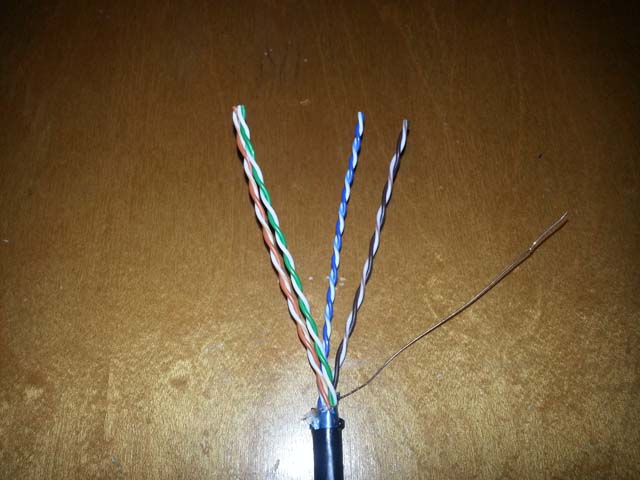

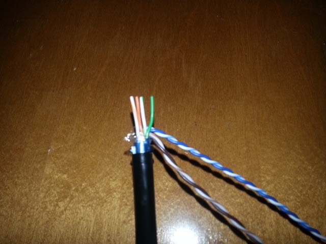

Since the cable will be partly outdoors, it is ideal to use outdoor UV Stabilized Ethernet cable (I happened to have Ubiquity TouchCable on hand). Strip a generous amount of cabling because you will have to start over is your Blue/Brown pairs are too short.
- If your cable has an uninsulated ground wire like mine did, just cut it off
- Break out the Blue and Brown pair, leaving them long so they can be used for power
- Shorten the Orange/Green pair since they will be going into the RJ45 connector

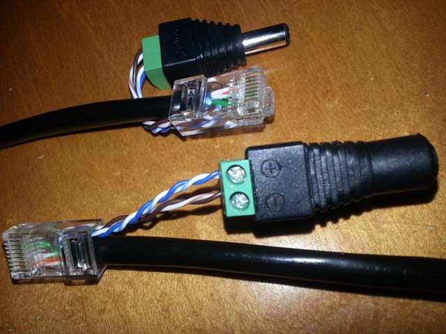

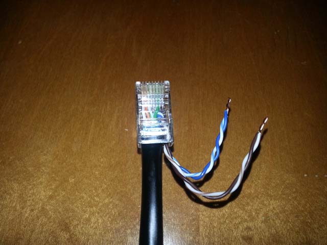

Terminate the end per the T568B wiring order, but only using the Orange and Green pairs:
Pin1: White/Orange
Pin2: Orange
Pin3: White/Green
Pin6: Green
Pins 4/5/7/8 will be empty in the RJ45 connector. The Blue and Brown pairs should be stripped at the end and twisted together. Optionally you can use a small amount of solder to fuse them together, but don't use too much or they may not fit into the DC connectors.![20141130_125915]()
I used the Brown pair (normally pins 7/8) to carry Negative, and the Blue pair (normally pins 4/5) to carry Positive. This is in line with the IEEE 802.3af using spare pairs standard. Insert the stripped wires into the connectors and tighten them down firmly. You will do the same thing at both ends, using a male DC jack on one the uRADMonitor end of the cable, and a female DC jack on the network end. You should end up with something like this:
(Don't forget the cable is easier to feed through holes BEFORE you terminate it, as I forgot!)![20141130_001251]()

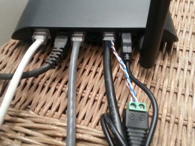

Verify the polarity on the uRAD end remains correct after traveling through your cable by using a multimeter. On the device side, I had barely enough cable length to be able to reach the DC port. On the indoor side, I used the included USB to DC Barrel Jack cable that came with my device to connect my terminated cable to a power source. The router I use happens to have have a powered USB port which I was able to use to power my uRADMonitor.
![20141129_235246]()
![20141130_152232]()
I opted to add a little hot glue to the back of the connectors to keep moisture out.

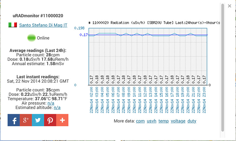

Most of them have regular readings. The unit in Italy registers the highest radiation values, with 0.17uSv/h:
![11000020]()

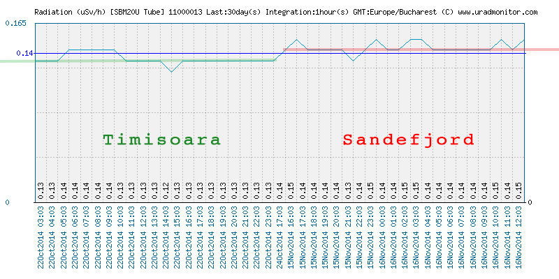

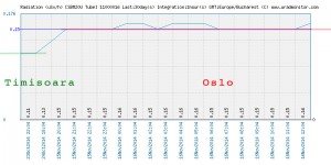

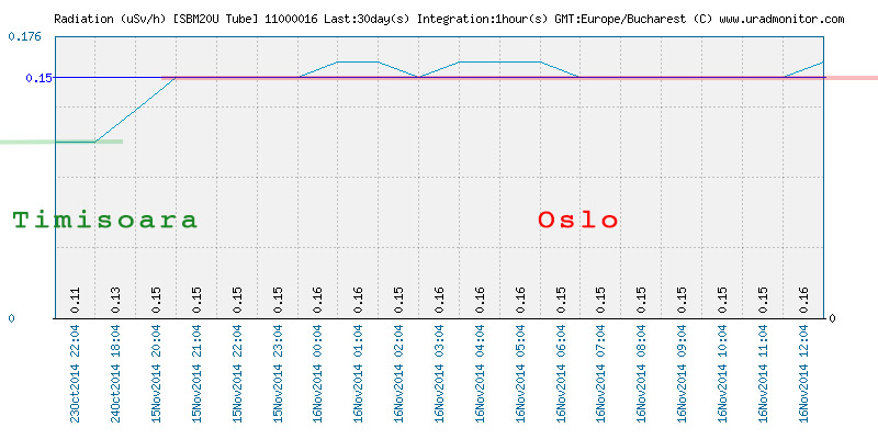

Two units went online in Norway, the 11000016 in Oslo, and the 11000013 in Sandefjord.
The measurements show higher readings compared to the tests performed in Timisoara:
![11000013]()

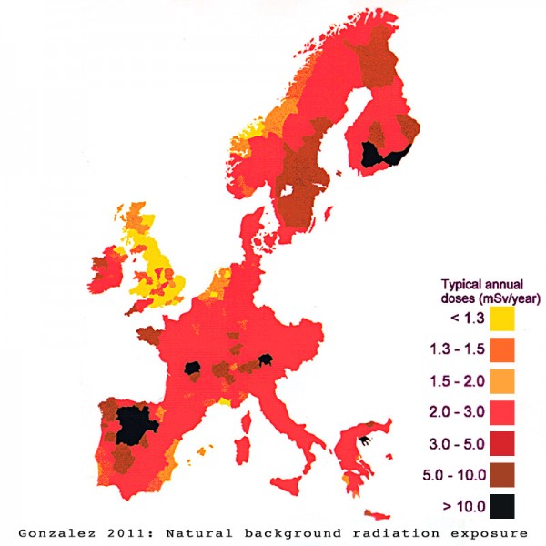

The Northern Europe seems to have a relatively higher background radiation. Here is a map that shows some of the background radiation levels measured across parts of Europe. Much of this is due to the radon:![NaturalbackgroundradiationEurope]()
Source and more details, here. -

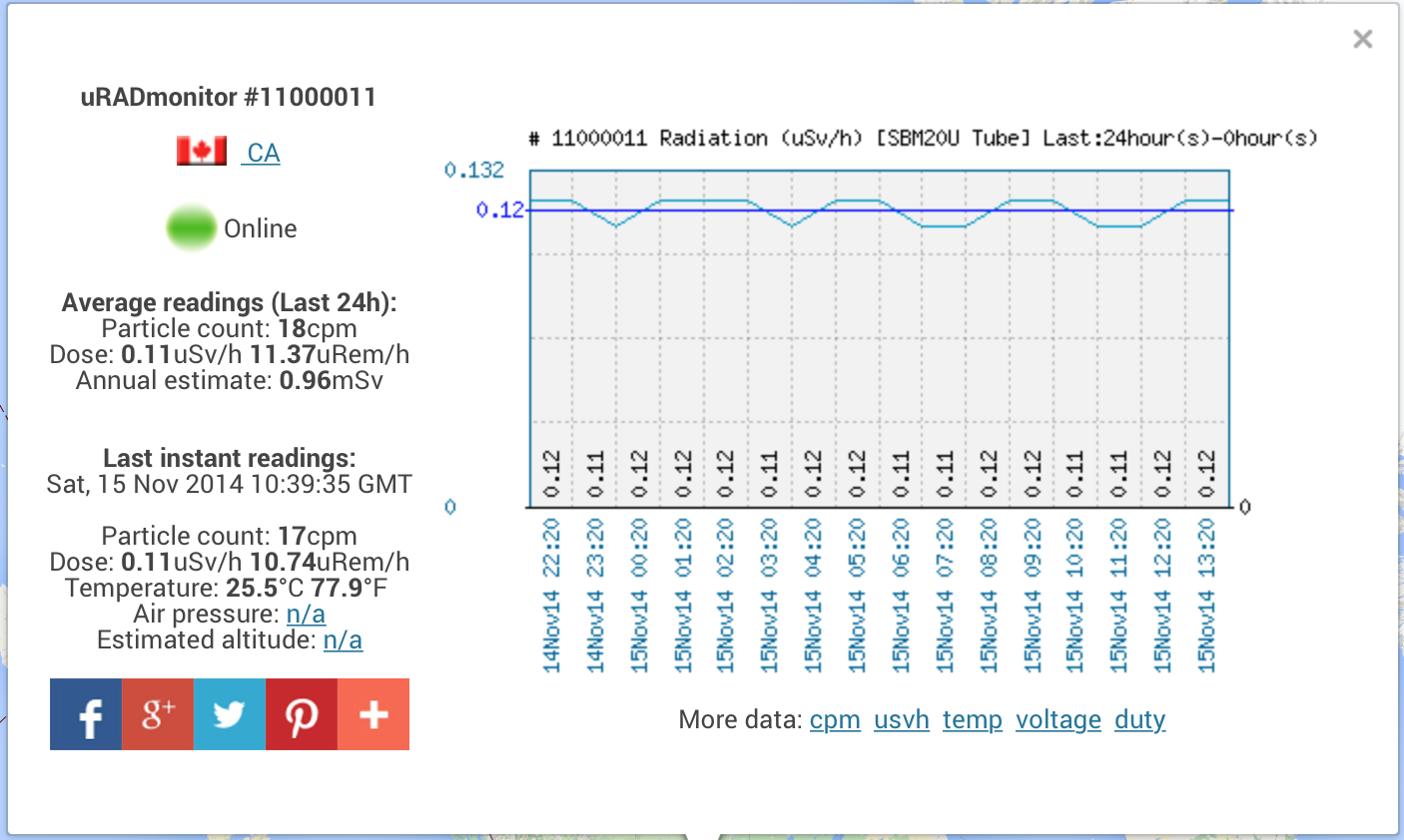

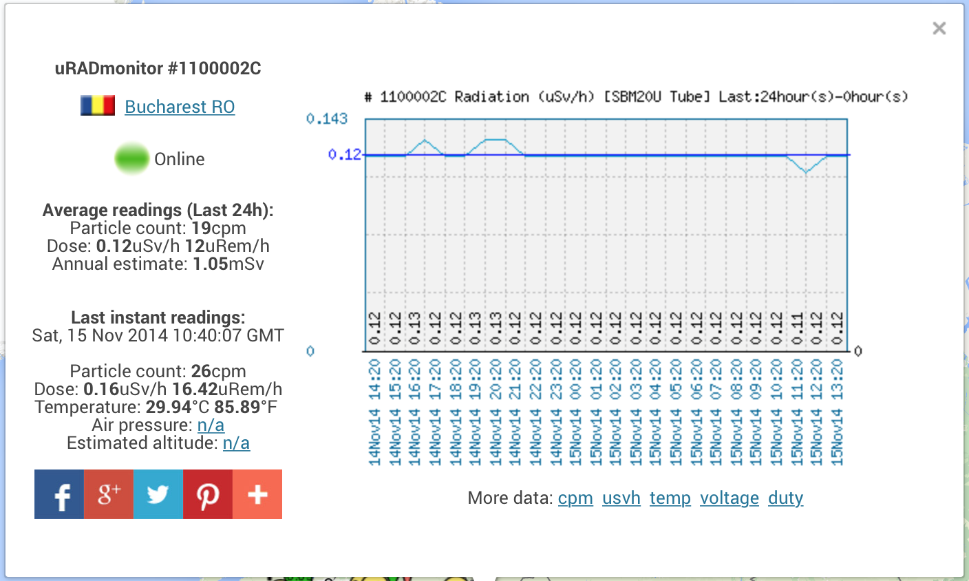

Almost each day a new station goes online in an arbitrary location on the radiation map. The new station in Bucharest is the first of its kind right in Romania's capital city, while the one in Calgary, is the first uRADMonitor unit in Canada.
For now both are indicating normal readings and let's hope they will always will.
![11000011]()
Detailed measurements can be accessed on the radiation web portal.
