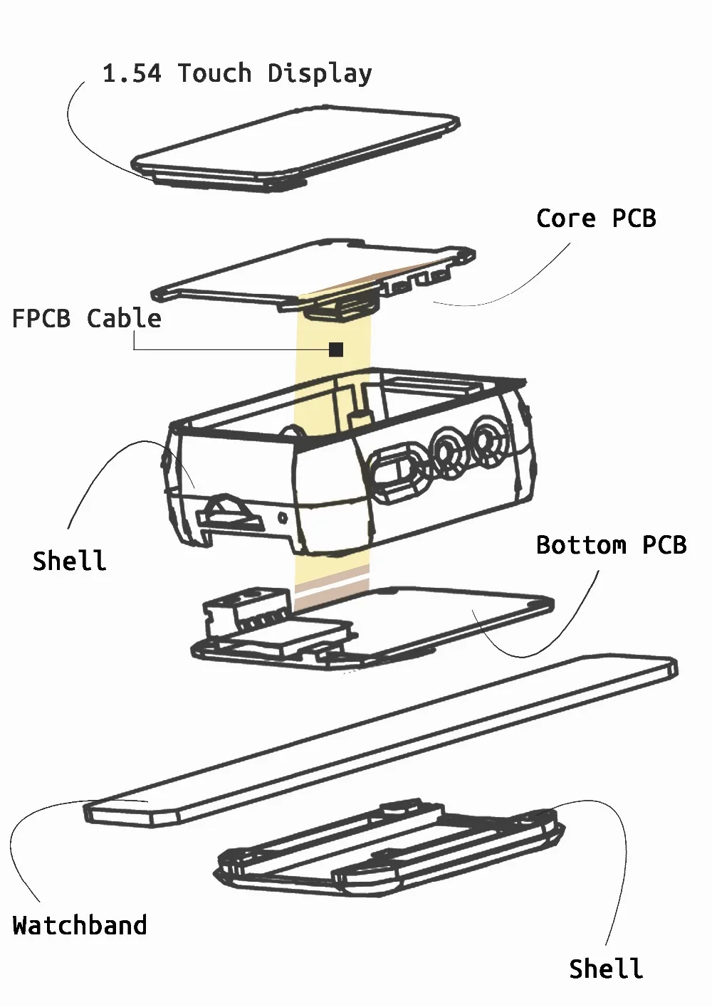

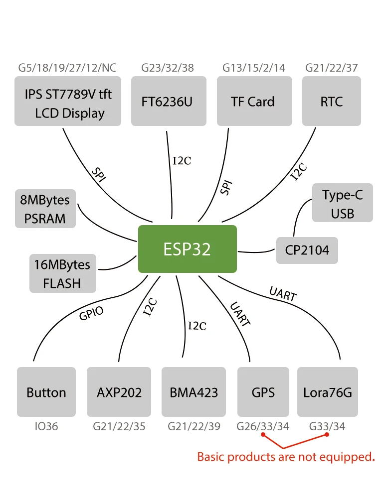

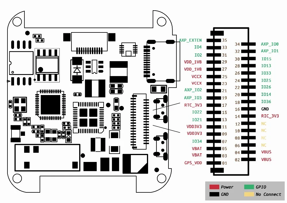

| TTGO T-Watch Programmable And Networked Open Source Smart Watch That Interacts With The Environment As A Wearable Device |
VIDEO:
Product Features
- Main chip: ESP32, dual core MCU (integrated dual mode Bluetooth/wifi), PMU power management
- Display: 1.54 inch LCD capacitive touch screen
- Sensor: BMA423 three-axis accelerometer, built-in step counting algorithm, activity recognition / tracking, advanced gesture recognition, etc.
- GPS module: Quickly locate the current position using the Sony CXD5603GF module
- Lora module: a new generation of popular wireless communication technology
- Combination kit: lithium battery, design open mold, and thick strap, and black and white
- Development platform: ESP-IDF (native SDK), Arduino, Lua, MicroPython, Scratch
| Hardware Specifications | |
| Chipset | ESP32, dual-core MCU, PMU power management |
| FLASH | QSPI flash 16MB / PSRAM 8MB |
| SRAM | 520 kB SRAM |
| Button | power key , IO36 |
| Extended function | |
| USB to TTL | CP2104 |
| Modular interface | UART、SPI、SDIO、I2C、LED PWM , PWM、I2S、IRGPIO、capacitor touch sensor、ADC、DACLNA |
| On-board clock | 40MHz crystal oscillator |
| Working voltage | 2.7V-3.6V |
| Working current | about 70mA |
| Sleep current | about 3mA |
| Working temperature range | -40℃ ~ +85℃ |
| Size&Weight | 46.47*43*20.4mm 43.19g |
| Display: | 1.54 inch LCD capacitive touch screen |
| Sensor: | BMA423 three-axis accelerometer, built-in step counting algorithm, activity recognition / tracking, advanced gesture recognition. |
| RTC clock : | PCF8563 |
| Power Supply Specifications | |
| Power Supply | USB 5V/1A |
| Charging current | 500mA |
| Battery | 3.7V lithium battery |
| Wi-Fi | |
| Standard | FCC/CE-RED/IC/TELEC/KCC/SRRC/NCC |
| Protocol | 802.11 b/g/n(802.11n,speed up to150Mbps)A-MPDU and A-MSDU polymerization,support 0.4μS Protection interval |
| Frequency range | 2.4GHz~2.5GHz(2400M~2483.5M) |
| Transmit Power | 22dBm |
| Communication distance | 300m |
| Bluetooth | |
| Protocol | meet bluetooth v4.2BR/EDR and BLE standard |
| Radio frequency | with -97dBm sensitivity NZIF receiver Class-1,Class-2&Class-3 emitter AFH |
| Audio frequency | CVSD&SBC audio frequency |
| Software specification | |
| Wi-Fi Mode | Station/SoftAP/SoftAP+Station/P2P |
| Security mechanism | WPA/WPA2/WPA2-Enterprise/WPS |
| Encryption Type | AES/RSA/ECC/SHA |
| Firmware upgrade | UART download/OTA(>span class="font5">) |
| Software Development | Support cloud server development /SDK for user firmware development |
| Networking protocol | IPv4、IPv6、SSL、TCP/UDP/HTTP/FTP/MQTT |
| User Configuration | AT + Instruction set, cloud server, android/iOSapp |
| OS | FreeRTOS |
Appearance Specifications
T-Watch onboard:
1.54 inch LCD capacitive touch screen: ST7789V
Touch screen chip: FT5206
Three-axis accelerometer: BMA423
PMU power management: AXP202
RTC clock module: PCF8563
Expand the interface:
Support microphone: MSM261S4030H0
Support SPI TF memory card
2 digital I/Os: GPIO25, GPIO26 (supports ADC, DAC)
Support I2C, UART, SPI communication protocol
Appearance Specifications
T-Watch onboard:
1.54 inch LCD capacitive touch screen: ST7789V
Touch screen chip: FT5206
Three-axis accelerometer: BMA423
PMU power management: AXP202
RTC clock module: PCF8563
Expand the interface:
Support microphone: MSM261S4030H0
Support SPI TF memory card
2 digital I/Os: GPIO25, GPIO26 (supports ADC, DAC)
Support I2C, UART, SPI communication protocol
Component Layout
Product Pins
More Information:https://github.com/Xinyuan-LilyGO/TTGO-T-Watch
https://t-watch-document-en.readthedocs.io/en/latest/index.html
Product Details
Accelerometer
• Chip: BMA423
• Latest generation triaxial, low-g acceleration sensor from Bosch
• ultra-small
• digital interfaces
• 2 bit digital resolution and embedded intelligence,
• allows low-noise measurement of accelerations in 3 perpendicular and thus senses wrist
tilt, tab/double tab and enables plug...
LILYGO
Doctor Volt
Manuel Alfonso
Max.K
Are sensors schematics available somewhere?
