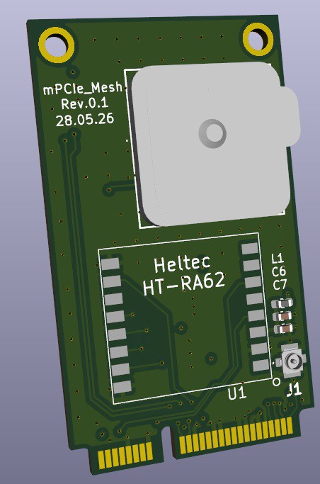

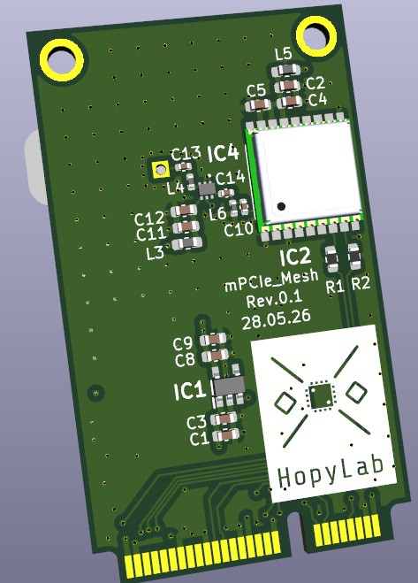

    The natural question when you have a DevPocket in your pocket is: can it become a Meshtastic node? The answer is yes — with a dedicated mPCIe module.
    Module Overview
    The Meshtastic mPCIe module adds two things to DevPocket: a LoRa radio for mesh communication and a GNSS receiver for GPS position reporting. Both are well-proven, compact components that fit within the mPCIe full-size form factor.
    (Screenshot: Meshtastic mPCIe module(TOP))
    (Screenshot: Meshtastic mPCIe module(BOT))

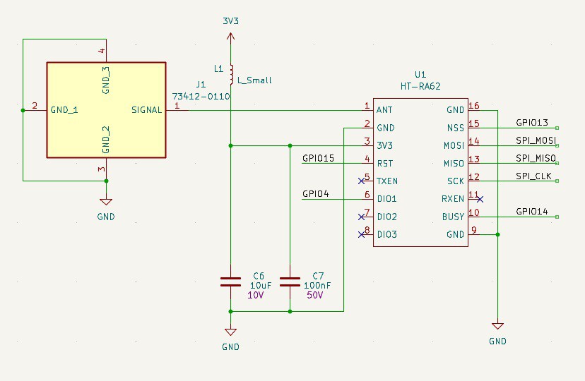

    RF Side — HT-RA62 (SX1262)
    The LoRa radio is the Heltec HT-RA62 — a stamp-hole module built around the Semtech SX1262 chip. Key specs:
    ParameterValue
    ChipsetSX1262
    Frequency863–928 MHz (868 MHz EU / 915 MHz US)
    Max TX power+22 dBm
    Receive sensitivitydown to –139 dBm
    InterfaceSPI
    Dimensions16 × 17 × 0.8 mm
    The SX1262 communicates with the ESP32 via SPI (SCK, MOSI, MISO, NSS) with additional control lines: TXEN, RXEN for TX/RX switching, BUSY for ready signalling, and DIO1 for interrupt-driven packet reception. The antenna port is an IPEX MHF1 coaxial connector (J2, 208890-0001) with a small matching network (L6 6.8nH, C10/C14 8.2pF) on the RF output.
    (Screenshot: schematic HT-RA62)

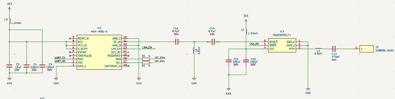

    GPS Side — u-blox MAX-M8Q + MAX2659 LNA
    The GNSS receiver is the u-blox MAX-M8Q — a compact chip-size module (9.7 × 10.1 mm) with a TCXO for improved cold-start performance. It supports concurrent reception of GPS, GLONASS, Galileo, and BeiDou with a navigation sensitivity of –167 dBm and a horizontal position accuracy of 2.5m CEP.
    ParameterValue
    Engineu-blox M8
    GNSS systemsGPS, GLONASS, Galileo, BeiDou (3 concurrent)
    Navigation sensitivity–167 dBm
    Position accuracy2.5 m CEP
    Update rateup to 10 Hz (GPS + GLONASS)
    InterfaceUART + I2C
    Supply voltage2.7–3.6V
    The MAX-M8Q connects to the ESP32 via UART1 (TXD/RXD) and also exposes an I2C interface (SDA/SCL via R1/R2 0Ω solder-select jumpers). A TIMEPULSE output is available for precise timing applications.
    To improve sensitivity with a passive antenna, the module includes a Maxim MAX2659ELT+ GPS LNA. The LNA sits between the antenna connector (J1, coaxial) and the MAX-M8Q RF input, and is controlled by the LNA_EN signal from the ESP32. The matching network on the LNA input uses L4 (6.8nH) and C14 (8.2pF) for 1575 MHz GPS band impedance matching.
    (Screenshot: schematic u-blox MAX-M8Q)
