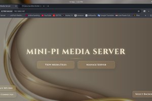

3. Hardware for Media Server
- ELB-REV4 iSCADA
- 16GB (or greater) micro SD Card class 10 (or faster) (and a card reader, duh)
- Power bank (5.0 volt)
- External USB Hard Drive (the bigger the better) with an external power.
4. Software Configuration and Testing
sudo apt-get update
sudo apt-get upgrade
With this done, reboot the pi using;
sudo reboot
Step 2: Static IP Address
sudo hostname -I
This will display the current IP address. Copy and keep safe.
sudo nano /boot/cmdline.txt
Add the below line at the end of the file, replace "IP_ADDRESS" with your IP address"
ip=IP_ADDRESS
Reboot the raspberry pi to effect changes.
sudo reboot.
step 3: Install HTTPS transport package
Install (or confirm that it already installed) the HTTPS transport. This though comes with newer version of the raspbian and its needed to be able to access the https packages via apt-get.
sudo apt-get install apt-transport-https
Step 4: Get the dev2day repository
The next thing need to do is get the dev2day repository (A project documentation on plex) which contains Plex but to do this we need a crypt O key for the dev2day website.
To get the crypt O key;
wget -O – https://dev2day.de/pms/dev2day-pms.gpg.key | sudo apt-key add -
echo “deb https://dev2day.de/pms/ jessie main ” | sudo tee /etc/apt/sources.list.d/pms.list
It will just return a line with the echoed input.
Finally, update the package list using;
sudo apt-get update
Reboot the pi and move on to the next step when it comes back on.
sudo reboot
Step 5: Install Plex Media Server
sudo apt-get install -t jessie plexmediaserver
Step 6: Setup Plex to run on the ‘Pi’ user
Setup Plex to run on the ‘Pi’ user with which we are logged in. To do this edit the plexmediaserver.prev file and change the user from plex to pi. To do this we use
sudo nano /etc/default/plexmediaserver.prev
This will open up a text file.
PLEX_MEDIA_SERVER_USER=plex
Change it so it becomes;
PLEX_MEDIA_SERVER_USER=pi.
Save the text file as usual and exit using CTRL+X and then y.
Restart plex server to effect changes using;
sudo service plexmediaserver restart
with this done, reboot pi once again that effect the final...
