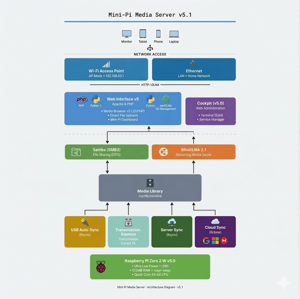

1. Core Media & Download Engine
  • Universal Streaming: Powered by a tuned MiniDLNA setup, streaming music, photos, and video up to 1080p HD to Smart TVs, game consoles, and mobile devices. Designed for smooth playback on low-power hardware rather than high-bitrate 4K streaming. Streaming Via Web browser too.
  • Integrated Downloads: Optional Transmission support allows direct downloads into the media library with seeding-aware handling.
  • Unified Storage: A consistent directory structure keeps DLNA, Samba, and the Web UI fully synchronised with no broken paths or mismatched views.

  • Smart MKV Watcher: systemd + inotify service automatically detects new MKV or VOB files and triggers encoding immediately
  • Hardware Encoding: H.264 streams are remuxed instantly (no quality loss). HEVC and other formats are transcoded using the Pi Zero 2 W VideoCore GPU, with fallback to software encoding on Pi 5
  • Power-Loss Recovery: incomplete encodes are automatically cleaned up on reboot and resumed safely
  • USB Auto-Sync: plugging in a USB drive with standard media folders automatically syncs content into the library via rsync
  • Nightly Rotational Sync: optionally pulls only recent media from a NAS, keeping storage use low on SD cards

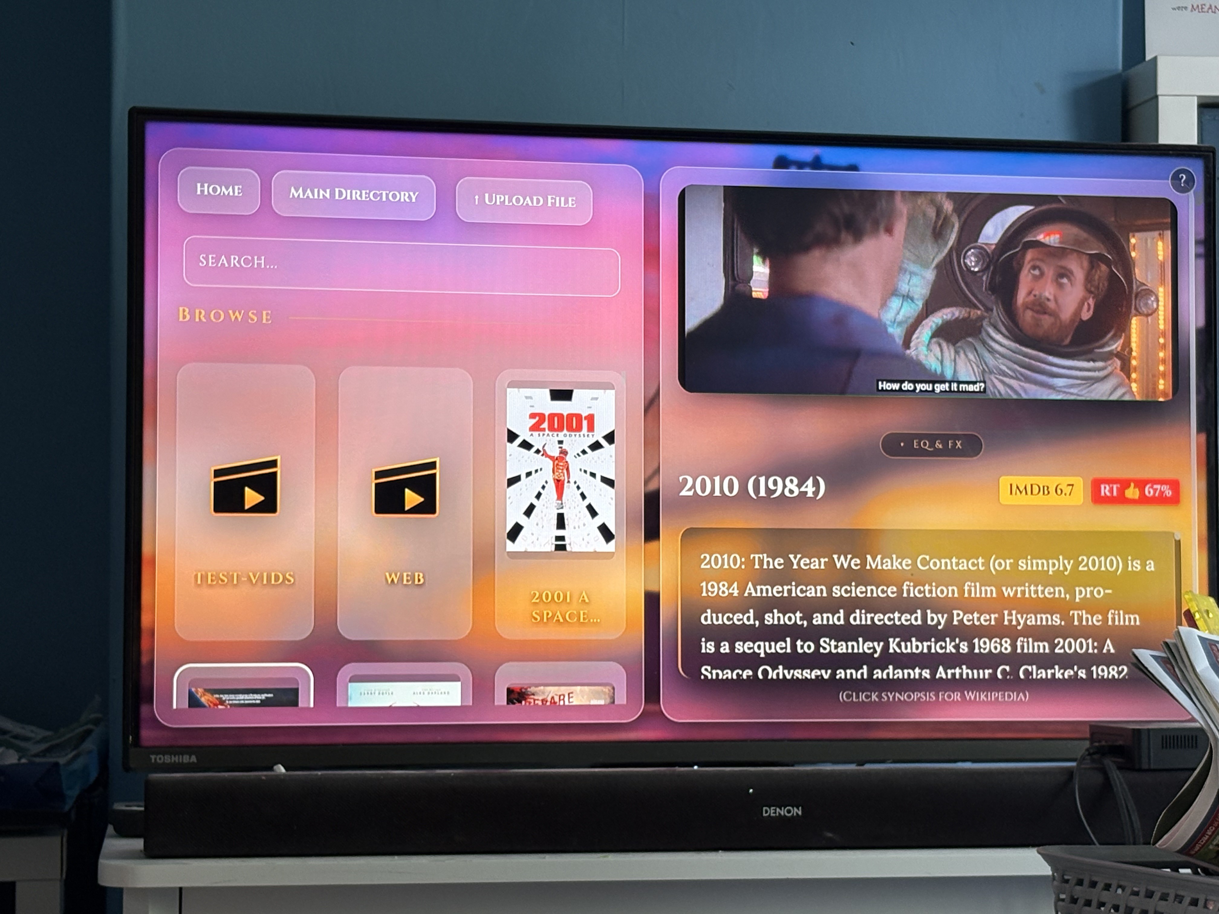

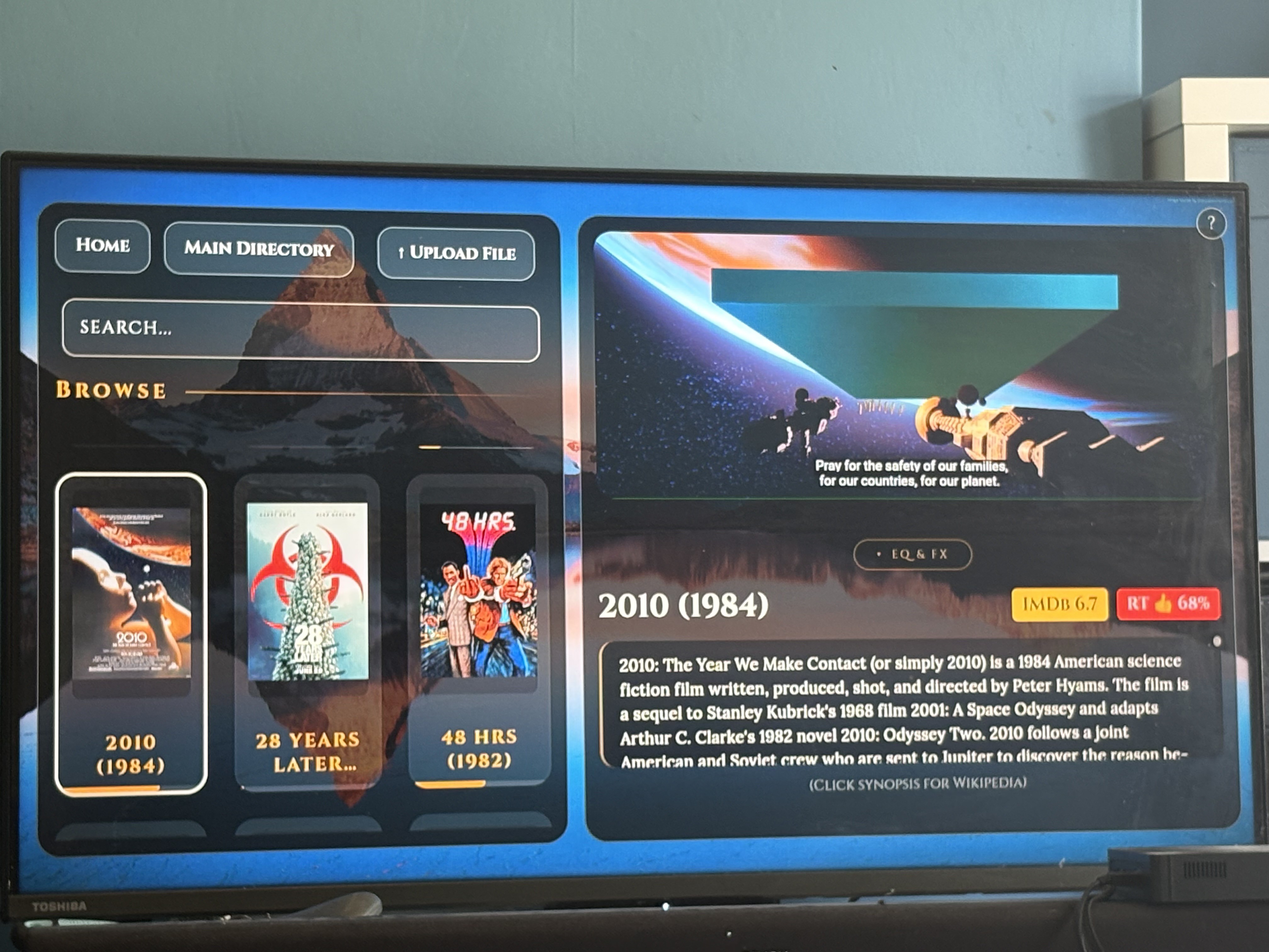

4. Web Interface & User Experience

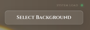

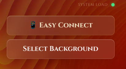

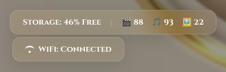

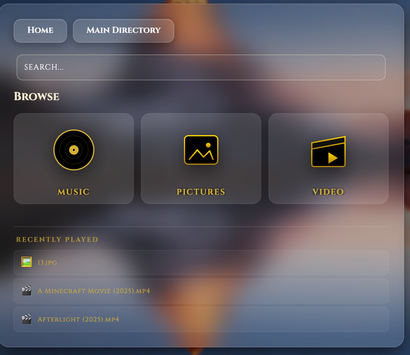

  • Customisable backgrounds (including user uploads via Samba), uses the Pictures folder.

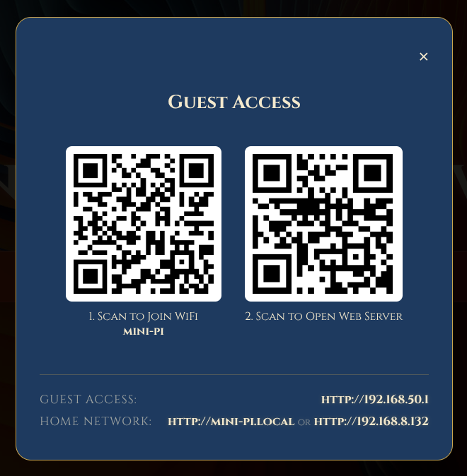

  • QR-code onboarding for instant device pairing and WiFi setup

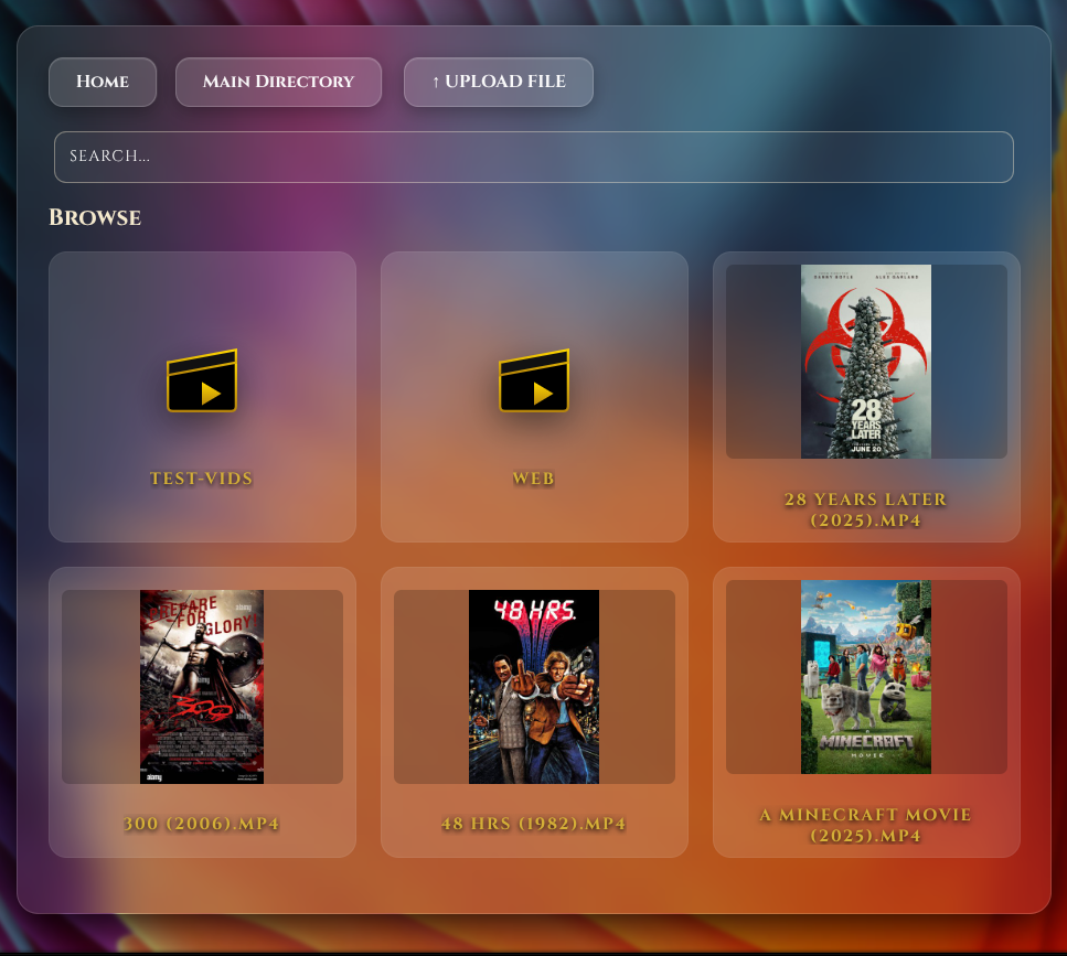

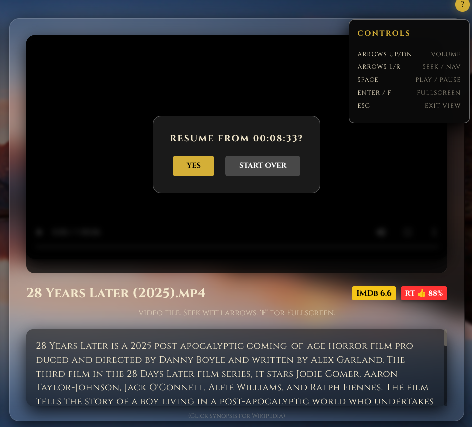

  • Rich media library UI with posters, synopses, IMDb ratings, and Rotten Tomatoes scores via nightly metadata scraping
  • Cross-device resume playback (TV → tablet → phone)
  • Lock-screen music controls for high-fidelity playback
  • Direct uploads from any device into Music, Pictures, or Video folders
  • Client-side EQ and audio effects (zero CPU load on the Pi)
5. Networking & Deployment
  • WiFi Access Point Mode: creates a standalone wireless network for fully self-contained deployments, routing internet via Ethernet when available (with a USB to ethernet adapter on a pi zero 2 w)

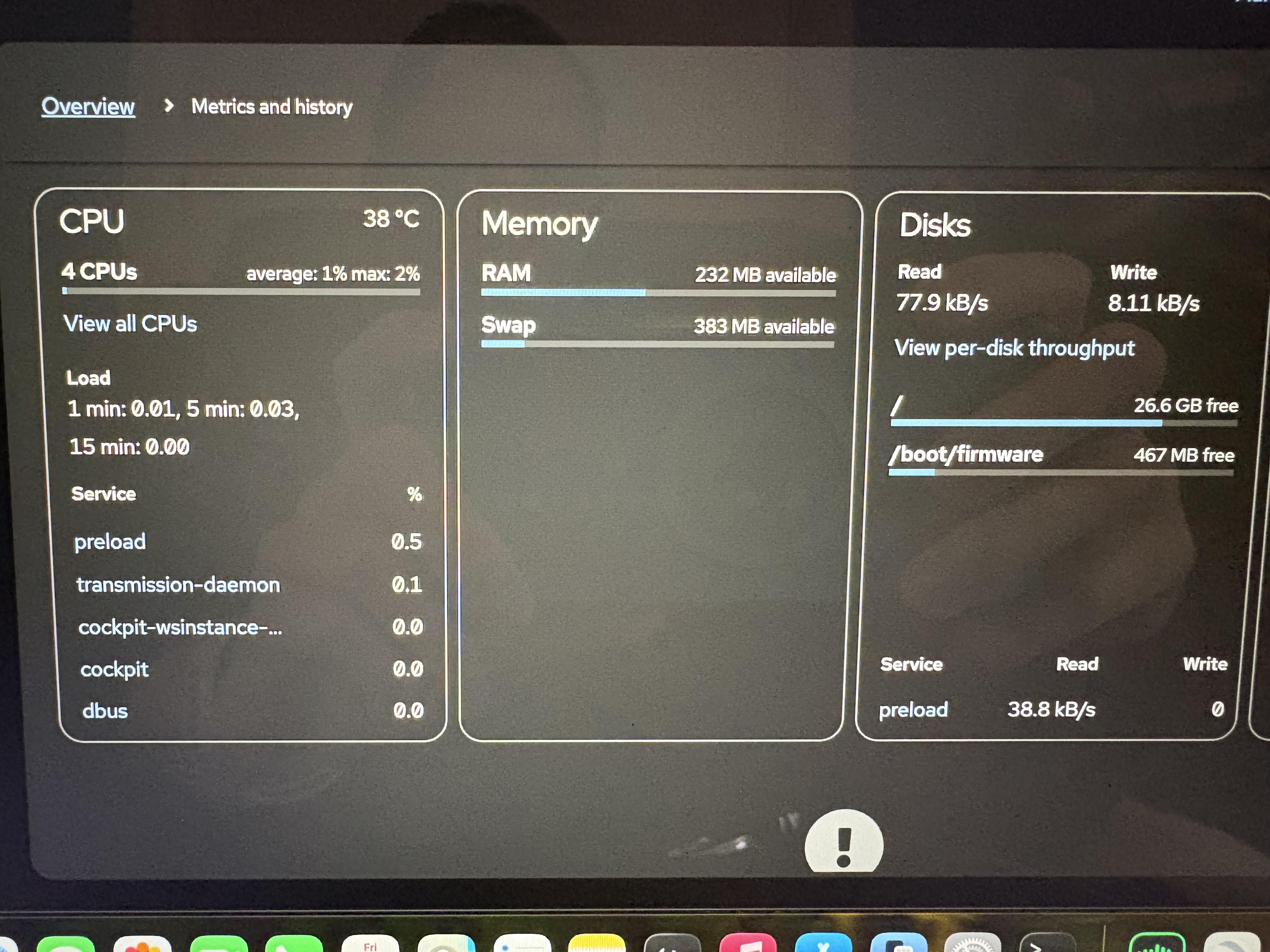

  • Cockpit Management: full web-based admin interface including terminal, file system access, and service control without SSH
  • One-command install & upgrade: preserves all existing configuration and user data during updates

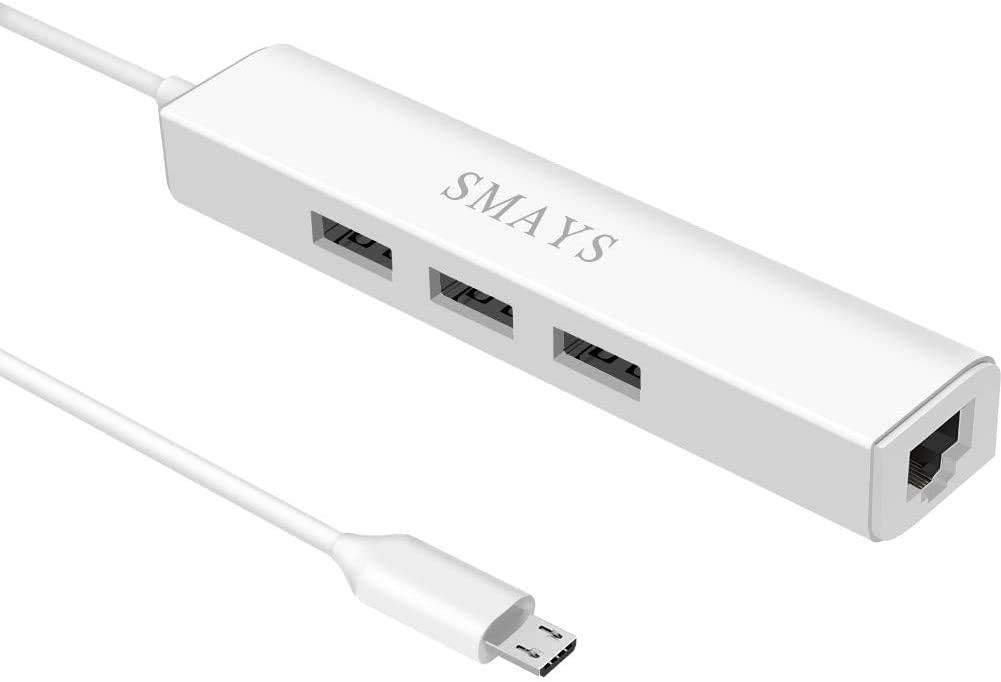

  • 1 × Micro Usb to Ethernet Lan Adapter With 3 USB Ports for Raspberry Pi Zero - White USB to Ethernet with 3x usb ports. Can be purchased from amazon for around £15

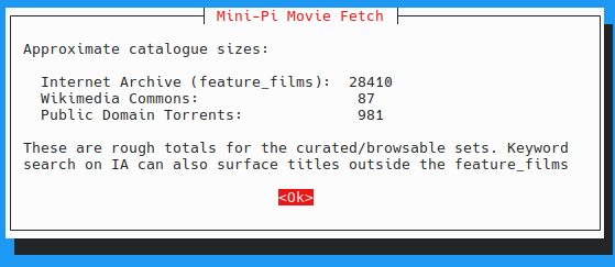

    v7.5 Release Notes
    Version 7.5 brings legal public-domain movie downloading directly into the Mini-Pi Media Server. Browse over 20,000 classic films from the Internet Archive, Wikimedia Commons and Public Domain Torrents, then download them directly into your media library with a simple menu interface.
    Fixed: Full screen keyboard controls losing focus Seek and pause via keyboard were solid in windowed mode but would lose focus in full screen, meaning key presses stopped registering until you clicked back into the player. Both modes now handle keyboard seek and pause reliably, windowed and full screen alike.
    New: Archive Movie Downloader Added a new menu option, surfaced to the user at the end of setup, for pulling legal public-domain feature films straight into the media library. It searches Internet Archive, Wikimedia Commons, and Public Domain Torrents together from a single dialog UI — search by title/keyword/actor, browse by decade, or browse by genre. Internet Archive and Wikimedia results download immediately with a live progress gauge (percent, speed, size); Public Domain Torrents results get handed off to Transmission and queued in the background since those can take a while depending on seeders. Results are ranked and sorted by file size regardless of source, so the biggest (usually best quality) versions surface first.
    to run the archive movie downloader, ssh into the pi or use cockpit and open the terminal view.
    Then cd ./pi-setup
    then ./archive-movie-downloader.sh
    You can download / upgrade the mini-pi media server by running the following on the Raspberry Pi (either SSH into the Pi or on the actual Pi) :-
    wget -qO- https://raw.githubusercontent.com/diddy-boy/mini-pi-media-server/main/install.sh | bash

    • Reduced idle RAM usage from ~220 MB → ~154 MB on Raspberry Pi Zero 2 W
    • Optimised Apache configuration for lower baseline memory footprint
    • Tuned Samba configuration to reduce background resource usage

    • Cross-Device Watch Resume: Watch positions are now saved server-side on your Pi, allowing seamless switching between your phone, laptop, and TV.
    • Ground-Up Subtitle Engine Rewrite: Replaced dead dependencies with direct OpenSubtitles REST API integration, complete with smart backlog queueing to respect daily free quotas. NOTE: You will need an account for subtitles to download for Opensubtitles.org.
    • Modular Pipeline Refactor: Split the monolithic mkv-2-mp4.sh script into 4 highly focused, specialised scripts managed by a central orchestrator.
    • Bulletproof Concurrency: Upgraded to atomic mkdir locking to entirely eliminate race conditions when multiple files finish processing at once.
    • Advanced Filename Robustness: Transitioned to null-delimited processing and proper array handling to natively support spaces and special characters.
    • Deep Systemd Logging: Exposed comprehensive processing metrics—including codecs, bitrates, hardware encoders, and full ffmpeg outputs—directly to the systemd journal.
    📺 Watch Resume Across Devices via the web browser
    Your watch position is now saved back to the server as you stream, rather than being stored locally in the browser.
    • Start watching on your phone, continue from the same point on your TV or laptop.
    • Works across any device on your home network without any setup.
    • Falls back to local browser storage automatically if the server is unreachable.
    • No accounts, no cloud — everything stays local on your Pi.

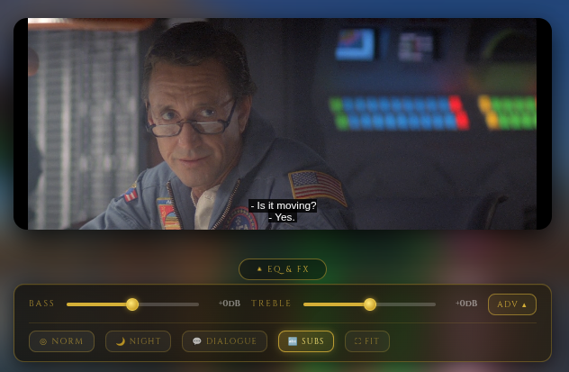

    Added .vtt subtitle support in a web browser for media files - now web viewing users can have English subtitles whilst watching media. Only English subtitles at this time.
    Dependant upon the DLNA client (Smart TV), .srt subtitles can be viewed across the network whilst watching media locally via dlna.
    Scraper now pulls down .srt subtitles for media if there is no present .srt file at 5am scan, as well as movie art, movie synopsis, IMDB rating and Rotten Tomato score.
    All .srt files and .vtt files are named the same as the media file.
    mkv-2-mp4 conversion now promotes not just the mkv file but also the .srt subtitle file from transmission directories and re-encode mkv to mp4 and also convert .srt to .vtt subtitles as well. keeping the .srt file.
    So each 'media file' will have a .mkv that gets converted to .mp4, .srt and end up with a .vtt file generated from the .srt file.
    Mkv-Watcher now logs less but more relevant info into the system log for the systemd service.
    Added screen aspect ratio for viewing media. this is remembered by the web browser
    Fixed upload file button with a progress bar popup when adding a new media file

    Configure WiFi as an access point (if you run this then an ethernet connection has to be used to stream at home).
    you can at any time in the future, run ./reconfigure-wifi.sh from within the mini-pi directory.
