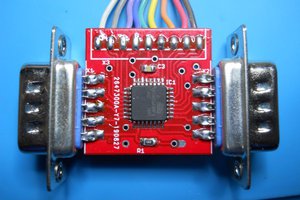

This project lets you play MSX games using Nintendo 64 controllers. The several N64 controller buttons are mapped on a variety of combinations for the MSX and the analog stick can act both as directional controls and as standard Paddles.
Nintendo 64 controller is read by NicoHood's Nintendo library and the buttons are converted to MSX equivalents according to the table below.
Analog stick is mapped to MSX controllers using a paddle emulation function that responds to an interrupt that is generated by a rising edge on pin 8 (pulse) of joystick port.
The tricky part of this project is that Nintendo64 reading library has a time critical portion that takes about 157us with interrupts disabled, then if a paddle reading pulse arrives while the AVR is sampling the N64 controller, the interrupt service routine will be neld by up to 157us, which correscorresponds to 8 out of 255 counting loops performed by MSX to read the paddles. Too much time!

  • 1 × Arduino Nano
  • 1 × Sega Megadrive extension cord
  • 1 × Nintendo 64 extension cord
  • 1 × 560 Ohms resistor
