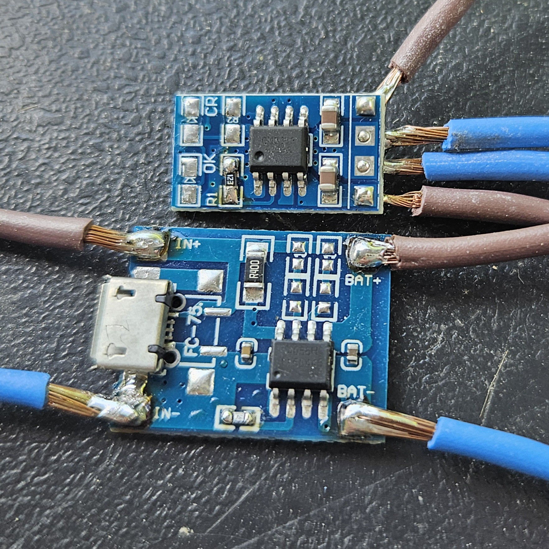

I have tested a couple cheap USB linear li-ion chargers and connected them to a solar panel
In the past I have compared a linear (MCP73831) with a couple switched mode (LT3652, BQ24650, CN3722) Li-Ion battery chargers, powered from solar panels, and found linear chargers actually don't perform so bad. Andreas Spiess concluded the same in this video. When the panel voltage (~5-6V) is matched to the battery (~3.7V) the losses should not be so bad. Switched mode chargers price is about 10x, so if more power is needed it is cheaper to buy a larger solar panel than a switch mode charger.
I really hoped the input under voltage lockout voltage of these chargers (~3.5V) could be matched to the maximum power point voltage of the solar panel, just like in the expensive switch mode chargers that have maximum power point control. I ordered below boards from aliexpress and put them to the test. All chargers are cheap and intended for USB or wall adapter.

I had some old TP4056E and some newer TC4056A, I don't know there difference. There must be several manufacturers of the same chip and TP-ASIC is the original manufacturer
The input voltage range of the MCP7383x is limited to max 6V and so I decided to buy 5V solar panels. A 5V panel would also fit nicely with the 3.5V under voltage lockout voltage level, because that is near to the maximum power voltage of the solar panel. To make a fair comparison I have limited charge current to 500mA on all boards.

Then I have measured charger input voltage and current, and output voltage and current as shown in the measurement . I have tested with above two solar panels, and two Li-ion batteries charged to different levels.

Below is the table for the larger solar panel and the lower battery voltage (~3.67V)
Charge current is a lot less than the programmed 500mA. Input voltage is still pretty high. And overall efficiency is poor (70%) due to the large voltage difference between input and output. There is no clear winner.
Below is the table for the smaller solar panel and the lower battery voltage (~3.67V)
Charge current is not so much worse compared to the larger panel. 4056E is the winner. MCP73833 somehow performed really bad.
Below is the table for the larger solar panel and the higher battery voltage (~3.96V)
The charge current is much lower now, also input voltage is so much higher now. The MCP73831 is the loser.
Finally I tested the smaller solar panel with the higher battery voltage (~3.96V).
The results with the smaller solar panel is not different from the larger panel. Apparently it is mainly dependent on battery voltage. The MCP73831 is the loser.
