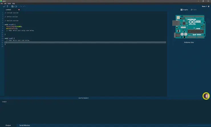

4Add Servo Motor Component
!["Add Component Button"]()
#1 Click '+' (Add Component Button) to search and select the component.

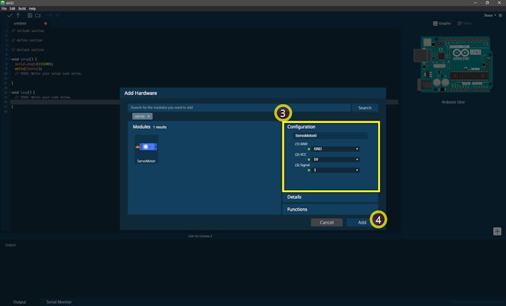

7Pin Indication and Configuration
![Pin Indication and Configuration]()
#4 then you can see ③ pin indication. (You can configure it.)
#5 ④ click ADD button

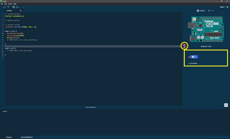

8Added Module
![Added Module]()
#6 ⑤Added Module has appeared on right pane of the editor page.

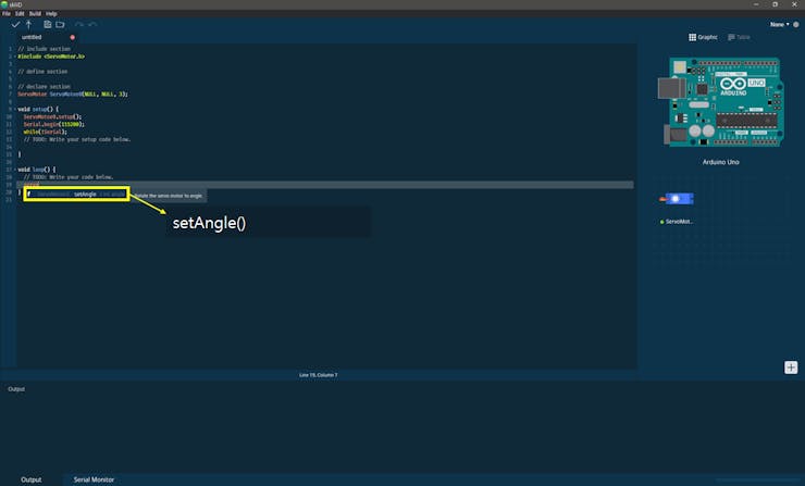

9One Function of Servo Motor
![A function of Servo Motor]()
setAngle() - Rotate the servo motor according to angle typed
