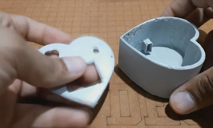

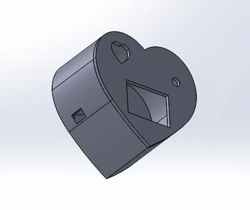

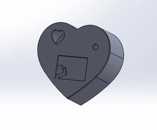

Starting with the 3D printed box parts, I made the above design using solidworks software and you can get the STL files from the download link, this design is 100% recommended to help you making your device since it fits the exact placement for the sensor and the OLED display.
After preparing the design I have got my parts very well manufactured and ready for the action. and as you can see in the last photo we prepared the Power connector placement on the box side.
