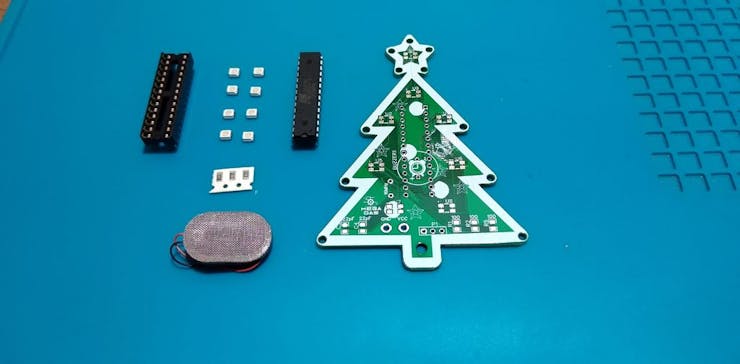

After making the circuit design I transformed the circuit into a customized PCB design with a tree shape in order to get a beautiful PCB design when we order our circuit and to do so all what I need is to move toJLCPCBthe best PCB supplier in order to get the best PCB manufacturing service, as always just some simple clicks that’s all what you need to uploaded the appropriate GERBER files of the circuit design then I moved to set some parameters and this time we will use the green color for this PCB since we are producing a tree so it should be green anyway; just four days after placing the order and my PCBs are on my desktop.
Related download files
As you can see in the pictures above the PCB is very well manufactured and I’ve got the same PCB design that we’ve made for our main board and all the labels,logos are there to guide me during the soldering steps. You can alsodownload the Gerberfile for this circuit.
