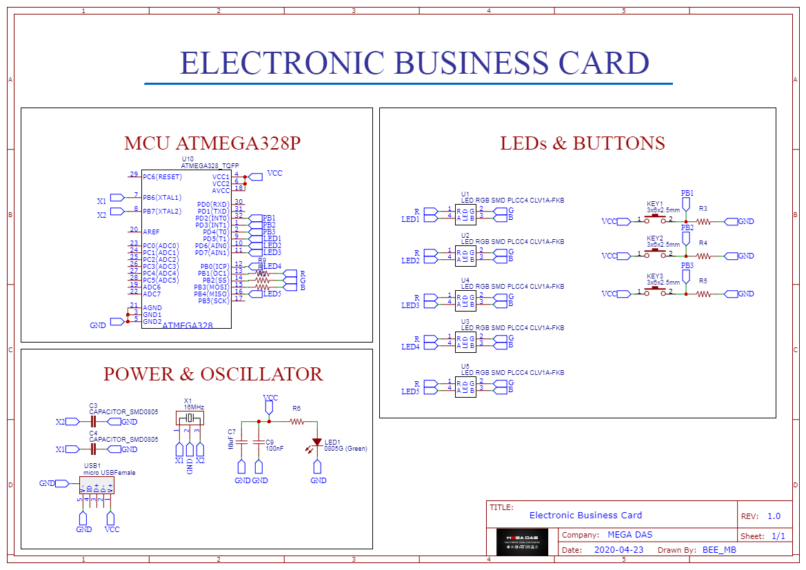

Step 1: Circuit Diagram
As always guys, I try all the time to pick up some good and easy electronics projects and the first step in our project is the Circuit Diagram that will be transformed to a PCB design.
In order to prepare the schematic I used EasyEDA design tool which is a super handy for both beginners and professional PCB designers, it has a built-in simulator for signal measurment and a very well developed library where you can find all the needed components for your circuit design with them appropriate footprint.

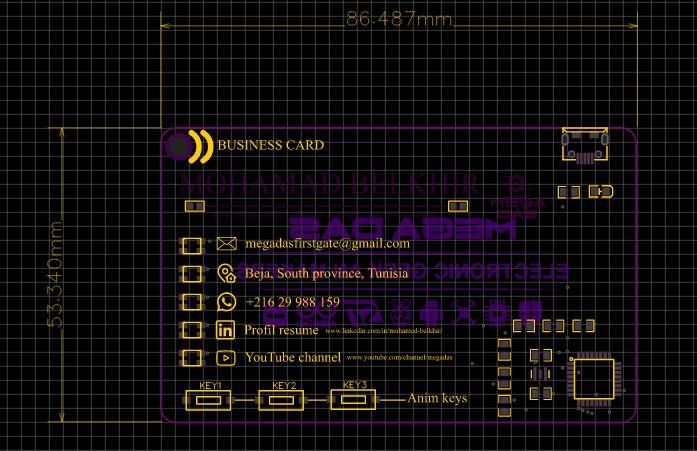

Our circuit is a basic one, it has a USB connector for power supply and a ATMega328 microcontroller where we will connect five RGB LEDs which are controlled by three push buttons, all the components here are SMD parts except the USB connector which is a through hole part.
Step 2: PCB Making
After tracing the tracks you will have the full schematic ready to be transformed into a PCB design.

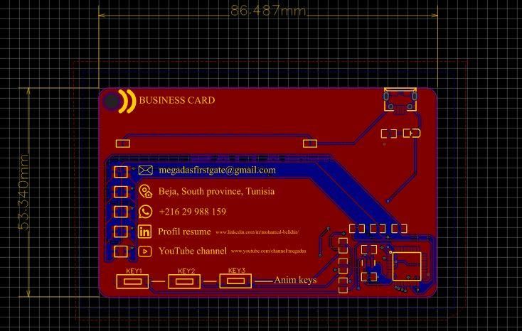

Just clicking on transforming to PCB design and all what we need now is setting the PCB outline to set the Business card size.

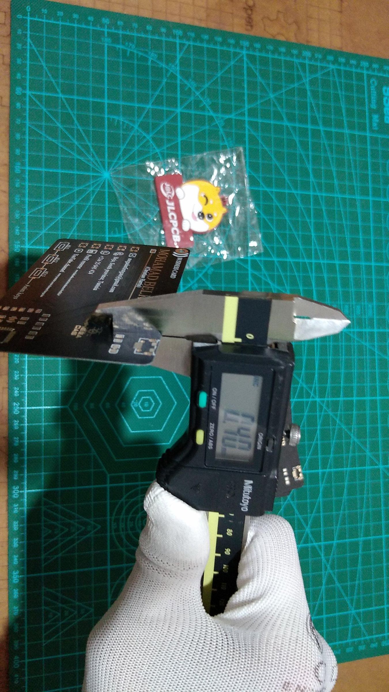

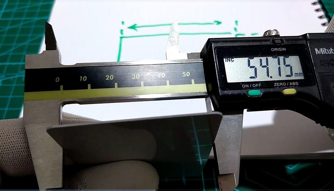

Size of the board is so important to fit in people pockets and wallets so I took the measurements of an existing badge which has the same standard dimensions of a business card 54.75mm x 85.50mm
then I get back to EasyEDA design tool to create the board outline that follows the measured dimensions.

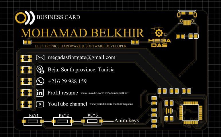

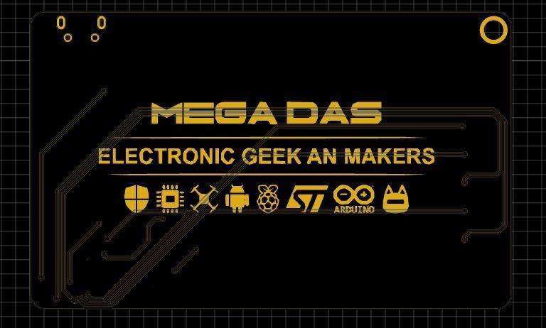

Now we drag and drop the components in the board layout and we start writing the personal information like the full name, the job, the address and contacts as silkscreen layer.
After adding some cool logos and icons the board is ready for routing and all what it takes is routing these components, in order to have my name written in golden finish material (ENIG) I set it as top solder mask layer but be careful while routing this board you should avoid the contact of two tracks of two different nets with the top solder mask pattern or it will be shorted.

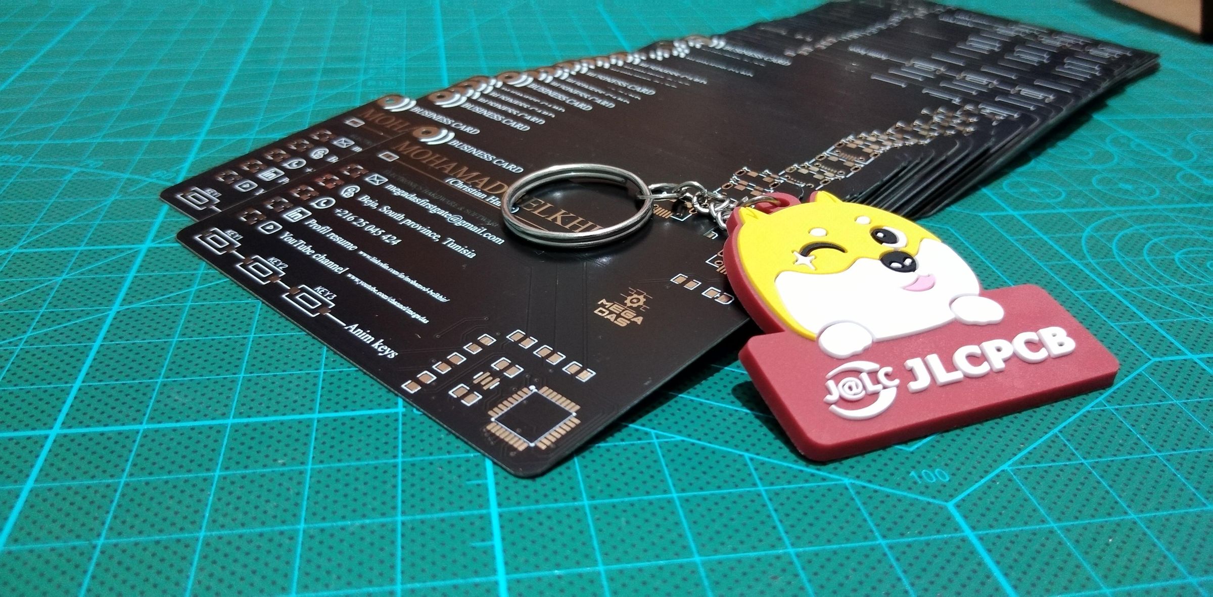

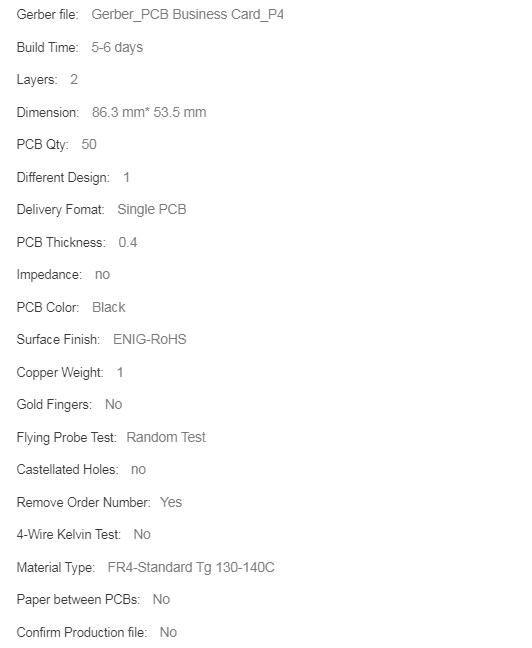

Now our design is ready for production so all what we need is generating the GERBER files and drop them to JLCPCB for ordering, just set some PCB production settings like the PCB color which is black or you can choose whatever available color you like and the ENIG surface finish to have the golden look and the PCB thickness is set to 0.4mm to give it the appearance of a real business card.
I ordered 50 pieces of this board as trial and I dropped it into production with some other PCB designs to get them all shipped in one order pack
Just four days to wait and I got my PCBs well...
