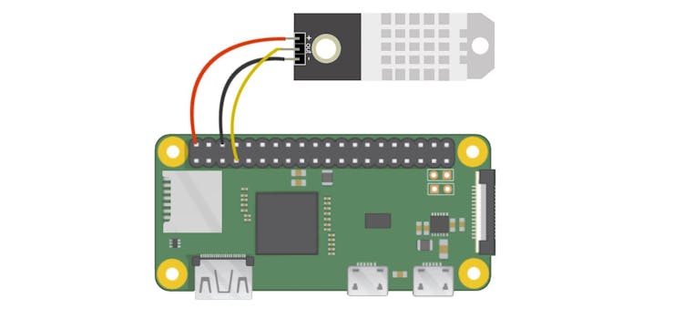

5DHT22 SolutionYou’ll need the following items to build this solution:
The DHT22 will have three pins — 5V, Gnd, and data. There should be a pin label for power on the DHT22 (e.g. ‘+’ or ‘5V’). Connect this to pin 2 (the top right pin, 5V) of the Pi. The Gnd pin will be labeled ‘-’ or ‘Gnd’ or something equivalent. Connect this to pin 6 Gnd (two pins below the 5V pin) on the Pi. The remaining pin on the DHT22 is the data pin and will be labeled ‘out’ or ‘s’ or ‘data’. Connect this to one of the GPIO pins on the Pi such as GPIO4 (pin 7). Once this is wired, power on your Pi.
Install the Adafruit DHT Python module at a command prompt to make reading DHT22 sensor data super easy:
$ sudo pip install Adafruit_DHT
With our operating system installed along with our two Python modules for reading sensor data and sending data to Initial State, we are ready to write our Python script. The following script will create/append to an Initial State data bucket, read the DHT22 sensor data, and send that data to a real-time dashboard. All you need to do is modify lines 6–11.
import Adafruit_DHT from ISStreamer.Streamer import Streamer import time # --------- User Settings --------- SENSOR_LOCATION_NAME = "Office" BUCKET_NAME = ":partly_sunny: Room Temperatures" BUCKET_KEY = "rt0129" ACCESS_KEY = "PLACE YOUR INITIAL STATE ACCESS KEY HERE" MINUTES_BETWEEN_READS = 10 METRIC_UNITS = False # --------------------------------- streamer = Streamer(bucket_name=BUCKET_NAME, bucket_key=BUCKET_KEY, access_key=ACCESS_KEY) while True: humidity, temp_c = Adafruit_DHT.read_retry(Adafruit_DHT.DHT22, 4) if METRIC_UNITS: streamer.log(SENSOR_LOCATION_NAME + " Temperature(C)", temp_c) else: temp_f = format(temp_c * 9.0 / 5.0 + 32.0, ".2f") streamer.log(SENSOR_LOCATION_NAME + " Temperature(F)", temp_f) humidity = format(humidity,".2f") streamer.log(SENSOR_LOCATION_NAME + " Humidity(%)", humidity) streamer.flush() time.sleep(60*MINUTES_BETWEEN_READS)
- Line 6 — This value should be unique for each node/temperature sensor. This could be your sensor node’s room name, physical location, unique identifier, or whatever. Just make sure it is unique for each node to ensure that the data from this node goes to its own data stream in your dashboard.
- Line 7 — This is the name of the data bucket. This can be changed at any time in the Initial State UI.
- Line 8 — This is your bucket key. It needs to be the same bucket key for every node you want displayed in the same dashboard.
- Line 9 — This is your Initial State account access key. Copy and paste this key from your Initial State account.
- Line 10 — This is the time between sensor reads. Change accordingly.
- Line 11 — You can specify metric or imperial units on line 11.
After you have set lines 6–11 in your Python script on your Pi Zero WH, save and exit the text editor. Run the script with the following command:
$ python tempsensor.py
Now you will have data sending to an Initial State dashboard. Go to the final section of this article for details on how to customize your dashboard.

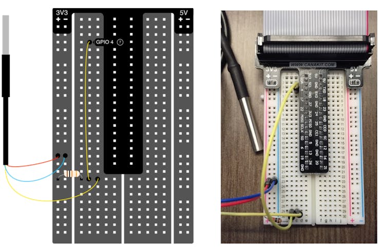

6DSB18B20 SolutionYou’ll need the following items to build this solution:
- DSB18B20 Temperature Sensor
- 10K Resistor-Breadboard
- 40-Pin Breakout Board + Ribbon Cable-Wires
The ribbon cable connects to the GPIO pins on the Pi. The DS18B20 has three wires. The red wire connects to 3.3V. The blue/black wire connects to ground. The yellow wire connects to a pull-up resistor/pin 4. Once this is wired up, power on your Pi.
The latest version of Raspbian (kernel 3.18) requires an addition to your /boot/config.txt file for the Pi to communicate with the DS18B20. Run the following to edit this file:
$ sudo nano /boot/config.txt
If the following line is not already in this file (if it is, it is likely at the bottom of the file), add it and save the file.
dtoverlay=w1-gpio,gpiopin=4
Restart your Pi for the changes to take effect.
$ sudo reboot
To start the temperature sensor read interface we need to run two commands. Go to a command prompt on your Pi or SSH into your Pi. Type the following commands:
$ sudo modprobe w1-gpio $ sudo modprobe w1-therm
The output of your temperature sensor is now being written to a file on your Pi. To find that file:
$ cd /sys/bus/w1/devices
In this directory, there will be a sub-directory that starts with “28-“. What comes after the “28-” is the serial number of your sensor. cd into that directory. Inside this directory, a file named w1_slave contains the output of your sensor. Use nano to view the contents of the file. Once you’ve entered into the file, it will look something like this:
a2 01 4b 46 7f ff 0e 10 d8 : crc=d8 YES a2 01 4b 46 7f ff 0e 10 d8 t=26125
The number after “t=” is the number we want. This is the temperature in 1/1000 degrees Celsius (in the example above, the temperature is 26.125 C). We just need a simple program that reads this file and parses out that number. We will get to that in just a second.

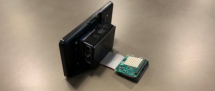

7Sense HATYou’ll need the following items to build this solution:
- Raspberry Pi Sense HAT
- 6" 40-Pin IDE Male to Female Extension Cable (optional for temperature accuracy)

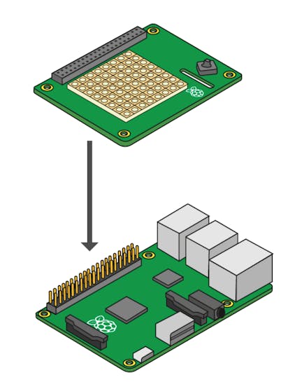

The first step in using the Sense HAT is to physically install it onto your Pi. With the Pi powered down, attached the HAT as shown below.
If you decide to use the solution as shown above you may notice that your Sense HAT’s temperature readings will be a bit high — that’s because they are. The culprit is the heat generated from the Pi’s CPU heating up the air around the Sense HAT when it is sitting on top of the Pi. To make the temperature sensor useful, we need to either get the HAT away from the Pi or try to calibrate the temperature sensor reading. A good solution for getting the sensor away from the Pi is a cable that lets the Sense HAT dangle away from the Pi. A 6", 40-pin IDE male to female extension cable cable will do the trick.
Once you decide on the two options, power on your Pi. We need to install the Python library to make it easy to read the sensor values from the Sense HAT. First, you will need to ensure that everything is up-to-date on your version of Raspbian:
