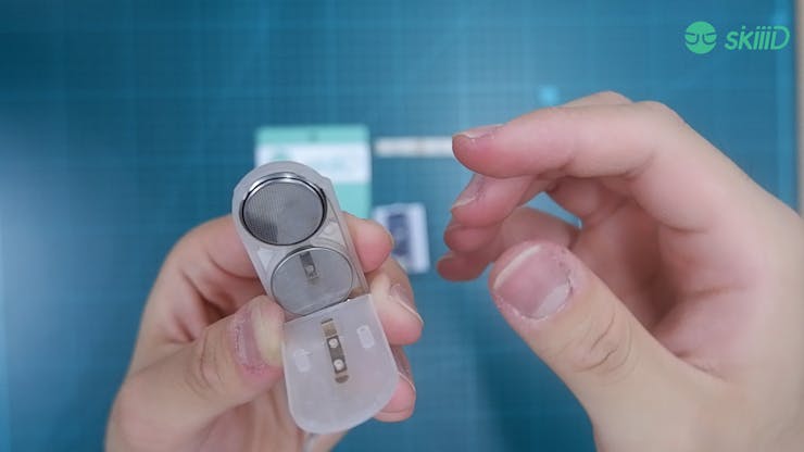

3Put CR2032 Batteries Securely
Let's put CR2032 Coin Batteries to Battery holder.

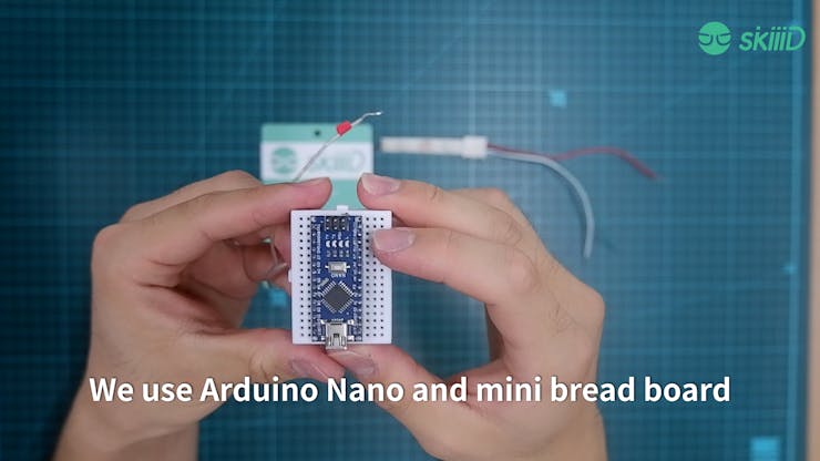

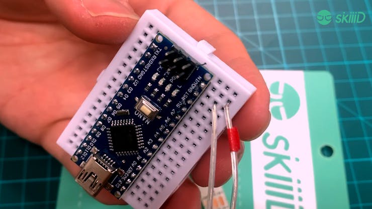

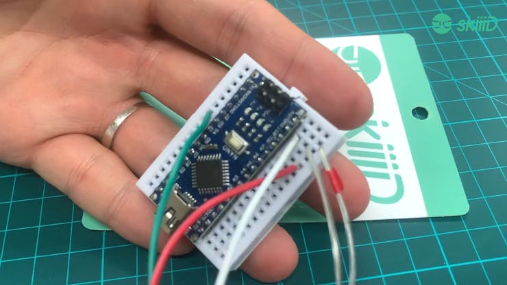

4Put Battery holder cable to Bread Board
Prepare Arduino Nano and Bread Board.
Put Battery holder's + cable to VIN
and - cable to GND

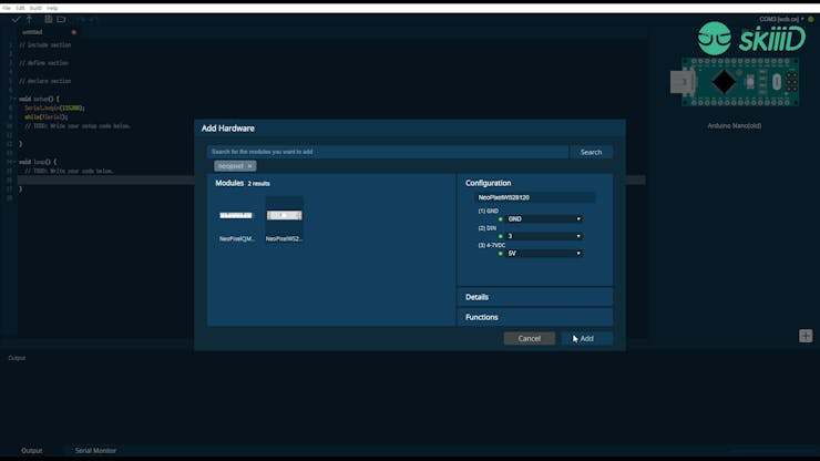

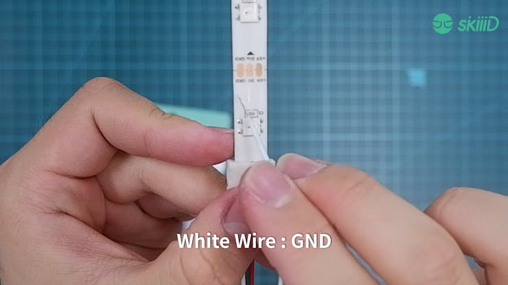

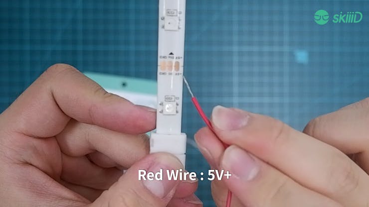

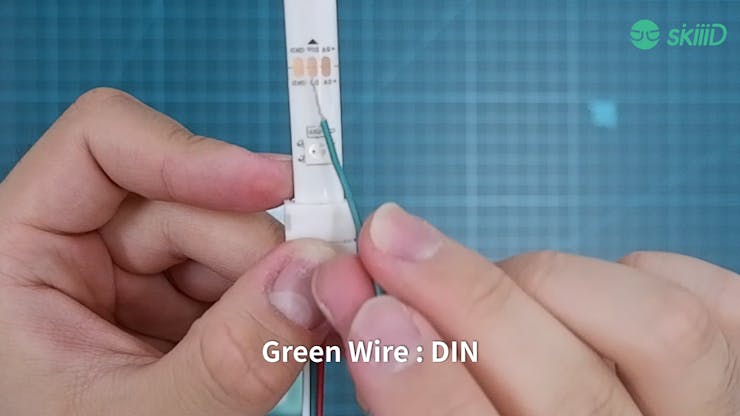

5Neopixel
Figure out right port of Neopixel

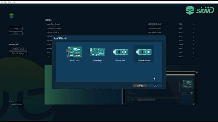

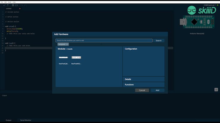

6Check out Pin recommendation from skiiiD
Click 'New' Button.
Then select the board prepared. In our case, we use Arduino Nano(old bootloader).
Click + button on the right-hand side.
Search or select Neopixel SW2812.
When clicking the component can figure out which pin is recommended.
*you can configure it
GND: GND
DIN : 3
4-7VDC: 5V
According to Pin indication, put Neopixel wires on the breadboard.

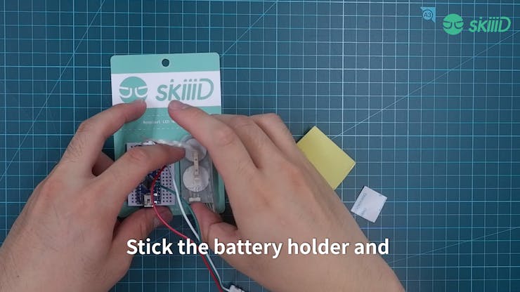

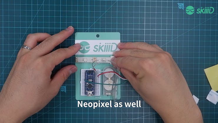

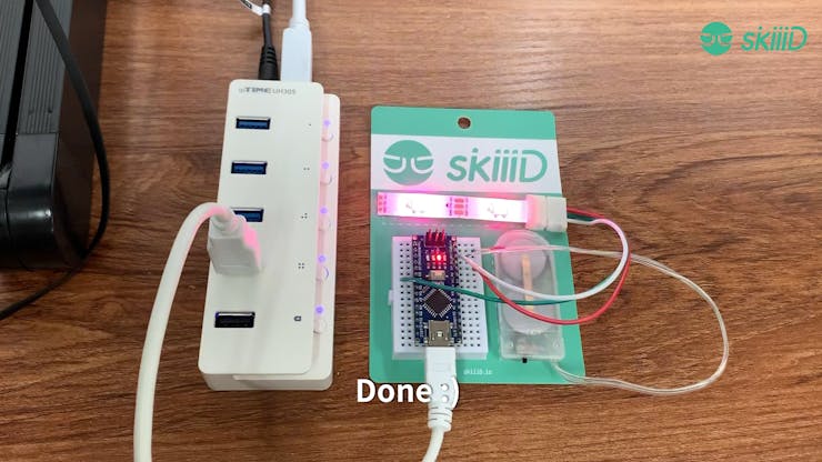

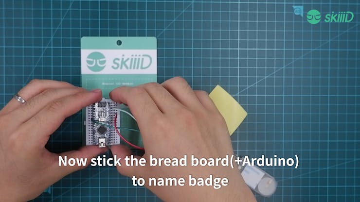

7Assemble
Stick all the materials.

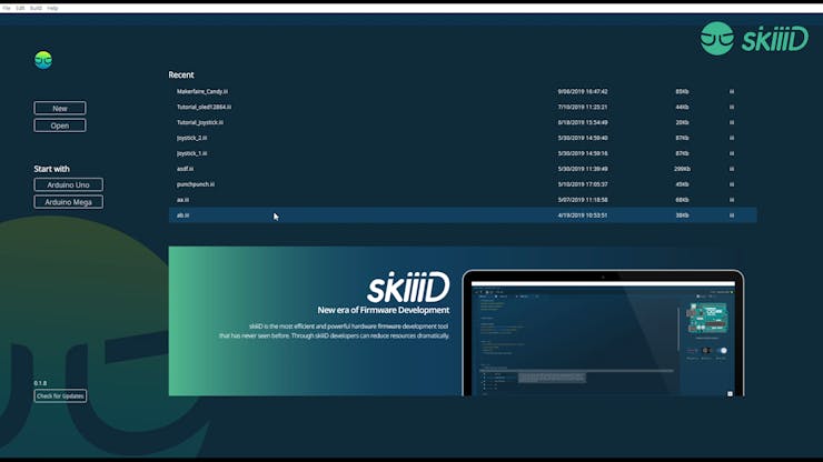

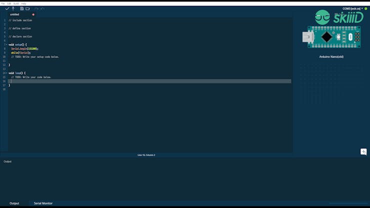

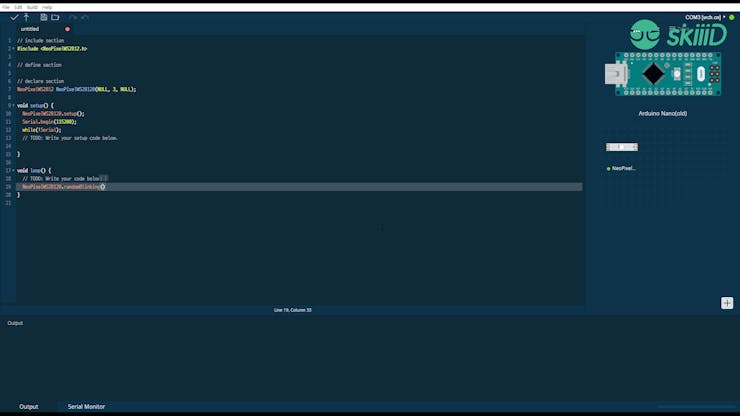

8Coding
Let's back to skiiiD Editor.

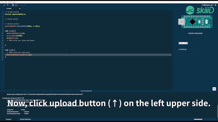

Type below code or use auto-complete function for coding.
NeoPixelWS28120.randomBlinking();
Click Upload button on the left upper side.
