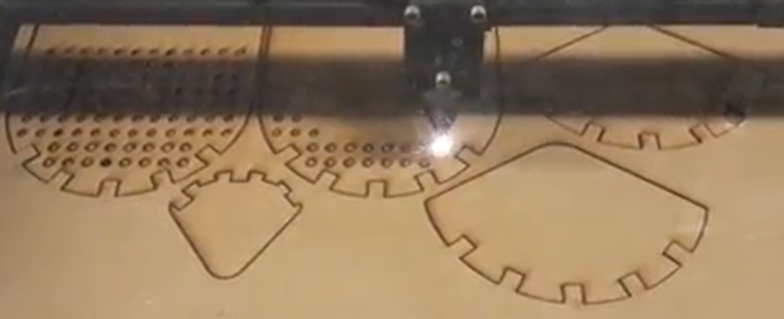

    After much journeying through the murky world of commercial laser cutting and 3D Printing I have been forced to abandon my BLDC Spherical motor as it would cost far too much. As it stands I have already managed to spend my budget twice over by cannibalising the budgets of other students who have been forced to abandon their manufacture.
    But at least the one of my designs can still get made :).

    After spending a significant amount of time over the last week trying to contact and then, in one instance, haggle with various metal cutting, laser cutting and 3D-printers I have managed to arrange for the majority of my components to be manufactured external.
    So that's good, all that's left now is to assemble my pieces together. Though that could be easier said than done considering that I really do not have access to many tools in my student house. Perhaps I'll go home to do that stuff.

    Before Christmas I thought I had managed to achieve this, as indicated by the attached image. However upon trying to combine the two half signals into one or apply a low-pass filter circuit the waveforms generated did not look at all correct. (These circuits were very basic however, only featuring a sparse collection of resistors and capacitors).
    So to all those who have struggled to the end of this post -
     Anybody got any advice when it comes to generating 3 Phase AC power from an Arduino-based system for an electronics newbie? Any tips would be appreciated :D
    -Also if the advice could focus on the Arduino + Motor shield Combination then that would be ideal, as I have already put a reasonably large amount of my project budget into those components. (Not the end of the world though).
