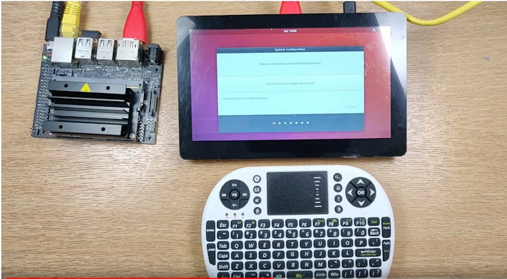

To get started and boot the Jetson Nano you need the following hardwares:
- The Jetson Nano: Link
- HDMI Screen, I used a 7inch touchscreen from DFRobot
- Keyboard & Mouse, I got a wireless combo from DFRobot
- SD card of at least 16GB and class 10
- A minimum of 5V 2Amp micro USB power supply
- Ethernet Cable or a WiFi card to add internet access to the Jetson Nano

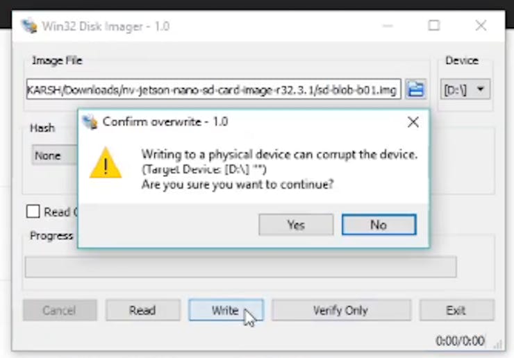

5Preparing the SD Card
1) Download the Jetson Nano Developer Kit SD Card Image, and note where it was saved on the computer.
2) Download an image flasher software for your OS, I used Win32 Disk imager tool on windows to flash the SD card with the image downloaded in step 1.
3) Connect your SD Card to your computer/laptop and then using the flasher tool on your computer flash the downloaded image to the SD card.
4) Once the image is flashed on the SD card, the card is ready to be inserted into the Jetson Nano

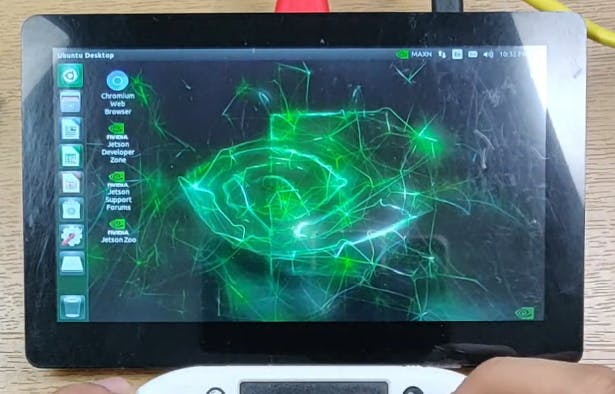

7Installing the demos:
First, update and upgrade the software:
sudo apt-get update sudo apt upgrade
Once the updates are done, we will now install VisionWorks demo, to install we first need to navigate to the folder having the install script by the following command:
cd /usr/share/visionworks/sources/
We need to copy the script to the root location, and navigate to the root location:
./install-samples.sh ~ cd ~
In the root folder, you will find the visionworks works folder inside which you need to run the make command.
cd /VisionWorks-1.6-Samples/ make
Once the make command is executed, you can navigate to the following path to run the demos
cd /bin/aarch64/linux/release/ ls
In this folder, you will see the multiple demos which you can run in the following way:
./nvx_demo_feature_tracker
Once the command executes you will see a window like this:
