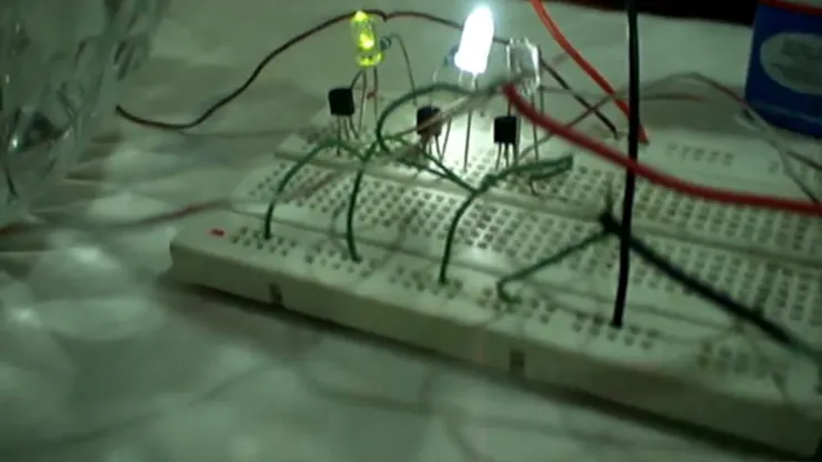

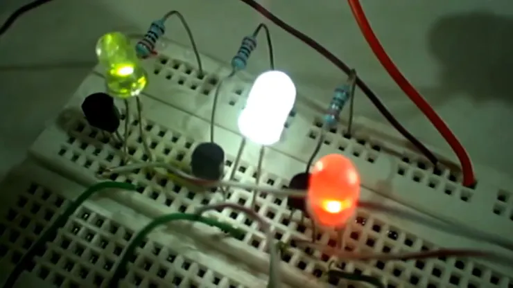

1. Insert BC547 transistor on the breadboard. The left one is collector, the middle one is base and the last one is the emitter.
2. Insert the other two transistors as well on the breadboard
3. Connect 330 ohms resistors to al the collector terminals of the transistor of the breadboard.
4. Now insert the green Led with its anode to the emitter of first transistor and cathode to the negative rail of the breadboard and do the same for white and red LEDs.
5. Now connect the buzzer on the breadboard. Connect the negative wire of the buzzer to the negative rail of the breadboard and positive wire to the emitter of the third transistor.
6. Connect one wire each to the base of the transistors. Dip the other end of the wire in the container with water, it is important to dip the wires in the water level-wise and not keep the bare ends of the wire on the same level.
7. Connect the power to the circuit and start adding water to the bowl and see the LED's light up sequentially and the buzzer buzzing at the end.
