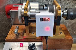

Hackaday.io Hackaday.io
Sign up Log in
No Touch Hand Washing Countdown Timer
A simple 20 second no touch countdown timer using and Arduino UNO, an HC-SR04 Ultrasonic sensor and a 7 segment display.
paul-mccabePaul McCabe
Following Follow project
Liked Like project
Become a Hackaday.io member
Sign up with Github
Sign up with Twitter
OR
Forgot your password?
Just one more thing
Pick an awesome username
hackaday.io/
Pick a few interests
Choose more interests.
OK, I'm done! Skip
Join this project
Public Chat
900 views
0 comments
3 followers
4 likes
  • Description
  • Details
  • Files 1
    • View all
  • Components 5
    • View all
  • Logs 0
  • Instructions 0
  • Discussion 0
View Gallery
Public Chat
900
0
3
4
Team (1)
  • paul-mccabePaul McCabe
Join this project's team
  • HandWashingTimer
  • UltraSonic Sensor Code
  • 7 Segment Display Code
completed project
hardware
Hand Washing timer COVID-19 corona Virus hands free timer
Related lists
COVID-19 Response Project List
A project list for all projects that have to do with the COVID-19 (Coronavirus) pandemic.
This project was created on 03/22/2020 and last updated 2 years ago.
Description
The CDC recommends we wash our hands for at least 20 seconds due to the current COVID-19 pandemic. This is a simple no touch 20 second count down timer that you can use while washing your hands. The 20 count down starts when you wave your hand near the ultrasonic sensor.
Details
Files
handWashingTimer.ino
Arduino Sketch
ino - 6.40 kB - 03/22/2020 at 00:49
Download
Components
  • 1 × 1 each -Arduino UNO
  • 1 × 1 each - 4 Digit 7 Segment Display SMA420564
  • 1 × 1 each - UltraSonic Sensor HC-SR04
  • 1 × 4 each - 220 Ohm resistor
  • 1 × USB Battery
Log In/Sign up to comment
Become a Hackaday.io Member
Sign up with Github
Sign up with Twitter
OR
A Gesture based Arduino project to control the basic functionalities of a PPT presentation/VLC media player
Project Owner Contributor
GestoSwiper
rasank-patroRasank Patro
On this project I will show you how to measure the speed of movement of an object using ultrasonic sensor.
Project Owner Contributor
Speed Measurement Using HC-SR04 Ultrasonic Sensor
mircemkmircemk
A simple smoke detector using and Arduino and a Carbon Monoxide Sensor.
Project Owner Contributor
Smoke 'Detector'
dar-elDar-El
Arduino Parking Sensor with HC-SR04 Ultrasonic Sensor
Project Owner Contributor
Arduino Parking Sensor
circle-electronicCircle Electronic
Going up?
© 2026 Hackaday
Yes, delete it Cancel
You are about to report the project "No Touch Hand Washing Countdown Timer", please tell us the reason.
Send message
Remove Member
