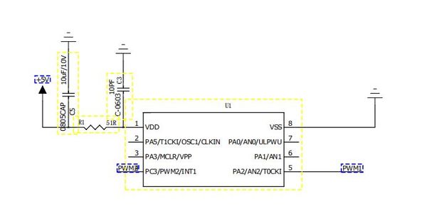

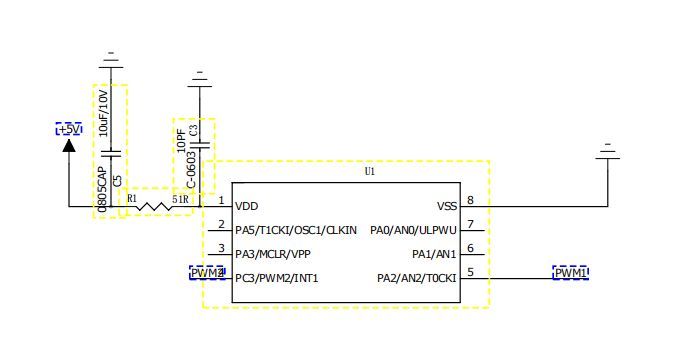

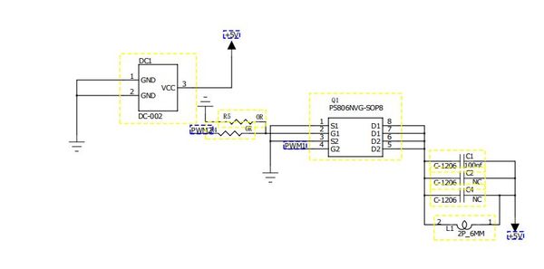

1 Charging Base
Connect 5V dc to power MCU directly. We use the SN8F5701 to support 5V direct power supply, which can save a step of reducing the voltage of LDO. two PWM of MCU control MOS tube switch, so as to achieve the control of coil L1 frequency, and then generate magnetic field and electromotive force, as the transmitter of wireless charge.
