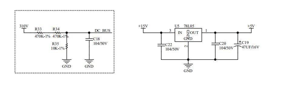

Step 2: Power Detection and Buck Circuit
The input voltage can be directly detected by MCU after voltage division and can be used for circuit protection.
15V dc voltage through 78L05 buck voltage to 5V, for MCU use
