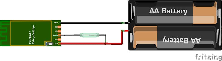

In principle it works like that. When the magnet part is near to the reed sensor part (door closed) it disconnects IO1 from BATT, if the magnet move apart from reed sensor (door opened) it connects BATT voltage to IO1_Wakeup signal and wakes the board up.

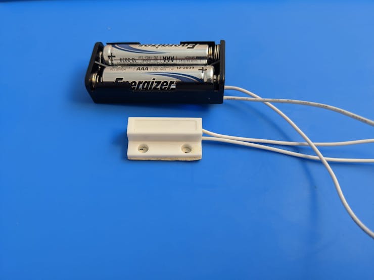

Before you start, please make sure you have the following components:

    We use the NC reed sensor. Follow the schematics below to connect all components together.
    Once you assemble, the circuits should work as follow. When a door is opened it wakes-up the Cricket indicated by LED blinking.

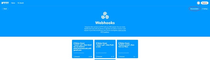

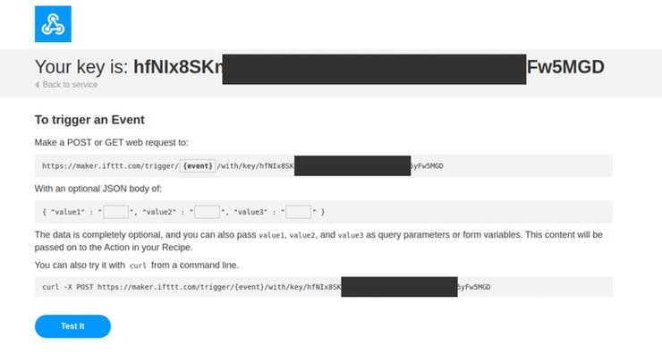

    Almost there, now you need to get a HTTP address to which we can post events from the IoT module. Search for Webhooks service and click on the document in the right up corner.
    Next copy web links under"Make a POST or GET web request to:" you will need it later.

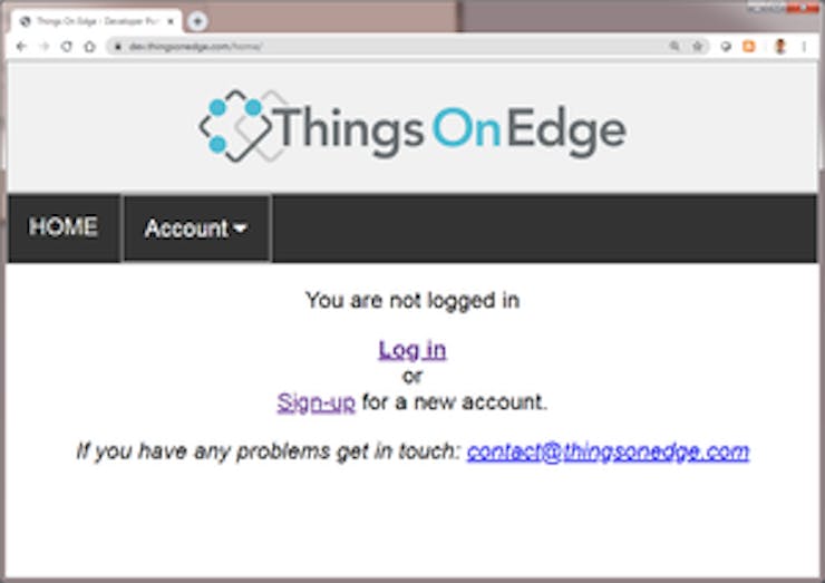

    Open TOE Developer Portal from any browser either from PC or mobile. You must register/login to Developer Portal to activate and configure the device in your account. Otherwise the device won't work.

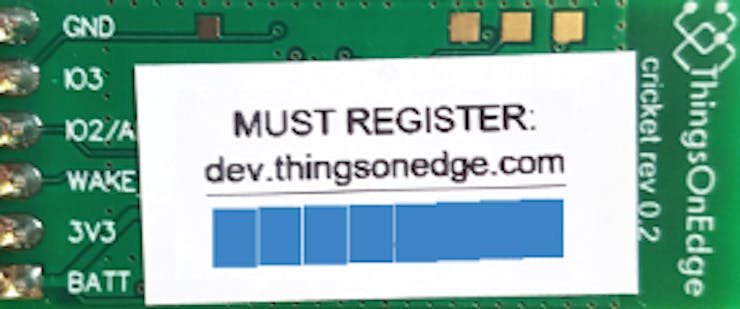

    After successful login / registration you need to click "Add new" device to activate your device in the system. You need to use the unique serial number printed on a label stick on the back of Cricket.
    NOTE: You must keep the serial number for yourself only. Do not share it with anyone else.

    Copy / paste the link we copied from Webhooks in io1_wakeup:
    URL:
    • replace https to http
    • replace event to door_sensor
    the link should look like this below:
    http://maker.ifttt.com/trigger/door_sensor/with/key/{key}

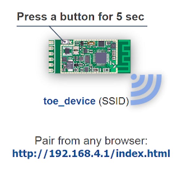

    Connect to Wi-Fi network (internet)
    Press the button on the Cricket for 5 seconds until the LED is constantly lit. Then connect from any device with web browser capabilities (smartphone, laptop,...) to toe_device Circket's private Wi-Fi network. Open http://192.168.4.1/index.html page and pass your Wi-Fi credentials. That's it.
    More information how to provision Cricket with your Wi-Fi network can be found in Cricket's IOT Developer Guide documentation.
    Now our device is live and connected to the internet!
    Fetch the configuration from Developer Portal
    Just one more step. Press the on board button for 1 second to fetch the configuration from Developer Portal. Now you are all set and you should keep receiving notifications on your phone when a door is open.
