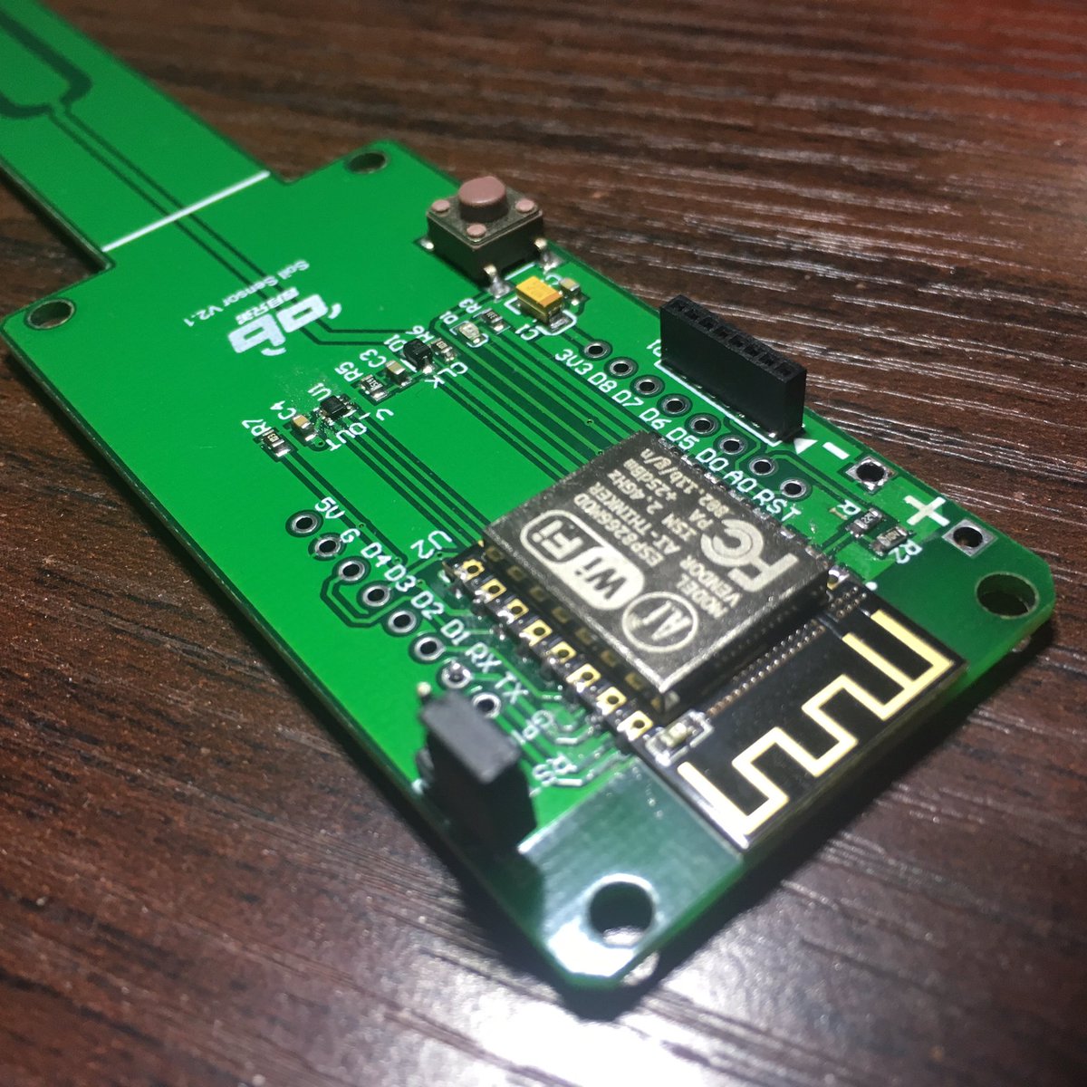

ESP8266 based soil moisture sensor Wi-Fi enabled. Also provide ambient temperature and humidity sensor.
At the sensor's heart is an ESP8266 WiFi microcontroller clocked at 80 MHz and at 3.3V logic. This microcontroller contains a Tensilica chip core as well as a full WiFi stack. You can program the microcontroller using the Arduino IDE for an easy-to-run Internet of Things core. You can use ESP8266 flasher that an upload code at a blistering 115200 baud for fast development time. It also has auto-reset so no noodling with pins and reset button pressings.
The sensor can upload sensor datas to remote server. We provided example code for uploading to thingspeak.
== Hardware ==
* ESP-12F module x 1
* Button x 1
* Programming pinouts
* Red led x 1
* DHT11 temperature & humidity sensor x 1
* Soil moisture sensor x 1
* AA Battery holder x 1
* Measures 35mm x 157mm
The project is modifying of the I2C Moisture Sensor project from Miceuz. Thanks for his source code

Rene wrote 11/02/2016 at 12:07 • point
Hi! I guess you are using capacitive moisture probing? Could you provide some schematics and code?
Thanks for sharing!
yancan wrote 11/02/2016 at 14:38 • point
Yes. It's capacitive moisture probing. Please check the link for schematic and code.
https://github.com/AprilBrother/esp-soil-moisture-sensor
