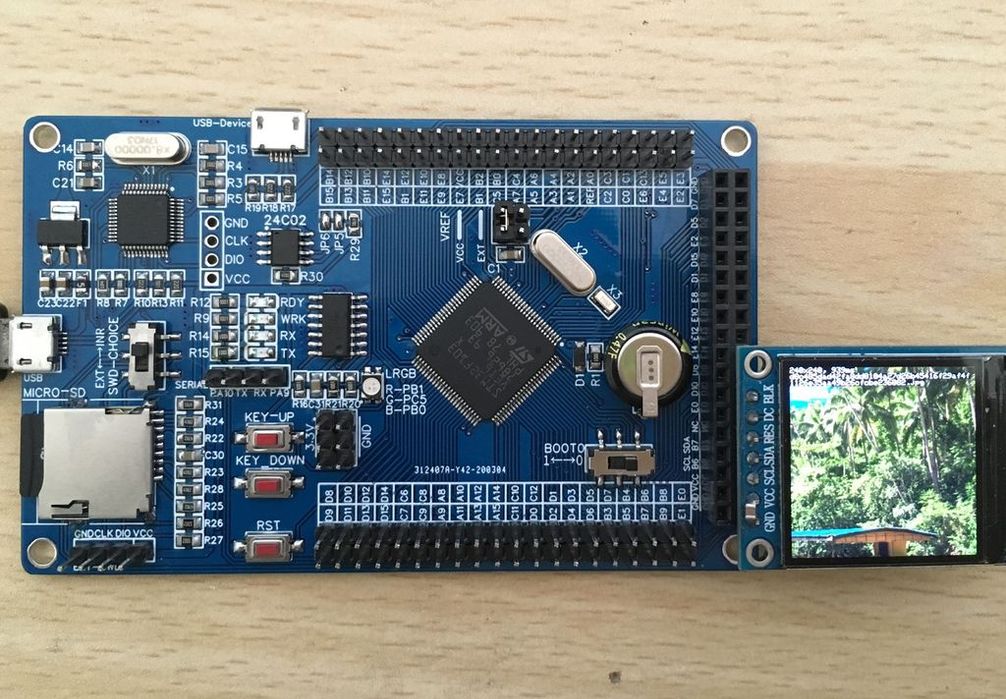

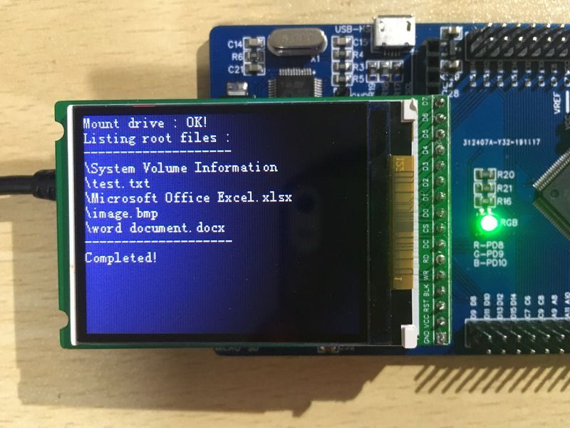

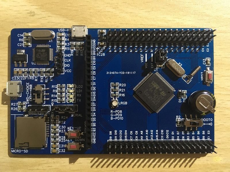

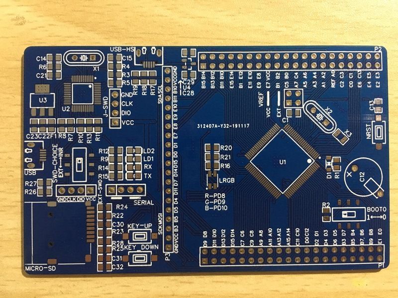

Hackaday.io Hackaday.io
Sign up Log in
STM32F1032F205VE-Development Board
Teach how to make an STM32 development board
catherine-suiCatherine Sui
Following Follow project
Liked Like project
Become a Hackaday.io member
Sign up with Github
Sign up with Twitter
OR
Forgot your password?
Just one more thing
Pick an awesome username
hackaday.io/
Pick a few interests
Choose more interests.
OK, I'm done! Skip
Join this project
376 views
0 comments
2 followers
2 likes
  • Description
  • Details
  • Files 1
    • View all
  • Components 0
  • Logs 0
  • Instructions 0
  • Discussion 0
View Gallery
376
0
2
2
Team (1)
  • catherine-suiCatherine Sui
Join this project's team
  • JLCPCB
ongoing project
hardware
development board PCB design pcb project JLCPCB
This project is submitted for
  • Change the Planet with PSoCĀ® IoT Design
  • Making Tech At Home
This project was created on 06/12/2020 and last updated 6 years ago.
Description
This is the smallest system board based on STM32F1032F205VE and carries ST-LinkV2.1, which is also compatible with STM32F103Vx and STM32F407Vx.
Details
JLCPCB:STM32F1032F205VE-Development Board
This is the smallest system board based on STM32F1032F205VE and carries ST-LinkV2.1, which is also compatible with STM32F103Vx and STM32F407Vx.
Step 1: Characters
Characters
New PCB sample by JLCPCB by $2 for 5 pcs.
1 Optimize circuit design by EasyEDA, now all GPIO map to at most 1 peripheral, no IO conflicts
2 Optimize circuit layout
3A set of power pins has been added to power the peripherals RBG lamps now use an op-amp drive (voltage following mode) to reduce the impact on IO port output hf signals
4 Add EEPROM chip (AT24C02 256Byte) for the fast storage of application data.
5 You can eliminate the need to use internal Flash to simulate EEPROM and reduce wear and tear on internal Flash.
6 Spi-flash was added to meet the need for persistent data storage.
7 The LCD interface was redesigned to retain support for most of the finished modules on the market while improving scalability. It is now compatible with 16bit and 8Bit 8080 LCD screen modules.
8 Both EEPROM and SPI-Flash can be turned on or off with jumpers Fixed some bugs and now can better support STM32F103Vx and STM32F407Vx.
9 Mounting holes are added to facilitate positioning and mounting.
10 Optimize screen printing for clearer hints.
Step 2: MCU Characters
MCU Characters
The board looks like after free SMT service from JLCPCB
1 32-bit ARM Contextm3 core, maximum 120MHz main frequency
2 512KB ROM + 128KB SRAM
3 14 timers
4 Three 12-bit AdCs and two 12-bit DACS FSMC function
Step 3: System Board Characteristics:
System Board Characteristics:
1 Onboard ST cc-link V2.1
2 Micro-USB interface, 500mA over stream protection
3 The BOOT0 switch USES a toggle switch, and there is also a toggle switch to switch the built-in/external ST-Link
4 Four status indicator LEDs are onboard, and one co-positive RGB LED is programmed
5 An interface compatible with most small display modules
6 Micro - SD interface
7 USB - FS Three keys, one for reset, the other two for user keys
8 0.47F ultracapacitor, supplying power to RTC
Step 4: Schematic
Note: : Another ST-Link is needed to write ST-Link's Bootloader for STM32F103CBT6 on the board. The firmware is in the attachment. After downloading and burning the firmware, the on-board ST-Link function can be normally used after st-Link Utilities is upgraded.
Step 5: PCB File
Complete File Enclosed, if you have any interest to make comments, please feel free to leave a message here.
Files
STM32F205VE-SDCard.zip
x-zip-compressed - 1.77 MB - 06/12/2020 at 09:49
Download
Log In/Sign up to comment
Become a Hackaday.io Member
Sign up with Github
Sign up with Twitter
OR
Hackaday Prize 2019
A MIDI sequencer
Project Owner Contributor
Beat707
frank-bussFrank Buss
Decawave DWM1000 and an ATSAMD21 ARM Cortex M0 in the Adafruit feather form-factor for projects requiring localization
Project Owner Contributor
UWB Localization Feather
jed-hodsonJed Hodson
A minimal board for PDIP ATmega 1284/644/32 MCU which interfaces easily to a solderless prototype board.
Project Owner Contributor
Student AVR board
bruce-landBruce Land
This is an Arduino Uno Wifi2 derivative (atmega4809) with the WiFi and other "extra" features deleted.
Project Owner Contributor
Freeduino 4809
westfwWestfW
Going up?
© 2026 Hackaday
Yes, delete it Cancel
You are about to report the project "STM32F1032F205VE-Development Board", please tell us the reason.
Send message
Remove Member
