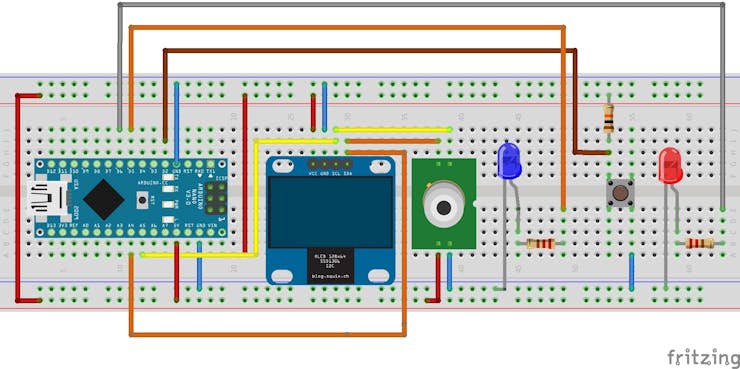

Based on this, you will develop a NEXTPCB Thermometer using an MLX 90614 infrared sensor with an Arduino Nano. This system will consist of an OLED display to show the temperature value and a button to activate or not the sensor reading.
In addition, we will have a blue led to indicate when the system is on and a red led to indicate when the temperature is above 39 ºC.

In figure 1, it is possible to see the circuit mounted on the protoboard to perform the system tests.
Figure 1 - Screen to start reading the temperature value.
The following message appears in Portuguese on the screen "IR Thermometer - Press the button to activate the sensor".
To activate the temperature reading, you need to press the green button.
After pressing, the system is activated and the blue LED lights up as shown in figure 2.
1 / 2
In the OLED display in figure 2, the following message appears in Portuguese "IR Thermometer - Temperature: 28.07 and Normal Temperature!".
In addition to displaying the temperature value, this system displays a message indicating whether the temperature is normal or if she needs to see a doctor. This can be seen in figure 3.
1 / 2 • Figure 3 - System on and temperature above 39º C.
The figure above shows the following message in Portuguese "IR Thermometer - Temperature: 40.00oC and Find a doctor!"
In the figure, the system detected a temperature above 39 ºC and therefore displayed the message: Look for a doctor and switched on the red alert LED.

Below, we present the electronic schematic for you to assemble this project on the protoboard.
To assemble the device, we need to assemble the circuit on the protoboard as shown in figure 4.
Both the OLED display and the MLX 90614 temperature sensor uses I2C communication to communicate with the Arduino Nano.
