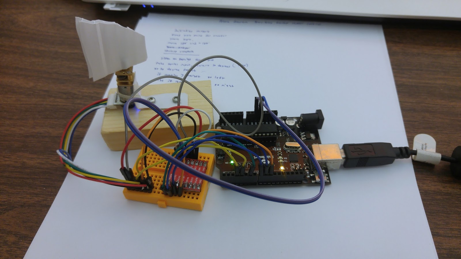

---------- more ----------In working towards a positional control system, the first order of business was to go for the most basic of controllers; Bang-Bang. Dead simple to implement but not without numerous shortcomings. Several of these removed it from even consideration of the flight unit due to possibility of overcontrol or destructive airframe resonance. Airframe resonance would start as a flutter in the fins but spread to the stabilizer oscillating on the front of the rocket before finally leading to a full half of the body wobbling about the split for parachute deployment and snapping the rocket in half mid-flight. Another nightmare scenario is overcontrol, where the system attempts to correct course changes but turns itself into a kinetic hazard as it passes the +- 5 degrees off vertical allowable range for safe flight or worse goes sideways and WAY off course.
A Bang-Bang control system is dead simple, if the value is not reached, keep going until it's passed at which point you go backwards. The issue arises in that the system runs at full tilt and will always overshoot unless there is a lot of inertia in the system(e.g. a flywheel or significant thermal mass) leading to the oscillation around the target value as depicted in the figure below. During my initial implementation of the controller, I had a serious problem where the system would appear to be on target and tracking but would start spinning as the counts went from the expected range (0-300) to around 32,767 before flipping out. This is an indicator of unsigned int overflow but limiting the system read range to 300 did nothing to minimize this issue. Rereading the documentation, I realized that the encoder pins were not both on the hardware interrupts and that was causing it to miss a lot of counts since A phase was on HWINT1 but B phase was on a regular pin set as an interrupt. Moving B phase to HWINT0 fixed this problem. Attempts to lower the jitter around the target included decreasing drive PWM and testing deadzones and braking but none of those worked to the extent required for flight confidence. As I had eliminated bang-bang from flight consideration, I turned to the more complicated but also FAR superior PID controller which was a heck of a challenge.
A proportional–integral–derivative (PID) is a controller that calculated the difference between setpoint and current variable and corrects based on the three terms (Kp, Ki, Kd). I'm going to leave the rest of the explanation to Brett Beauregard who wrote the FANTASTIC library I'm using. Early attempts at implementing the PID by taping the well-respected PID library into the bang-bang controller led to frustration due to calculated outputs being WAY off the expected. The odd thing was outputs either sharply moving around but not passing 255 or locked at that value. As I was hitting the limits of my coding knowlege I called up Joe Barnard of Barnard Propulsion Systems (the OTHER active stabilization guy on the internet) to see if he would be able to help figure out what was going wrong. Unfortunately neither of us was able to make any sense of why it wouldn't work even after 3 hours of trying to debug. It wasn't until I found a very different method of driving the TB6612FNG in a Pololu robot, specifically the 3Pi that I finally got the system working. Instead of pulling the direction pins to logical 1/0 and driving the PWM pin I pulled PWM HIGH, and drove both directions with PWM signals, which puts the driver in half-brake mode and only needs 2 IO pins instead of 4. The magical code that finally got the system working is as follows;
void pwmOut(int out) { if (out > 0) { analogWrite(AIN1, out); analogWrite(AIN2, 0); } else { analogWrite(AIN1, 0); analogWrite(AIN2, abs(out)); }}
More tuning and testing needs to be done in addition to implementing servo-protocol control but this is VERY good news since I had been holding off on further system hardware work until I'd solved the problem of positional motor control. Hold on, I know you were wondering "Hey wait a minute you said something about source code, yet you said this project is likely under ITAR, what gives!?!" no? Well you're not exaaaactly wrong. I won't be sharing the source code for the rocket controller or other fun parts but CAN share the positional control since it's not regulated and a good lesson in control mechanics. The primary reason I'm sharing this is because all the existing material out there is either absurdly vague or headache inducing with uncommented code and very strange implementations of parts. So as a firm believer in open source and learning from analyzing other's code, I have adopted the beerware license on this and my other projects that will be getting code releases. My code is available on my GitHub for everyone to use and learn from. Timelapse of my fighting with the code has also been uploaded from one of my later Twitch streams.Initial test version showing issues with PID output (orange)
The magical sight of a working PID plant in action.
Too much gain
Locked on and holding positionNow as some of my longer-term readers will know due to me living farther out from civilization I'd been having some godawful internet. 80gb/month and horrifically slow (<1mb/s) is REALLY not conducive to content creation or getting much done. However the big red ISP has decided to bring back uncapped internet which has been WONDERFUL! From limping along and hitting the 80gb cap frequently, now comfortably burning 300+ a month and oddly the speeds are around 10mb/s. Now with all this power, I've done something that was discussed for a long time: Livestreams! From the stream lair I did a 2 hour quick CAD cloning of the Pharah Mechaqueen rocket from an image to get a feel for streaming, and will definitely be doing more soon including Live from the lab. More work needs to be done on the upstream settings, audio levels and recording but it's a start.

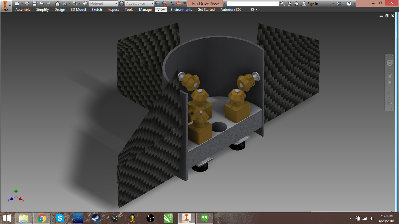

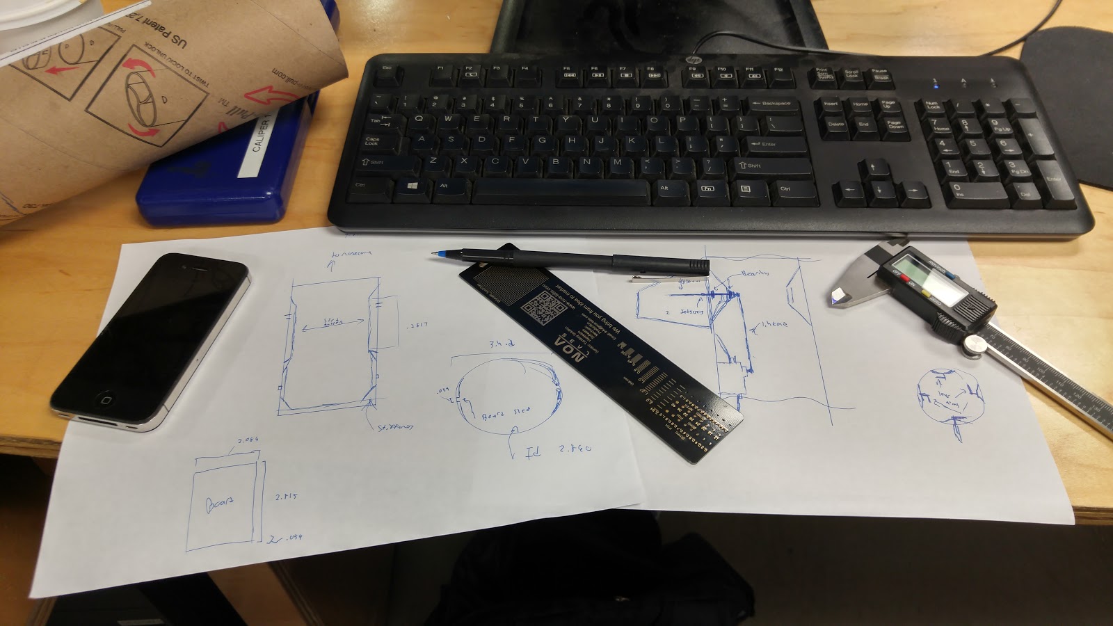

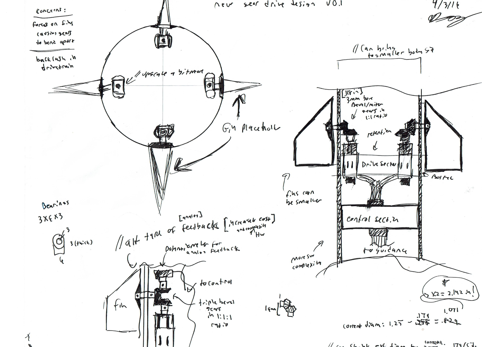

With bevel gears as the motion transfer solution in mind, I thought back to motors and remembered that there are small diameter low voltage geared motors with micro encoders available on Pololu and the other usual sites. I did consider using high end Faulhalber motors with built in encoders but gave up when I saw the prices were $25 a piece, completely out of my price range. With that sorted I roughly sketched a layout for the system. Once the motors were sorted, then came the second biggest challenge; the bevel gears. I tried the usual distributors, McMaster, KHK, Robotshop, RS and eBay all to no avail. Motionco did sell acetal(plastic) gears but in this case metal is the way to go and they were UK based. I called several gear manufacturers but their quotes ranged from the low to mid hundreds which is WAY out of my price range. Slightly disheartened I turned to the last place I could think; Aliexpress. Thankfully, there are gears available though they are a bit expensive ($16/pair of which $4 is shipping that cannot be combined for some reason). The geartrain ratio between the motor and the fin output is 1:1 as is standard with most bevel gear configurations. Now that the basics for the power transfer system were locked in, I drew block diagrams and crunched the numbers for the encoder precision which came out to be .3deg/pulse on the output on the 1:100 geared 6V motor. Bearings were much easier since 3mm bores are a common dimension, a quick eBay search yielded a bag of ten 3x6x2.5 flanged bearings for well under $20.
Armed with the sketches and an idea of the final goal, I set to constructing CAD models for future 3D printing. In the first revision I decided to try making it air frame compatible with the current system for drop-in usability and interchangeability. However, once the model was complete I noticed that there was a LOT of room for miniaturization with all the space between the motors, output shaft and side walls. In total, I was able to carve off 28.5mm bringing the total diameter down to 47.72mm(1.879in) which is 62% smaller than the initial version. The smaller diameter means that cheaper blue tube air frames can be used in the flight and testing versions. Another aim of shrinking the size and weight is so that smaller and cheaper engines are able to be used that also do not require a L2+ high power rocket certification. After asking around and talking to none other than George Gassway (Sun-based stabilization) I found out that I CAN launch at NAR sites and not have to head out to the desert to fly.
Post-miniaturization I realized that using motors with encoders will result in relative positional control compared to the absolute positional control that the prior servo version had. Thinking on the problem led me to use potentiometers to supplement the encoders so I don't get off-center fins on startup leading to air frame destruction. The addition of the potentiometers adds an additional layer of complexity to the already highly involved code that will be controlling 6 PID loops for the motors and stability control. The code will be the biggest challenge for this whole project, combining Kalman filters, multiple PID loops, a whole control system and then on top of all that, a telemetry down link. For the positional motor control, I came across HomoFaciens' incredible videos on discrete servos, arduino based servos and encoder digital servos of which I will be forking his code into my system. It's currently quite a bit out of my comfort zone, though I am studying control theory on my own, taping code examples together and hoping I have it right since I do not have any hardware in front of me due to costs. Speaking of costs, crappy back of the napkin math prices this new system around $170(if all parts are bought from China) whereas the servo based version would be nearly $240 if I were to buy all the parts new, a whopping 75% savings. Each of the Hitec HS-82MG servos I used previously are about $20 each at standard market rates while the motors with encoders are going for $9.50 each thanks to the far east's cloning. If all the motors, encoders and drivers were purchased on Pololu the cost for that alone would be $99.05, and that does not include the microcontrollers, 8 bevel gears or the potentiometers, but would have known quality parts. That option is too expensive for a testing version but may be justified for the flight rated system stack. Unfortunately, due to being hit with an unexpected car repair bill among other expenses on my student budget has put buying parts for the project temporarily out of the question. I've been tempted to start a GoFundMe or Patreon to offset the costs of the projects but I always stop short of launching because I feel like a dick asking for other people's money to fund my personal projects. If readers want to donate to help offset the costs of development, there is a button in the left sidebar if they so desire.
Thanks for reading this update, as a bonus I've included more process sketches and as a special treat; a scan of the notebook page that started this whole project.

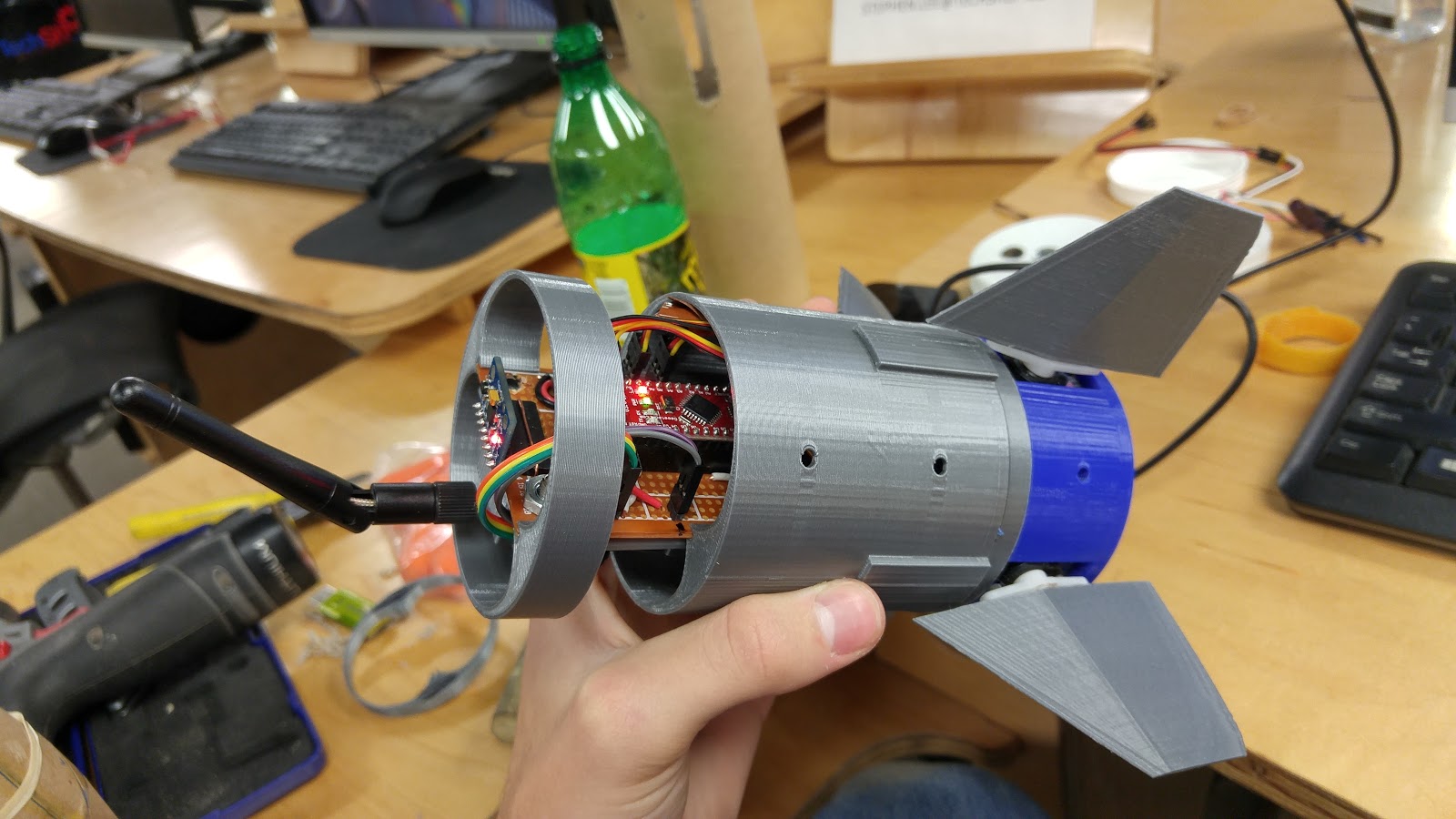

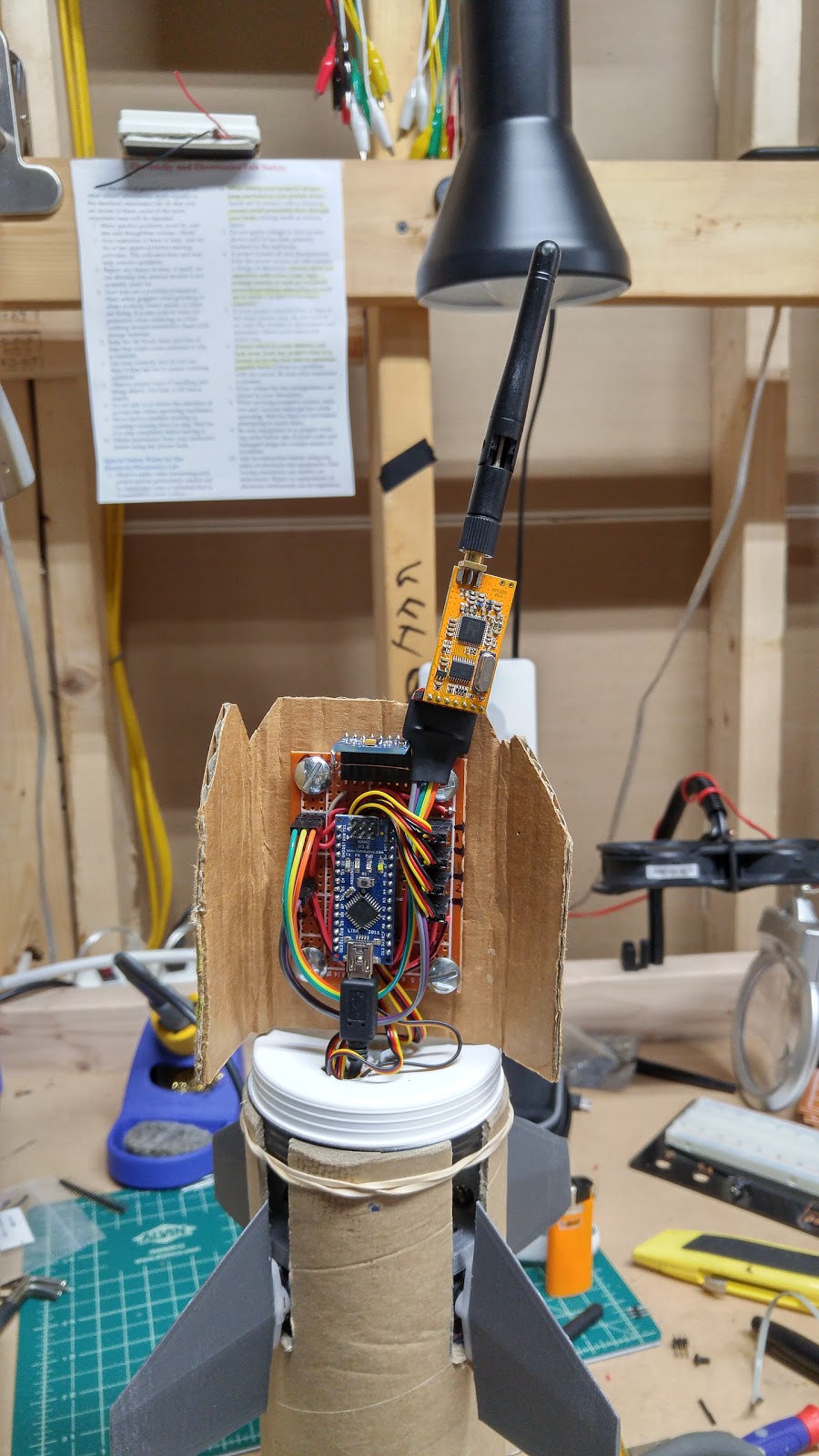

The demonstration mockup was constructed to not only have a physical representation of the final assembly but also to familiarize myself with layout and wiring inside a confined space which is new territory to me. It is constructed out of 3 inch ID cardboard mailing tubes and has fins cut from standard cardboard bolted on, nothing special or lightweight due to this not being the final flight model. The overall mass of this version is 1.48Kg of which 452g is the stabilization system module. Testing and flight versions will be constructed out of "Blue tube" for it's superior durability and lighter weight though at much higher cost ($30/4 feet, whereas the tubes I'm using I salvaged from the scrap pile for free)
Some of my longer term readers may remember how much difficulty I was having with figuring out a method for attaching a fin to the servo spline, trying everything from printing a horn to trying integration of a round arm to no avail. In the end, I decided to stop trying to reinvent the wheel and rework an older design to bolt onto a premade servo horn. These are designed in standard diamond hypersonic form with the axis point 3/4 up the mean aerodynamic chord. Due to the mounting method of fins bolting directly onto the horn, installing these after the servos are in the body tube is impossible, forcing me to have a slot-in module that is held in place with bolts. The slots perform an additional function of being mechanical endstops for the fins to prevent an overcontrol instance(in theory). Sadly, two of the scavenged servos finally kicked the bucket and a full new set is going to cost me $72 ($18/HS82MG) which is FAR out of my frayed kitestring budget which has dwindled to nearly zero as of late. If any of my readers know how to get in contact with Hitec for a sponsorship or how to get parts donated to a student project it would be greatly appreciated if you would drop me a line.

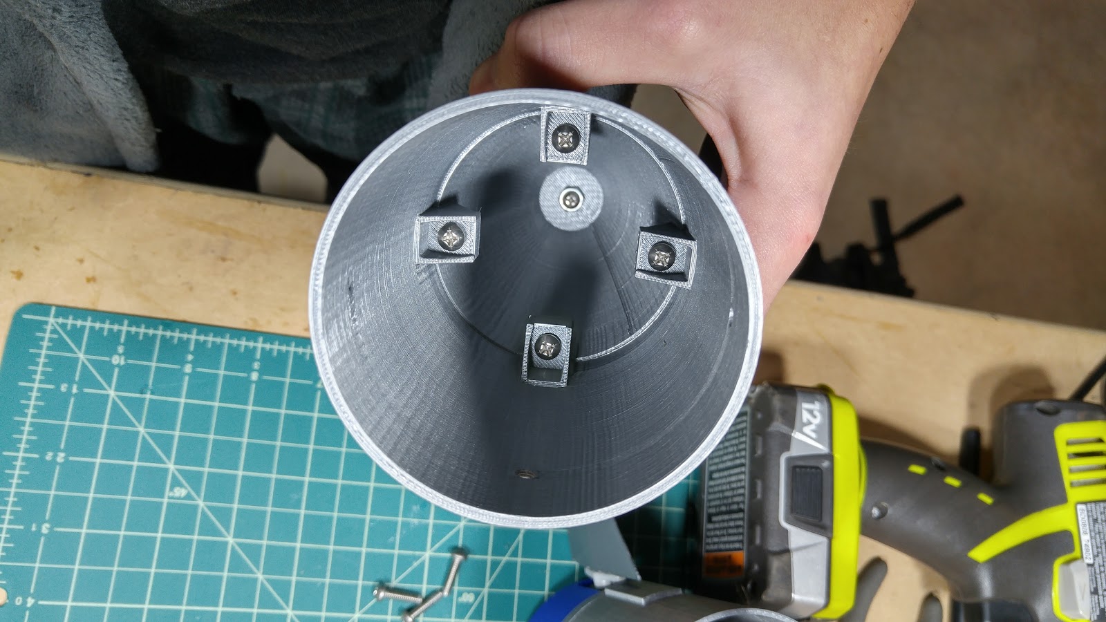

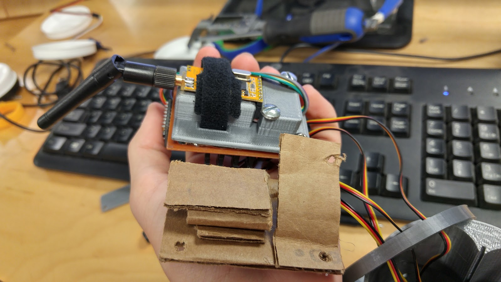

The integration can for my system needed to be reworked due to being a bit too small to fit in the 3 inch inner diameter body tube. I retained the previous method of servo containment and mounting, just upscaled a bit and added bolt holes for attaching to the airframe, in addition to adding a forward riser to hold the control board in place and provide a nose cone mounting flange. Making sure this has a slightly snug fit is key, as internal movement can instigate a self-amplifying and destructive resonant wobble. Two slots with gentle slopes leading up were employed in this version.
The breadboard and connection board of the previous version were not only too hard to set up quickly but also very fragile and annoying to work with. I'd had enough so finally I went and built a nice shield that integrates almost everything while still keeping the Arduino removable so it can be used in other projects. V1 was a first attempt, all wires were red (bad idea) and shoddily laid out which caused a lot of headaches when it simply failed to work when powered up. Debugging when powered up showed the 5V rail hanging around 1.2V and not budging at all even when everything was disconnected. After a few hours of frustration my father walked by and offhandedly remarked to check the ground, much to my chagrin I found that I'd forgotten to connect the ground net to the ground rail which promptly fixed the problems (check for floating grounds). On the second revision the power and ground wires were in standard red and black while signals are in white (I ran out of wire colors okay?) in addition to being MUCH cleaner and better laid out. On the final revison, the IMU will be flipped around 180 degrees since this mount has it offset from the centerline by about 1/4in which may cause control reference issues resulting in the loss of launch vehicle.
Since I will be monitoring this launch from the ground during ascent I needed to get a telemetry solution figured out. Since I had a pair of APC220 wireless UART transceivers laying around after I was gifted them the year prior I decided to use those since they were not only on hand but had good nominal range (2Km LOS). After an initial prototype of a backpack in cardboard and hot glue, I designed and printed a proper backpack that has Velcro to hold down the module and a captive adapter for power and data lines. This assembly bolts onto the back of the control board with two diagonally placed holes as all 4 would interfere with my...not so great point to point soldering.
Powered up 90% completed model

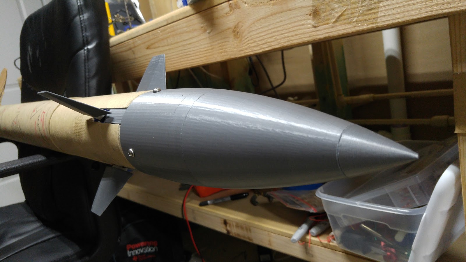

The nose cone was quite the interesting design challenge, the total height was 15 inches which surpassed the 6.1 inch maximum vertical print volume of the Makerbot Replicator 2s at TechShop. I decided to print the nose cone in 3 parts that bolted together for modularity and ease of printing. One of the biggest challenges in this was figuring out how to get the bolt interfaces designed on the curved surfaces of the nose cone interior while still being printable without support structure. In the end I opted for simple curved leadup flush connection plates which worked phenomenally with the minimal droop of Hatchbox filament (not sponsored, just freaking love that filament).

Hacker for scale

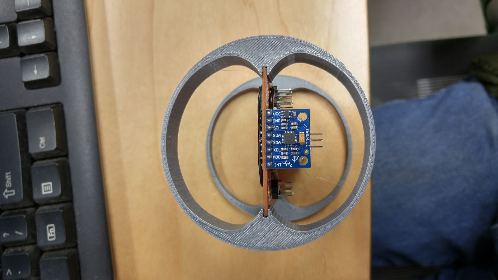

10/20/2015 at 18:47 • 1 commentThis system has been plagued with a pair of bugs that defied all logic; the Harlem Shake bug where the IMU spits random values out of nowhere even when perfectly still and the Iceman glitch where the whole system freezes up and shuts down. After mucking around with the code and a string of long nights trying to figure out what the heck was wrong with the system, I finally fixed the problem. The root cause is just inferrences at the moment, if anyone has a better theory I'd be glad to hear it. Simply changing the serial baudrate from 9600 to 115200 appears to have fixed the problems. Reading the serial logs led me to believe that the freezing glitch was caused by a FIFO (First In First Out) overflow due to the appearance of that message just before the system locked up. Initially, I had messed with the FIFO configuration to no avail before inferring that the data was coming in at a much higher rate than it was being output. My assumation is that the transcoding of the data was taking up too much processor power and causing it to get way out of whack. Googling around proved this to be the case and the fix was to increase the baudrate. After applying this fix, the system ran for 10 hours without any bugs or freezing at all, then I tested it 5 more times with resetting and the bugs did not reappear.

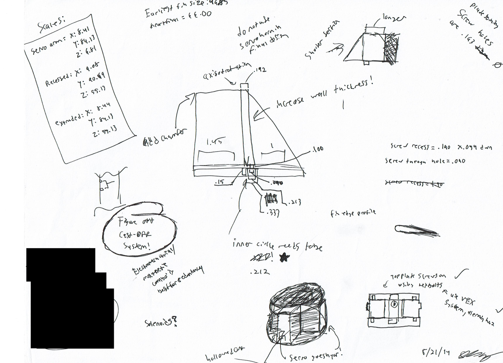

08/20/2014 at 16:44 • 0 commentsPrinted the first fin today, it got messed up really bad, warping and bad layer stacking galore! the support structure wouldnt cleanly break off!
Printed vertically and the difference is night and day!
Also reprinted the baseplates at the proper size and now the servos are a snug press-fit and don't collide in the support structure
