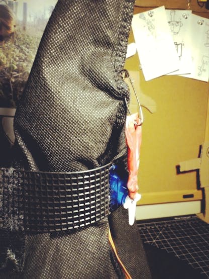

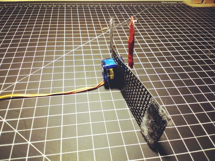

1Extend the servo horn
In order to get the amount of throw needed to wiggle the hat, I needed to extend the length of the servo horn. I did this by quickly molding some thermal-morph plastic to the horn. You'll see that as the very roughly formed red extension attached to the horn in the pictures below.
2Create the servo harness
To attach the servo to the hat, I cut a small strip of plastic canvas, which is available at any craft store.
Then I cut a rectangular hole for the servo and held it in place with a little hot glue.
Finally, on each end of the plastic canvas, I attached a strip of self-adhesive Velcro. The other half of the Velcro was attached inside the hat. (pictured below)
3Attach the servo harness to the hat
I attached the servo harness by turning the hat inside-out and adhering the self-adhesive Velcro strips about 2/3rds the way up the hat. Then I attach the horn of the servo to the hat using a safety pin.
4Putting it all together
After the servo was attached to that hat, I ran the wire down from the hat to a pocket inside the cloak that contained the Espruino micro controller and battery pack. I also ended up using a little pillow stuffing in the top of the hat to give it a little more rigidity when it's being worn.
5Some final thoughts
As you can see from the video, the program had three variations on the wiggle. The first was a quick back and forth that reminded me of a happy puppy tail. The second was a slower back and forth which had a sort of "care free" feel to it. The last version moved slower in one direction, then quickly back which reminded me of how a cat's tail moves when it's annoyed.
I found it interesting how by simply playing with the speed of the servos swing, you could almost achieve different "emotions" from the hat.
