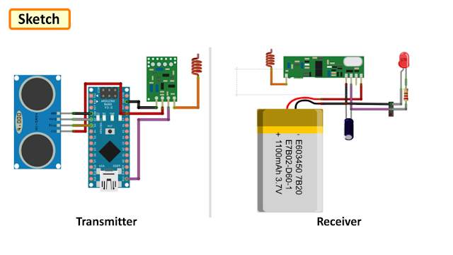

Schema

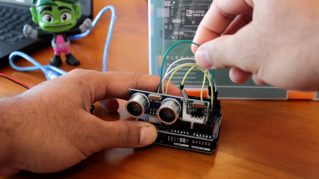

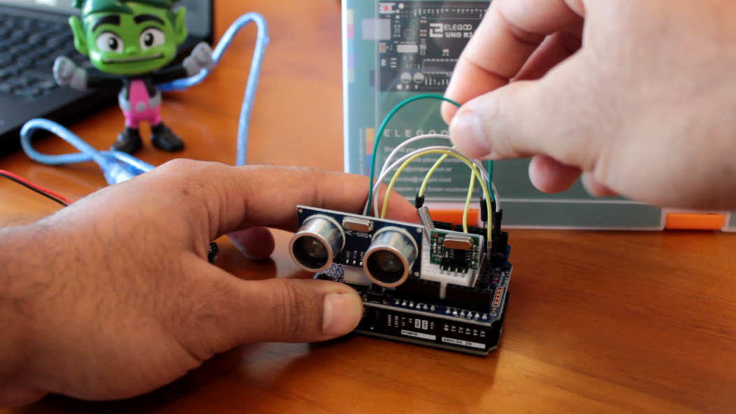

1.  First lets put together the transmitter side using an Ultrasonic Sensor.
Connect the Echo pin to D2, Trig pin to D3, Ground to GND and VCC of the Ultrasonic Sensor to +5v pin of the Arduino.
Then connect the Data pin to D13, -ve to GND and +ve pin of the RF transmitter to +5v pin of the Arduino. Finally connect the ANT pin to the antenna.

Receiver
Now for the receiver bit, connect the antenna to the ANT pin of the RF receiver. Then connect -ve to -ve, and +ve to +5v of the Battery.
Then, you can use either one of the Data pins for this project. Place the 100μF Capacitor between the data and the -ve pin of the receiver. Now, we can either attach a LED, a Buzzer, a homemade DIY relay module or an off-the-shelf Relay Module to the -ve and Data pin of the RF Receiver. For this demonstration, I am just going to use the LED.

Now lets put together all the components as per the schematic.

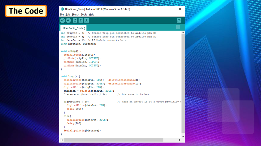

The Code
Start the code by defining the variables and pin names that will be used throughout the code.
Then in the setup section define the pin modes.
Now, in the loop section calculate the "Distance" in inches by reading the values received by the Ultrasonic Sensor.
If the distance is less than 20 then transmit a signal to the RF Receiver.

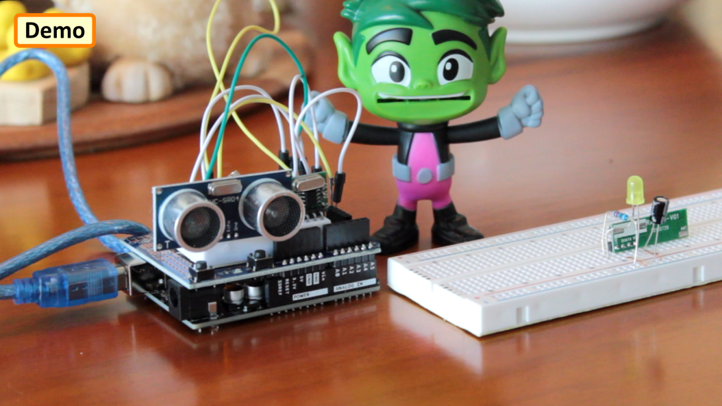

Demo
Now, if you replace the LED with a relay module you can turn your wired door bell to a wireless touchless door bell and make your neighbors jealous for not having one.
