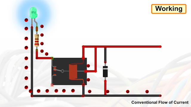

Working
When current flows through the coil of the relay, a magnetic field is created that causes a ferrous armature to move, either making or breaking an electrical connection. When the electromagnet is energized, the NO pin is the one which is on and NC pin is the one which is off. When the coil is de-energized the electromagnetic force disappears and the armature moves back to the original position turning on the NC contact. The closing and releasing of the contacts results in powering on and off of the circuits.

Connect one end of the coil to the +ve terminal of the battery. Then connect the collector of the NPN Transistor to the other pin of the coil. By increasing the base current of the transistor we can magnetize the coil which will move the armature.
Next, we need to connect a diode across the electromagnetic coil. When the transistor is turned off the diode protects the circuit against a voltage spike or the backward flow of current (inductive kickback from the coil). This voltage spike can damage the sensitive electronic components controlling the circuit.
That's it, go ahead and connect the 2nd circuit to the Common and the NO pins of the relay.
Now, you can also make this simple circuit complex by adding two LEDs one for the power indicator and one for the activation indication. You can also add terminal blocks and pin headers and turn this simple circuit into a heavily complex one.
