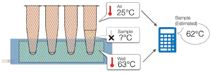

PCR can be done simply by changing temperature of plastic tubes reagents and samples in using heat elements like peltier, heater and fan. So there're already several kinds of open source PCR machines. But almost all of them (tell me if you know any exception) are not precise because they use thermistor value on heater or aluminium tube holder as the temperature of samples inside plastic tube. NinjaPCR is only one open source PCR machine with thermal simulation model.
Here's the result. Red line is output of our simulation and blue line is measured temperature inside tubes. NinjaPCR supports 16 PCR tubes (Single tube projects are not practical because they cannot compare results with poisitive/negative control). WiFi is also supported and you can use NinjaPCR with not only PC but iOS and Android. But this thermal simulation is most unique and important point we think because we failed some testing without this feature.
