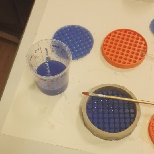

As it stands, the vacuum system is a major failure. The core principle doesn't work, it was supposed to hold SMD components in place so they wouldn’t stick to the soldering iron. There are however too many (man)holes to create proper suction. You would need to cover all of them. Even with the v2 model with fewer holes, you would still need to plug them all, which is too much work.
Initially, I was hoping the air pumps would be strong enough, and the (man)holes tiny enough, that the suction was sufficient. However, even once you plug all the holes, the silicone is too flexible to withstand the vacuum and will cave in.
Therefore, the SMD hold-in-place system needs a redesign. This can be either vacuum or something completely different. Since there are other, more pressing, design challenges; I decided to remove the complete underside from the jig (for v3). Even though, suction does work for v0. Removing the underground saves a lot time on production and makes everything easier to work with. See Picture 2 to get an idea of what assembling them involves. It shows connecting the top (above ground) and bottom (underground) parts for jig v1.

Picture 2: Assembling jig v1. a) Both halves of the silicone for jig v1. b) Make shift tool to center halves on top of each other, a cardboard tube happened to same diameter as the jig. c) Example of pouring the (other) parts of the mold, left over silicone goes in v0 molds. d) Gluing the cured halves together by brushing on more silicone, which makes a permanent bond as if it would be poured in on go. e) Testing the assembled jig v1 with a little DC air pump, more silicone was brushed on to close gaps. The good things
