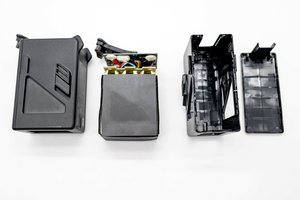

A friend had his Alienware computer's battery die on him. I bought another Alienware battery for 1EUR on a flea market, and after disassembling both of these carefully, I found out that they're actually very similar internally. So, I decided to put the working battery's guts inside the case of the faulty one.

    What do we have?
    0. A gaming laptop from Alienware with broken battery
    1. Broken Alienware battery from that laptop
    2. Working Alienware battery from a different laptop
    Ain't no Alienware warranty on this laptop anymore, and being tethered to a wall socket at all times makes a laptop into a shitty desktop. Fixing the dead battery is likely a no-go - the controllers are black boxes, there's people that know the details about them but it costs money, and I'd need to re-cell the battery anyway - spot welding batteries in a live pack isn't my favourite pastime.
    When plugging the 2. battery into the laptop, the laptop would work wonders. Internally, it looked really similar - same cell arrangement and very similar controller board.
    Solution - put guts of the 2. battery into the 1. battery case. However, I'd need to shorten these metal strips:
    It's not as simple - as soon as you disconnect any of the metal strips, the battery controller bricks itself (rightfully so), as it needs to see valid battery voltages at all times without any interruptions - anything other than that is a sign of battery malfunction, and any laptop manufacturer wants to steer clear of that. Consequently, there's no simple way to "reset" a battery controller from such an occasion, either. However, with the power of magnets and kapton tape, I got it done.
