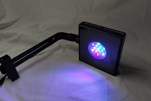

UPDATE: The process of finding the best pcb for high current LED´s led me to Metal Core PCB with sinkpad´s. Sinkpad connects the cooling surface of the MCPCB and heat pad on the LED. This gives a x100 performance in heat transfer and thereby optimizing cooling. Literally the LED´s will be mounted more or less directly on the heatsink. The PCB´s has been ordered and I am making the final adjustments to the heatsink.
CREE LED´s
https://www.cree.com/led-components/media/documents/CreeXLampHorticultureFeatureSheet.pdf
Design
The design is starting to manifest.
White LED´s use energy to lite up the full visible spectrum. The Red and Blue only one wavelength(area) and is therefore cooler in use. The difference between the red and blue wavelength is another matter.
For a office environment, the fully white GEM will be more pleasant for the human eye. In a school scenario the lamps will be part of photon to plant growth experiment.
