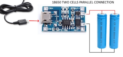

So I think I'll use a pack of two 18650 cells. When placed in parallel they will provide approximately 19 Wh, which hopefully be enough to power the set for some time. To connect and charge the batteries I used a TP4056 module, which is capable of charging 2 cells.
| (Photo taken from ACOPTEX blog) |
This will give us 3.7 V, so it has to be boosted to at least 5.1 to be usable. A MT3608 boost converter takes care of that. This unit can deliver 2A, so that should be enough. And it is, once connected to the Raspberry Pi, it boots fine and there is no more warnings about low voltage.
