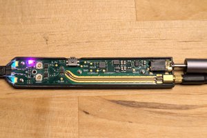

I aim to solve some of these problems with Open Field Probe. Minimal effort is required to improve the basic designs. At the very least you will be able to download CAD files and gerbers and know where they came from.

    The PCBs are designed to be fabricated on JLCPCB's 4-layer JLC7628 stackup. The top and bottom layers are continuous ground pours stitched together on the edges by a via fence. This shields the internal signal carrying trace from unwanted electrical noise. In the case of the E-field probe the shielding is pulled back near the tip where the E-field coupling takes place and in the case of the H-field probe there is a narrow slit made in the shield at the tip of the probe which permits external magnetic fields to induce a current in the loop formed by the signal trace but not in the shielding layers.
    In both probe types the signal is picked up by an internal trace on layer 2 which is modeled as a stripline, sized to have a characteristic impedance of 50 ohms. The H-field probe has one end of its pickup loop terminated into the ground shield by a via. The center of the pickup loop is cut out to minimize dielectric losses in the FR4 material.
    In order to connect to the center pin of the SMA connector the signal trace must transition to the top layer through a via at the far end of the probe. Although the prepreg thickness between the top and second layer is only 0.2mm and the full length of the via (PCB thickness) is 1.52mm the transmission line properties of the via were modeled as a coaxial cable formed by the via itself, the FR4 substrate and a surrounding ring of vias connected to the ground shield layers. Via sizing and ring spacing was calculated to maintain a characteristic impedance of 50 ohms.
    The transition of the signal trace to the top layer occurs at the edge of a ground plane pour on layer 2 which extends under the SMA connector and is heavily via stitched into the top and bottom layer ground shield pours. The segment of the signal trace between the via and SMA connector center pin pad is modeled as microstrip with a characteristic impedance of 50 ohms. The top layer ground shield pour is pulled back from the signal trace to minimize coplanar waveguide effects on the trace impedance.
    The SMA connector is designed to have a characteristic impedance of 50 ohms and vias are used to stitch the connector ground pads into the shielding layers. A 50 ohm coaxial cable is used to connect both probe types to an inexpensive +30dB LNA which is designed for RTL-SDR applications. Depending on the exact measurement device used this amplifier may not be required. RTL-SDR units should be sensitive enough to detect signals without further amplification. The LNA is powered at 5V by the USB port on the front of my oscilloscope. Common mode currents in the coaxial cable are suppressed using a clamp-on ferrite bead.
