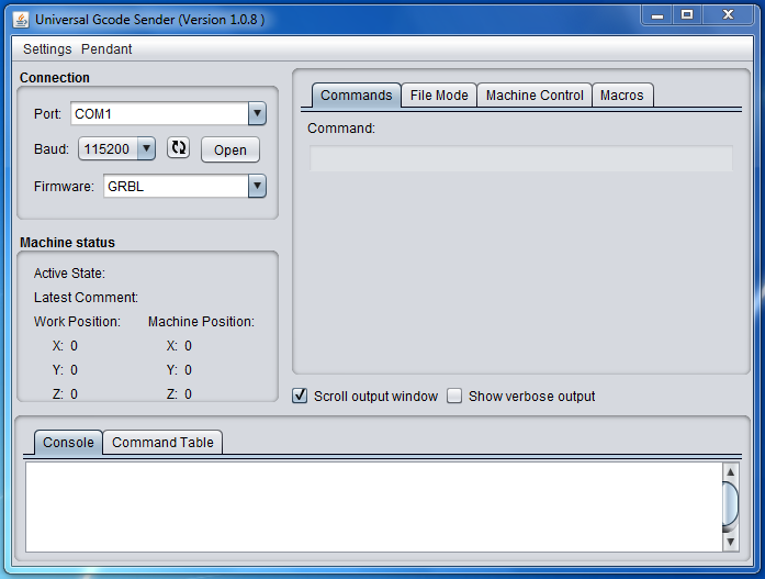

GRBL Configuration & G-code streaming

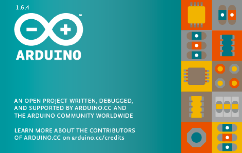

1. Arduino IDE
GRBL LIBRARY :- Click here to download

3. UNIVERSAL G-CODE SENDER : - Click here to download

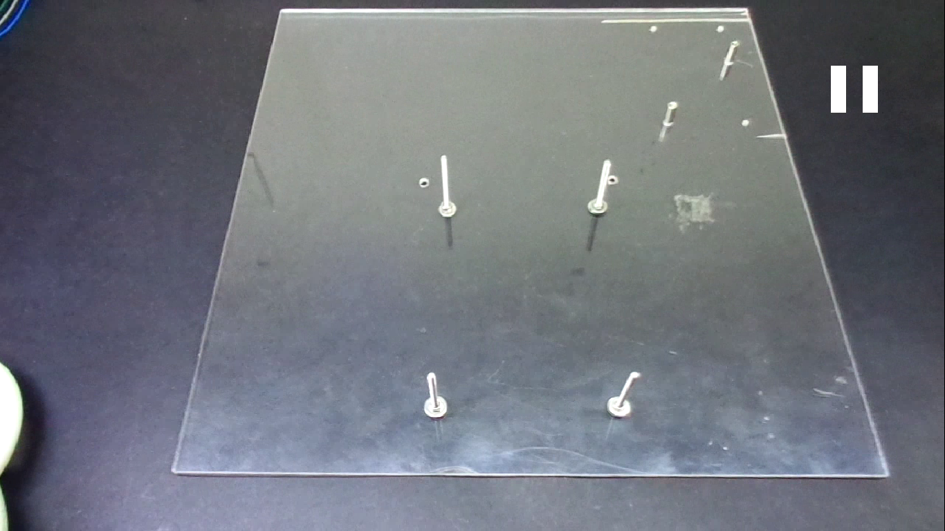

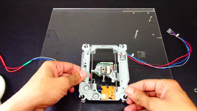

- Place X-axis Horizontally on the bolt mounted on acrylic sheet
- Four bolt mounted on a metal sheet to fit Y-axis on it
- Now place the Pen up down holder on y axis whit the help of A bolt through the center
- Now place Y-axis on metal sheet and place it vertically on X-axis
- Now fit servo motor so that it will move z-axis which is our pen up and down
- Now mount CNC shield on Ardunino
- Do wiring A shown in wiring circuit as in Next step
For better understand please watch Video & pic attached here
