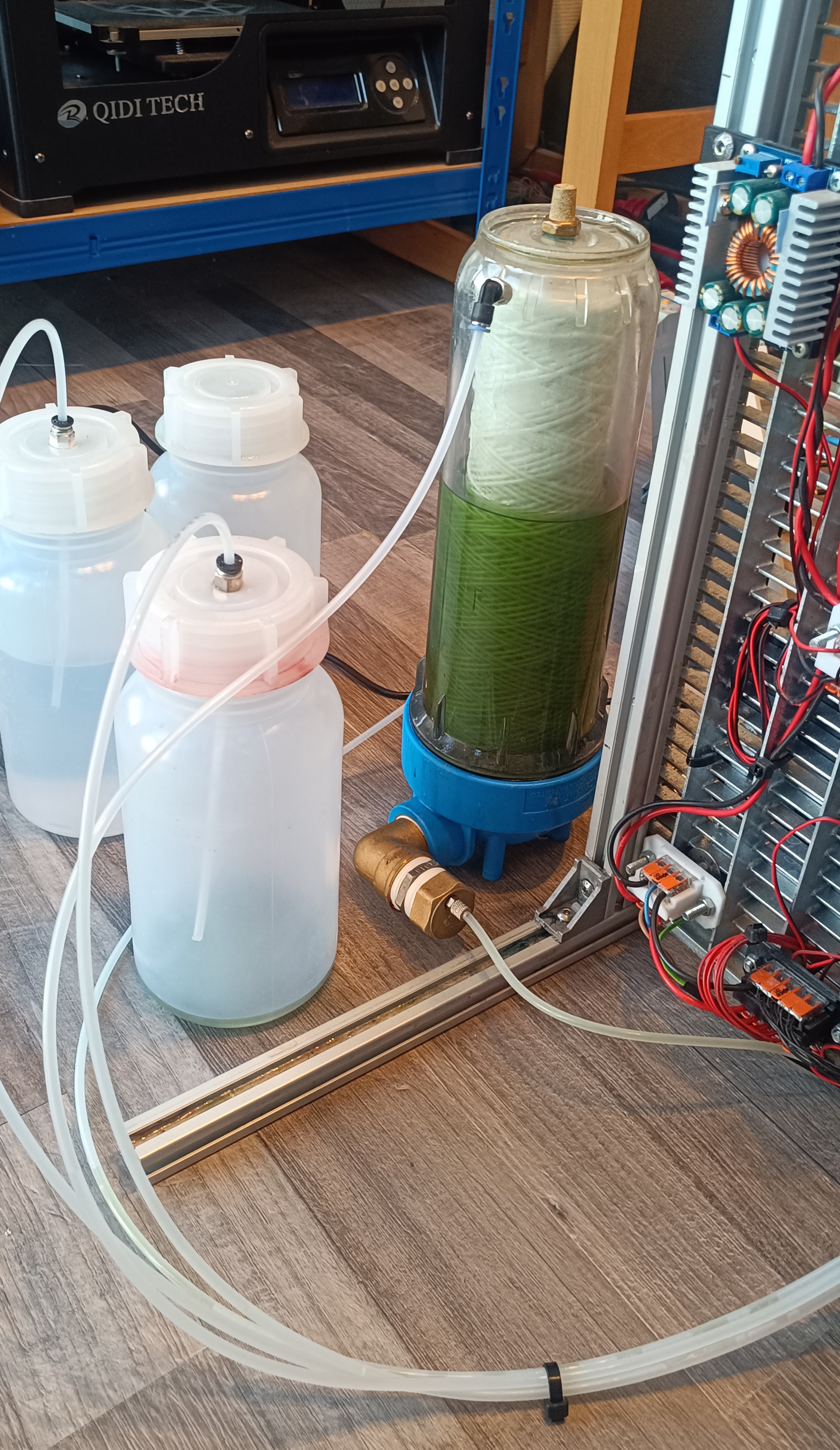

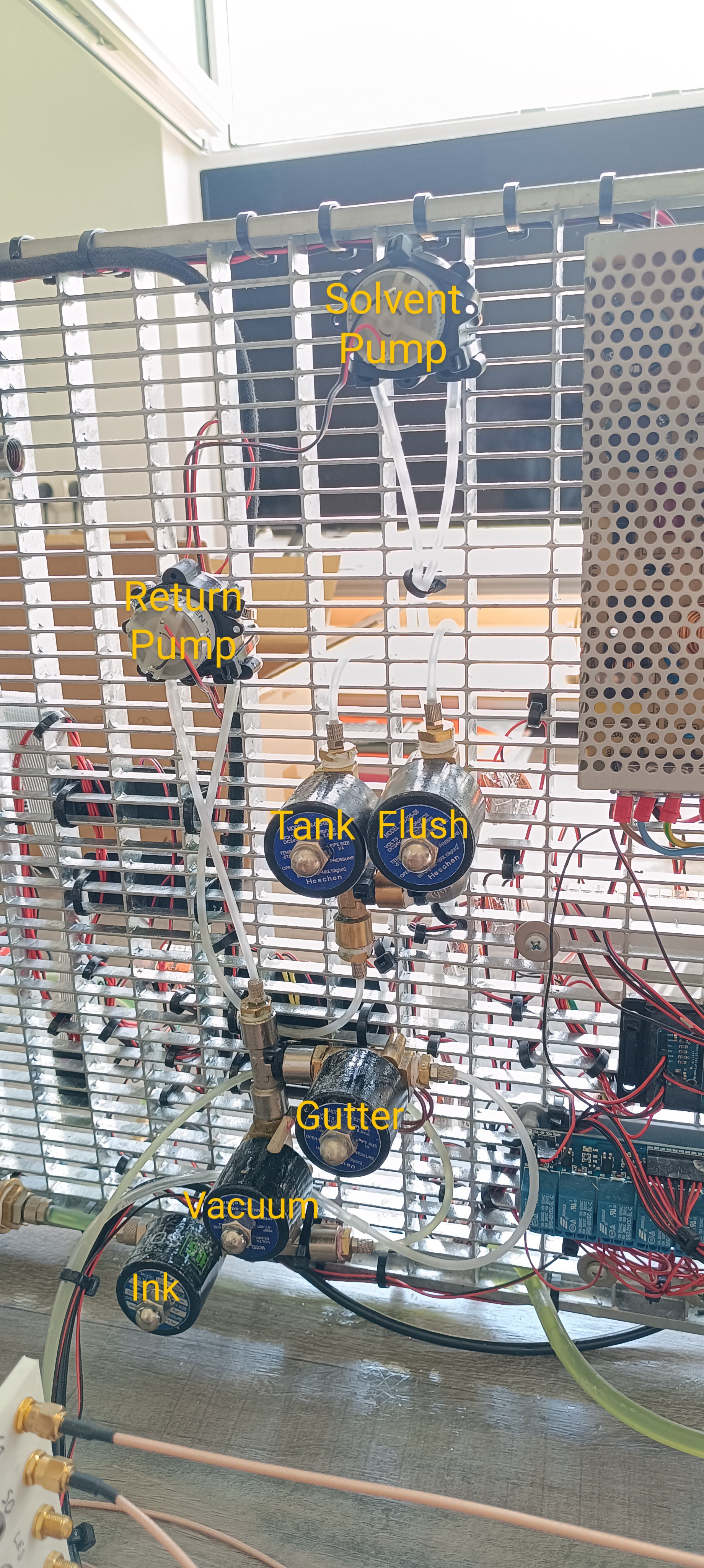

The pressure pump's outlet is connected to the fluid system to pressurize the ink pressure line.
When it first enters the system a relief valve is used to limit the pressure to 50 psi. The relief valve works by adjusting the flow from it back to the tank for keeping the pressure steady.
When I installed the new pressure pump, I realized that the relief valve's return path could be used for ink circulation on its own so that the peristaltic pump I installed before to replace the brushless pump could be removed.
So, I changed the plumbing that the ink leaving the relief valve passes by the system temperature sensor and TDS sensor before flowing back into the tank. Now the line that leads back to the tank is located at the bottom of the frame instead at the top as it was before.
The return line is now a 4mm PE line instead of an 8mm PE line since the flow is lower than it was with the brushless pump. The NBR line from the pressure pump is a 7x3mm fuel line. The silicone tube that leads to the pressure pump had to be an 8mm tube because when the inlet flow to the pump is restricted, the pump wouldn't run properly and would make a lot of noise.
Individual groups of fittings are connected by an 8mm tube to give the connection a bit more stability.
My goal was to use a 4mm PE tube wherever I could and only use other tube diameters where it was absolutely necessary.
Maybe later on, with a more compact design, it would be possible to use even fewer tubes.
Here are a few pictures of the new plumbing:
Pressure Pump with Silicone Tube and NBR Tube
New Return Line at the Bottom
Ink Tank with 10 micron Filter, Flush Bottle and Solvent Bottle
Ink Tank with Silicone Tube leading to the Pressure Pump
From Top to Bottom: Solvent Pump, Return Pump, Tank/Flush Valves, Gutter Valve, Vacuum Valve, Ink Valve

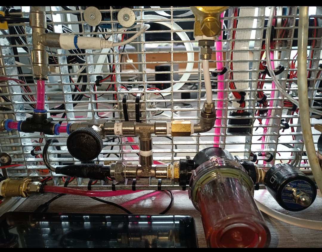

Here you can see how it looked before:
Falling Ball Viscosimeter
And here you can see how it looks now:
New Plumbing without the Viscosimeter

After removing the external pumps and damper, I got a new damper that I could connect to the position of the old filter, which actually also acted as some sort of damper with the air bubble inside of it getting compressed and expanding again.
Old Filter
With the new damper and new pump the only external parts of the fluid system were the ink tank and bottles, which will likely stay external in the future.
New Damper
