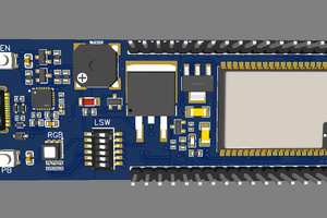

  • 1 × ESP32 Developement Board.
  • 4 × TP233 Touch Modules
  • 4 × 47pF Ceramic Capacitors
  • 1 × 0.96 inch OLED Display
  • 1 × Wires
View all 6 components
