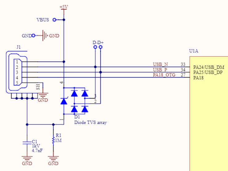

4[Interface 3] HID Keyboard
Unlike an Arduino Uno, USB port on MKR 1010 is connected directly to the main micro controller. This feature, also present on Teensy or Arduino Leonardo, offers the possibility to use USB-HID implementation. This allows your project to behave like a keyboard or a mouse.
UNO Board use a second micro controller (Atmega32u2) to transmit data. We can't use USB HID without modification on the 32u2.
Here is Arduino MKR 1010 Schematic :
In our case, we will be able to use this specification to send keyboard commands directly to a computer to manage different functions (volumes, movie pause, next episode shortcut...).
Another interesting feature is the presence of PA18 on the 4th PIN of the USB OTG. The activation of this PIN should allow us to reverse the USB master/slave behavior.
After a first test on last version of SAMD library (1.8.6) for MKR 1010. The keyboard wasn't working.It was recognised as a COMport... I found this tutorial explaining that if you downgrade to version 1.6.21 it will work. And it's true :-) But it work great on Teensy board !

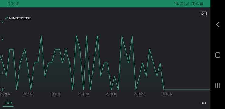

5[Interface 4] [MKR 1010 only] Wifi Synchronisation with Blynk for Person Counter
To facilitate this part, I used the BLYNK environment to manage the display of data on smartphone. (not possible on Teensy or UNO if you don't add a Wifi board). Blynk allows you to connect a module to a web interface or an application with great ease.
With a limited number of lines of code, one or more objects can be connected to a graphical user interface. It can be used on IOS or Android via a simple TOKEN exchange that will allow to make the link between application and objects.
In WIFI mode, we configure the VL53L1X to extend its range to 4 meters and count the number of people passing in front of it. If it detects movement to the left, it will send a notification to decrement the number of people and the opposite to the right. Thus, with a flow respecting 1 meter of regulatory distance, the BLYNK interface will indicate in real time the number of people inside a room.
This application can also be used with several GH to monitor several inputs/outputs. Here is an example :
