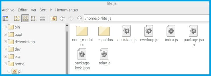

This step will go show you how to setup a MATRIX Lite project with Snips.
First, MQTT must be installed and used to listen in on events from Snips.
npm install mqtt --save
assistant.js will be used to listen and respond to events from your Snips assistant. This file combines all the code from everloop.js & relay.js to control the everloop and relay switch through voice.

 everloop.js incorporates the code required to control the LEDs on the MATRIX Creator.

relay.js includes the code required to turn the robotic arm here and there. This relay will control power to the robotic arm.

 Copy and paste this files into the /home/pi/lite_js folder of your Raspberry Pi board. You can download this files on the "Code" section.
