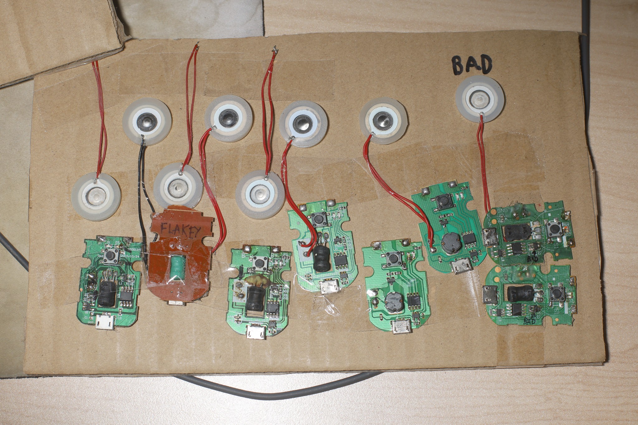

    Finally recycled all the parts.  There wasn't any place to store most of the parts, but there was a desire to see the entire weather wall again.  A lot of time was spent developing the algorithm to sense the LED & emulate button presses to keep the 3 transducers alive.  Doing all 3 on a single microcontroller was a GPIO abstraction buster.
    Stored a batch of transducers in various states of disrepair.  They were a big thing for a while.  Then the world discovered how humid it really was, how much scale they deposited, how unreliable they were.  Hard to find any redeeming qualities now.  There have been other big misses.  Something like this, 20 years ago, would have consumed years of effort.  3D printing & development tools cut most of the development down to manely July of 2021.  There was another big push in Sep of 2022.

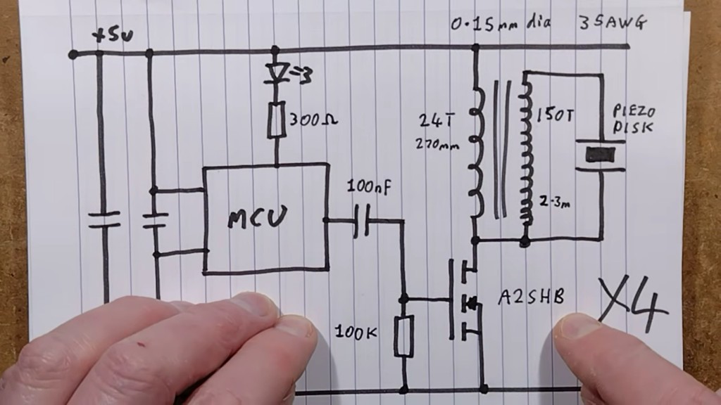

  • Schematic
    lion mclionhead04/15/2025 at 04:37 0 comments
    Clive identified the flyback transistors which keep burning out as A2SHB
    There have been transducer arrays, but nothing which includes a decent reservoir.  You're still in need of a small reservoir on a desk with a water level sensor & pump from a bigger reservoir on the floor.

    The 1st thing to go was the pump.  Another tube perished after a year.  Instead of drawing air in, it was letting water out.  It appeared as a small puddle & grew over the next day until the desk was a waterfall.  Expensive stuff got soaked.  Those are going to have to be preventatively replaced every year.
    Then a transducer died.  Tried to revive it by unplugging it but forgot this causes the flyback transistors to overload.  The magic smoke came out & it was dead.  It wasn't the 1st fried board.
    There's an inventory of spare electronicals because they tend to die randomly.  Got rid of the molex connectors so the transducers can't be unplugged.    This transducer might have gotten silicone grease in its intake.
