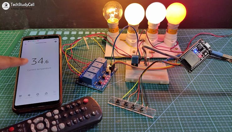

Alexa Control Relay Using ESP32:
You can control the home appliances from Amazon Alexa App and also monitor the room temperature if the ESP32 is connected with Wi-Fi.
You can also ask Alexa to turn on and off the appliances from anywhere in the world.
You don't need any Echo DOT or other Alexa devices for this home automation project.
ESP32 Control Relays With Arduino IoT Cloud Dashboard:
You can also monitor the room temperature and control the home appliances from the Arduino IoT Cloud web dashboard and Arduino IoT Cloud Remote mobile app if the ESP32 is connected with WiFi.
In this project, I have used the FREE plan of Arduino IoT Cloud. In the FREE plan, you can control a maximum of 5 relays or sensors.
When you control the relays from the Arduino IoT Cloud Remote mobile app the current state of the relay is also updated in the Amazon Alexa App.

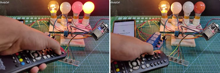

IR Remote Control Relays Using ESP32:
You can always control the relays from any IR remote.
I will explain how to get the IR codes (HEX codes) from any remote in the following steps.
And if the ESP32 is connected with Wi-Fi, then you can also monitor the real-time feedback in the Amazon Alexa App & Arduino cloud dashboard.
