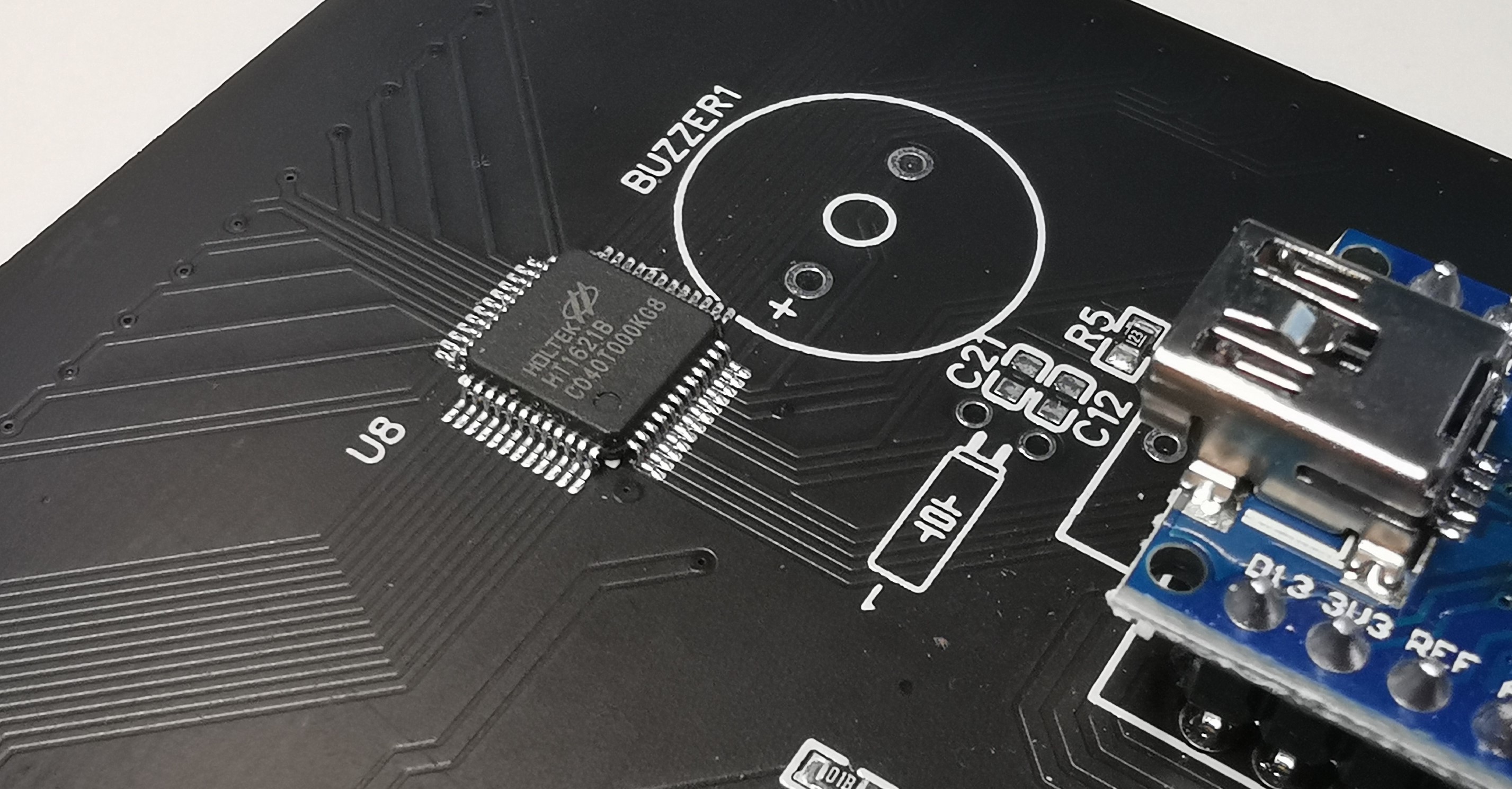

    So, I hacked together a breakout board for a display driver. The HOLTEK HT1621B is easily available, cheap and even can be assembled by JLCPCB.
    An Arduino Nano makes it really easy to interface the HT1621B via I2C.
    The HT1621 library provides a simple interface to send data to the RAM of the chip.
