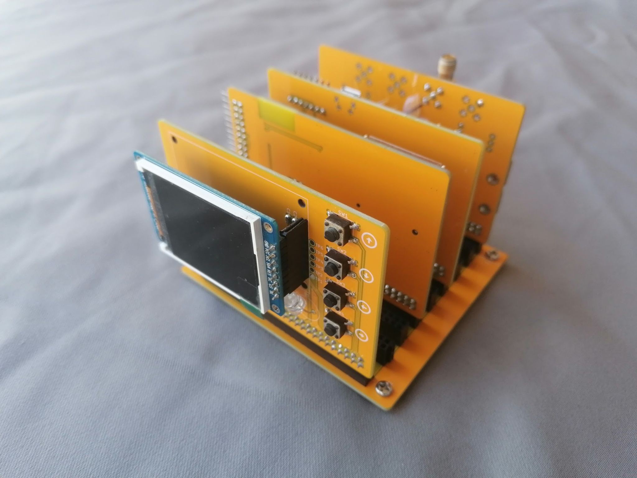

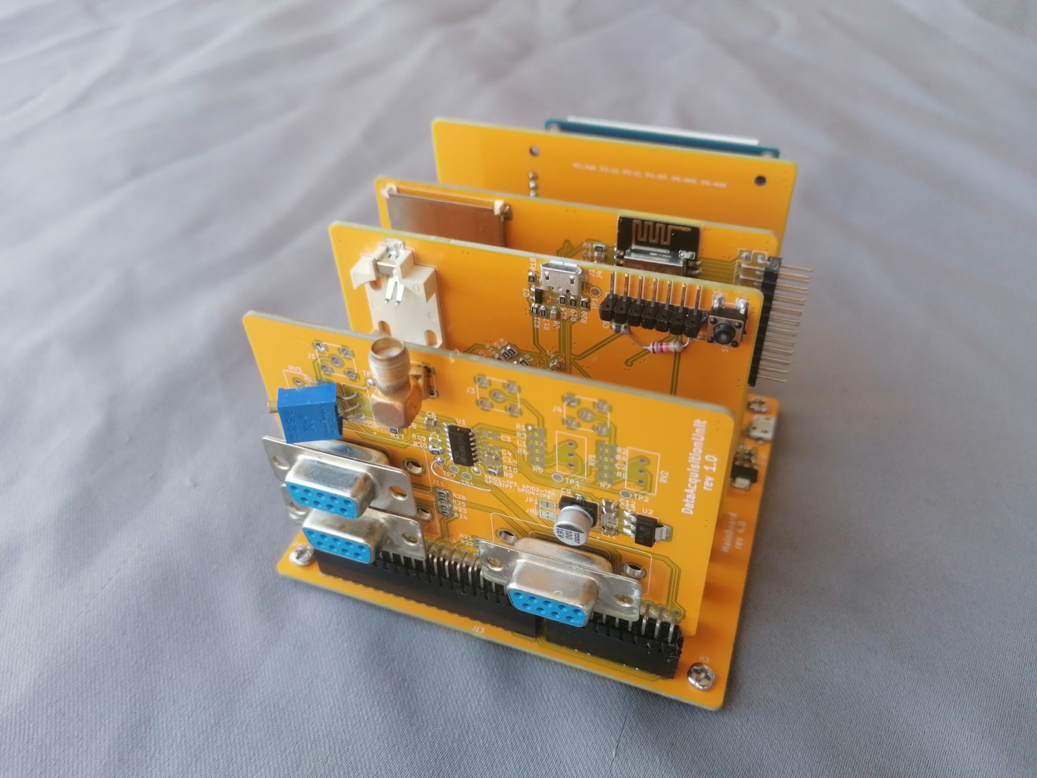

The idea is to have a mainboard with parallel slots where cards can be placed. These cards can serve various purposes, such as including microcontrollers, sensors, storage, or other functionalities as needed.
Mainboard serves as a base to dispatch all the signals to other boards; currently, there are:
  • A card for data processing with an STM32F103RBTx chip [circuit].
  • A module for storing data on an SD card and transferring it via WiFi (ESP32-WROOM-32E) to other devices, such as a Raspberry Pi [circuit].
  • An acquisition card with four pulse counter inputs and three UART sockets [circuit].
  • A user communication module with an LCD and four push buttons; the LCD adjusts its brightness based on ambient light [circuit].
On the mainboard, slots are available for almost all of the STM32F103RBTx pins (GPIO, I2C, SPI, CAN, etc.), so it is easy and possible to use them when developing new cards.

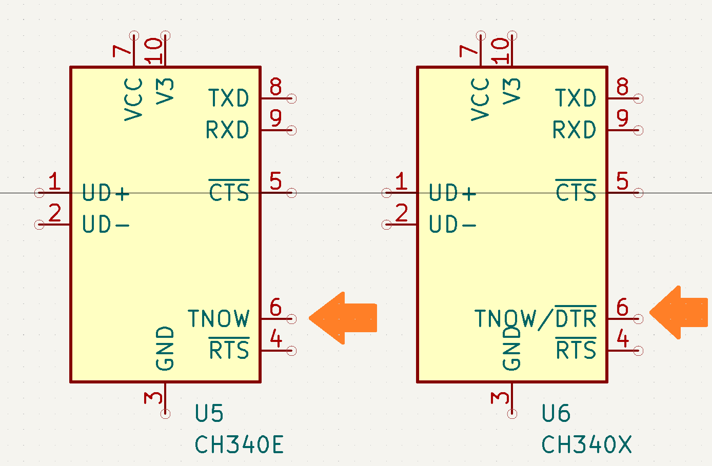

  • I ordered the wrong CH340 chip, but it still kind of works.
    Robert Gawron • 01/21/2026 at 12:41 • 0 comments
    CH340s are cheap Chinese USB-to-UART chips that are, well… cheap and easy to solder. They come in various variants, where the last letter indicates which exact variant it is (CH340B, CH340C, CH340G, CH340E, CH340R, CH340T). I bought one to make an onboard programmer for an ESP chip here. 20 pieces for 7 euro was a good deal!.

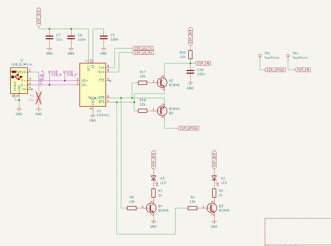

    To make a programmer fully automated (no need to push buttons), we need UART and two pins to drive ENA and GPIO0 of the ESP module. The trick is that UART chips have RST and DTR lines that can be connected to those pins on the ESP and then driven by the flashing tool on the host PC.
    So far, so cool - except that I bought a CH340E, and it’s the only one in the family that doesn’t have a DTR pin :P
    So I have to push a pin on the board manually to flash the device (at least only one, because the RST pin is there and that part works fine).
    In the next revision I will use CH340X and follow this tutorial  - it seems that with this version there is no need for extra transistors logic (but I will left place for them on the PCB anyway)
    Nevertheless, the programmer is working - just not in a fully automated way. So for a first try, I’m kind of okay with it.

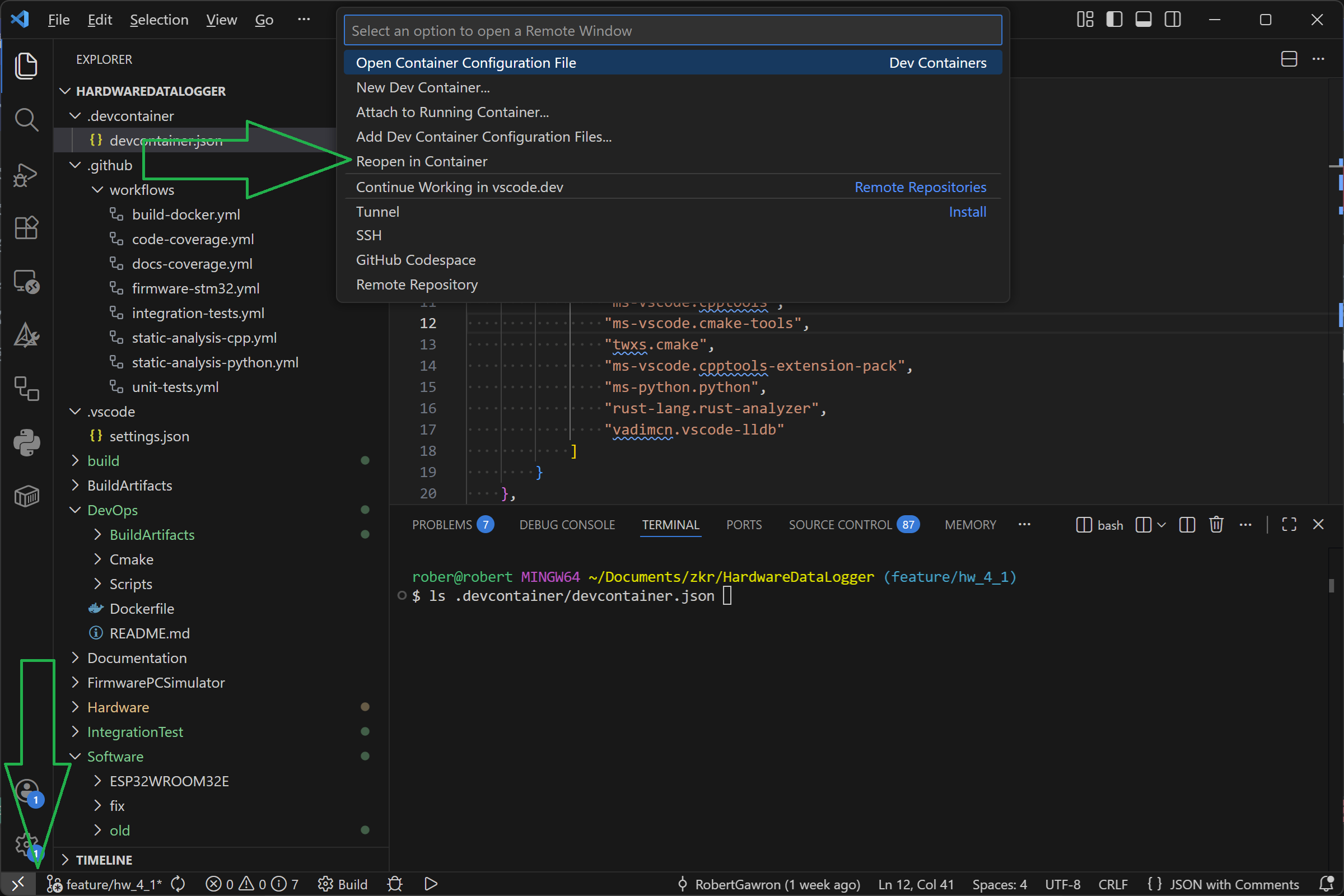

  • ​Flashing and debugging STM directly from a docker container makes setup easier.
    Robert Gawron • 01/18/2026 at 18:52 • 1 comment
     I have tried to use docker heavily to make automatic setup of tests etc., but there was still one and most important thing that I couldn't do - at the end of the day it's an embedded project and the chip needs to be flashed, debugged, etc. Configuring this from Docker to be easily clickable from VS Code seemed hard. Also there is a need to access physical devices (USB based programmers for STM/ESP chips) from the docker image which seemed hard too.
    Finally I made it possible and this post is about this.
    Pros
    • Installation of all tools is automated, no need to manually install on a host PC a compiler, tools to debug, flash, etc.
    • No conflicts between versions of toolchain between different projects, all is inside a Docker container. No error-prone environment variables etc.
    Cons
    • At the startup of VS Code one needs to click to switch to docker container in Visual Studio Code, it's annoying.
    • When using USB devices (here it's ST Link programmer for example) they need to be mapped to Docker image each time they are plugged in. I've just bought a cheap USB hub to have many USB sockets to avoid the need to disconnect the device.
    tl;dr - is it worth it? I would say 50:50.
    Now let's get to details, we will need:
    • Docker desktop
    • Visual Studio Code
    This manual is for Windows. While docker in theory hides host OS specific subjects... well not always. When dealing with hardware or for example line endings, we will have host OS specific issues.

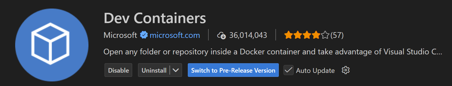

    We need to have Docker desktop running, then we install in VS Code the "Dev Container" extension.
    Now we need in the root directory of the project to add this configuration: .devcontainer/devcontainer.json
        "name": "STM32 Logger Development",
            "dockerComposeFile": "../docker-compose.yml",
        "service": "dev",
        "workspaceFolder": "/workspace",
            "customizations": {
            "vscode": {
                "extensions": [
                    "ms-vscode.cpptools",
                    "ms-vscode.cmake-tools",
                    "twxs.cmake",
                    "ms-vscode.cpptools-extension-pack",
                    "ms-python.python",
                    "rust-lang.rust-analyzer",
                    "vadimcn.vscode-lldb"
            "postCreateCommand": "echo 'Dev container ready! Open HardwareDataLogger.code-workspace'",
            "shutdownAction": "stopCompose",
            "containerEnv": {
            "DISPLAY": ":0",
            "WAYLAND_DISPLAY": "wayland-0",
            "XDG_RUNTIME_DIR": "/mnt/wslg/runtime-dir",
            "PULSE_SERVER": "/mnt/wslg/PulseServer",
            "QT_X11_NO_MITSHM": "1",
            "QT_QPA_PLATFORM": "xcb"
    This will tell the "Docker Container" extension which docker image we want to build (note the location of the .yaml file, service and workspace - those are the important things, the rest is not very important).
    Now we can restart VS Code and click on the icon "><" in bottom right and from the palette on the upper center select "Reopen in Container". The VS Code will restart.
    We are now running VS Code inside the container, meaning when we build, flash, debug, etc. we are using toolchain from the docker, not from host PC. The configuration of toolchain to debug, flash, etc. is as usual in VS Code (at least I think - I still learn it so I will not post about it for now, I'm still trying to make...

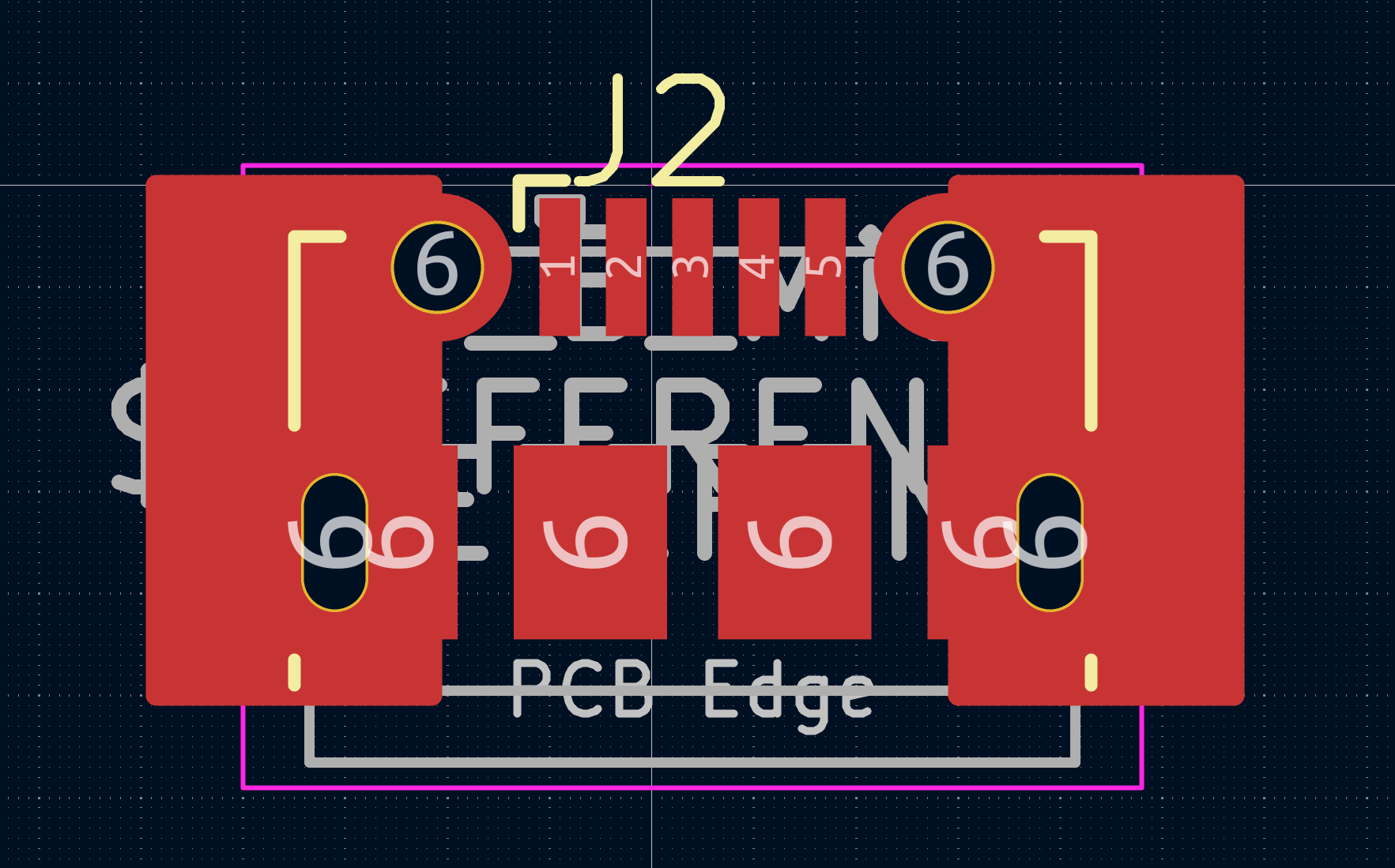

    First, the USB connector used for the power supply ripped off, and I don't have a soldering iron here, so the device doesn’t work. lol. The thing is, micro USB is small, its pads are small (mostly surface-mounted), but the forces when the cable is plugged, unplugged, or moved are huge.
    The fix is to make much bigger pads for soldering the shield of the connector, so the mechanical stress is better dissipated. This is shown in the image below (original USB connector from KiCad libraries vs. the new one I made).

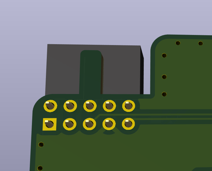

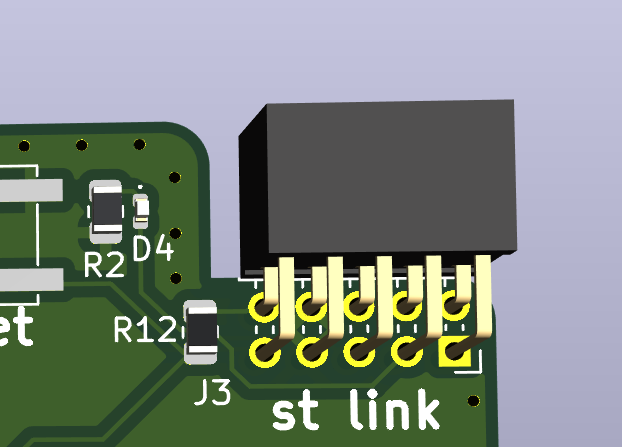

    Second, I added a proper STLINK connector to the PCB. In the previous version, I just added a pin header but didn't care which pin was which, so I later had to use wires to connect the device to the programmer. It was annoying and looked lame. BTW, I also added a dent so the STLINK can only be inserted the right way.
    The STM chip on the device always uses its own power supply; it's not powered from the STLINK. In case that could be a problem (I don't think so, but who knows-I have a cheap STLINK clone), I added an LED on my PCB between the STLINK's 3V3 and GND. It’s used to simulate the STM’s power consumption and as an indicator that the STLINK is connected.
    Third, I switched the ESP. It's no longer an ESP8266 but an ESP32-WROOM-32E. This is because I want to write its code in Rust, and Rust doesn't support the ESP8266 as it's an old chip.
    To make flashing the ESP easier (as with the STM, wires are error-prone), I've added on the board a USB programmer for the ESP. It's based on the CH340X, which I find very cool because it's much cheaper than an FTDI chip and easy to get in an easy-to-solder package. An extra feature I added is two LEDs to show the state of RST and GPIO0 - this should be helpful for debugging whether the flashing is working at all.
    he circuit is as bellow, it's not tested.

  • Assembling hardware version 4.0
    Robert Gawron • 06/28/2025 at 10:32 • 0 comments
    It's been a long time since I posted anything here, but I've started building the new version. While the software remains the same, the new hardware is built in a modular way. There's a main board with multiple parallel slots (each one is identical) and cards that can be plugged into it.
    The cards are:
    • CPU: STM32 board with some minimal peripherals
    • Storage: ESP32 that will send data outside, SD card slot
    • Acquisition: BNC connectors, UART connectors
    • HMI: display, keyboard, phototransistor to detect how much to dim the display at night
    The idea is that, in this way:
    • if one part needs changes or redesign, the other parts can still be used
    • new boards can be added in the future
    • PCB manufacturing in China is so cheap these days that it's economically reasonable
