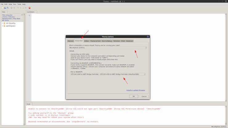

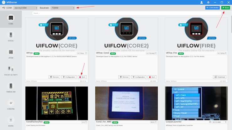

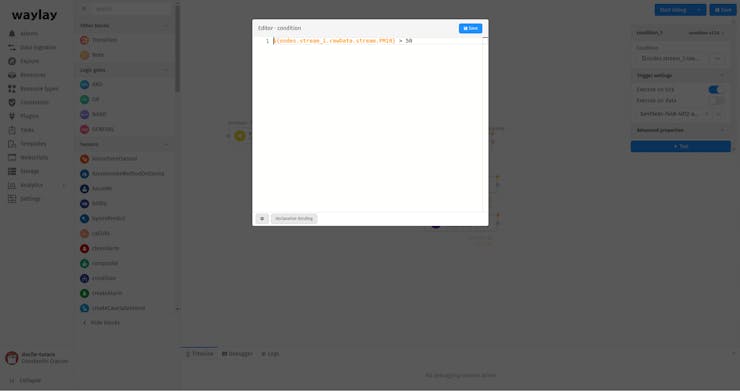

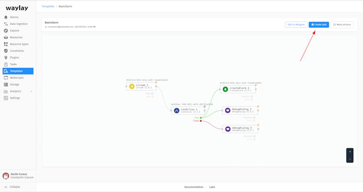

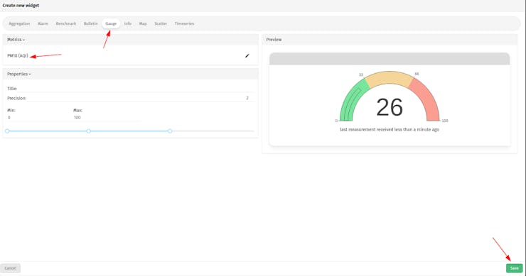

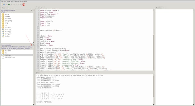

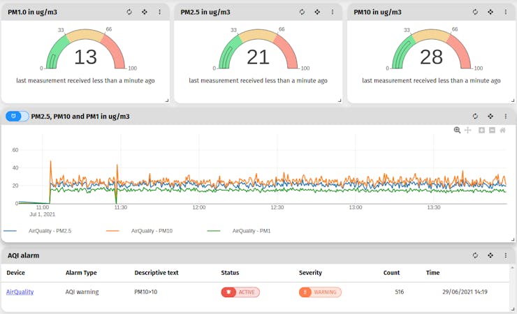

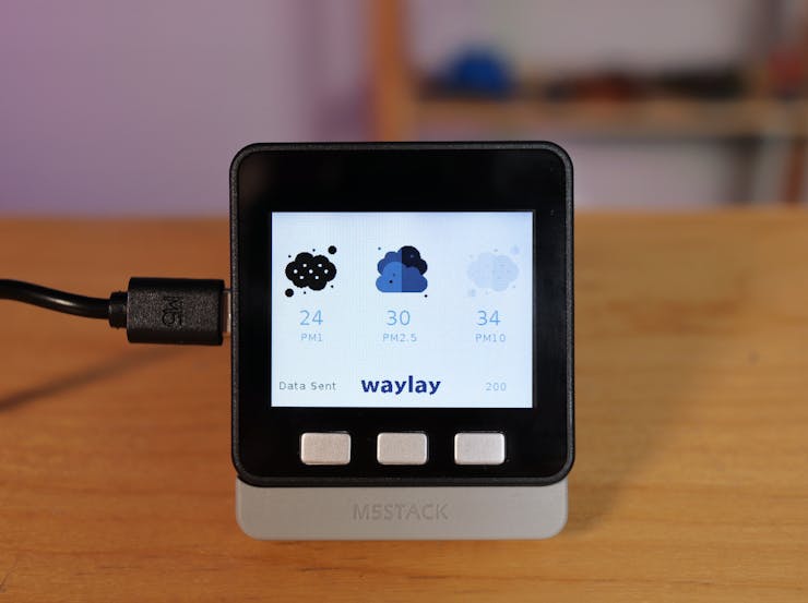

1Prerequisites
We have picked the M5Stack Air Quality Kit based on the PMSA003 Digital laser dust sensor for this application. The M5Stack ecosystem is based on the ESP32 SoC and is beautifully integrated with a big enough screen for a User Interface.
- Install M5Burner according to your OS.
![M5Burner]()
- Install Thonny following the steps on the official website.
![Thonny Python IDE]()
2Setting up the device
- Connect the M5Stack kit to your PC using the provided USB Type-C cable.
- Launch M5Burner, download the UIFlow(CORE). Click the Erase button, wait for it to finish, and then press the Burn button to upload the UIFlow(CORE) firmware on the device. We have used 1.8.1_en. You will be prompted for the WiFi details that the device will use to connect to your local network. If the burn fails, change the baud rate to a lower one.
On Linux, make sure your user is part of the dialout group by running:
sudo adduser $USER dialout
![M5Burner interface]()
- The device will be programmed and you will be greeted by a series of screens showcasing the available features.
- All is well. Now let's set up the cloud solution!
3Setting up the cloud solution
Register on Waylay IO if you have not already and log in.
- Go to Resources and add a resource. Name it something like
AirQuality. This resource is practically your device representation in the cloud where you will send the data. - Add a new property with the
customerkey and theZalmotekvalue. - Add another property with the
tagskey and the[ "AirQualityMonitor" ]value.
![Creating a resource on Waylay IO]()
- Go to Webscripts in the left main menu and add a new one. Name it something like
AirQualityIngestionand add the following details in the body:async function handleRequest (req, res) { if (!req.body) { // No body found return } // Parse body if needed let payload = req.body if (typeof payload === 'string' || payload instanceof String) payload = JSON.parse(payload) /* You can do some processing of the payload over here. */ // Post values to our resource waylay.data.baseUrl = 'https://data-io.waylay.io' await waylay.data.postSeries('replace_with_resource_id', payload, { store: true, forward: true }) .catch(e => console.error(e.message)) res.sendStatus(200) }
Be sure to replace the
replace_with_resource_idplaceholder with the actualresource_idfrom the above step. Navigate to the resource page to get it. Ours is something like453472c9-8553-4b12-b24f-fc6e052e8255. Press Save once you have pasted the correct details. - Go to Resources and add a resource. Name it something like
4Programming the device
- Go to the GitHub repository of this project (also present in the Code block of this tutorial) and download the zip file containing all necessary code and unpack it in a folder (or use the git command-line interface to do the same thing like a pro).
- Launch Thonny and from Run -> Select interpreter set up the interpreter to MicroPython (ESP32) and while at it pick the device port.
![Thonny interface - selecting the interpreter]()
- Make sure the M5Stack is connected and displaying the API screen (or with the hello world program open), click on the Shell text field and press CTRL+C or press the STOP button to connect to the device. Once you see the >>> symbol, you can access the files on the device. Go to View and select Files to set up your workspace. Then go to the
temp.pyfile provided in this tutorial (check the Github Repository link in the Code section below) and edit the URL in theSendPOST()function with the URL of your Webscript. You can find it on https://console-io.waylay.io/webscripts, below the name of your Webscript. Click it to copy it to the clipboard (make sure the secret is included). - Select all the files from the folder downloaded from GitHub by holding Shift and clicking the files (
main.py, and the 2 folderscustom,res, files provided in this tutorial, exclude the Readme file, right-click on the menu icon (3 horizontal lines as shown below) and press Upload to /flash, press ok and you are set. Confirm the files being overwritten.
- Reboot the M5Stack by pressing the side button and the app should start automatically after connecting to your WiFi.
- When the device successfully sends the data to the server you will get a
Data sentmessage on the bottom-left side of the display and the200HTTP status code on the bottom-right side of the display (meaning the request was successfully received, understood, and accepted).
![Air quality monitoring using M5Stack and Waylay IO]()
5Setting up an alarm
Alarms are a useful feature that helps you avoid strutting down the street when the air quality levels reach a dangerous level.
- Select the Templates field from your user console and click on the Add Template button.
- To create a basic alarm flow, we will be adding the necessary blocks from the blocks menu and then configure them. Add a Stream block, uncheck execute on tick and check execute on data, then select your Resource of choice.
- Add a Condition block, uncheck execute on tick and check execute on data, then select your Resource of choice. In the condition field write up the condition in the following format:
${nodes.stream_1.rawData.stream.replace_with_your_metric}- In our example, the metrics you can choose from are the ones defined in the
DataMapvariable intemp.py(PM1,PM2_5,PM10). Our condition looks like this:
${nodes.stream_1.rawData.stream.replace_with_your_metric} > 50![Setting the alarm condition on Waylay IO]()
- Add a Create Alarm block, uncheck execute on tick and check execute on data, and select your Resource of choice. Also fill in your alarm text, your desired alarm type (CRITICAL, MAJOR, MINOR, or WARNING), and create an alarm type.
![Creating an alarm on Waylay IO]()
- Click on the Save button and choose a name for your template.
- Now that you have returned to the Templates menu, select the previously created template and click on Create Task.
![Creating a task on Waylay IO]()
- Choose a name for your task, select the Resource choosing Reactive mode and click on Create Task.
![Creating a task on Waylay IO]()
- Now the Task is created and when the condition is met, an alarm will be triggered and it will be displayed in the Alarms field of your console and also in your dashboard linked to the same Resource as the Alarm.
6Creating a dashboard
Now that we managed to consistently send data to our cloud solution, it’s time to set up a neat-looking dashboard to display it.
- Head to dashboard-io.waylay.io/ and log in with your account data.
- Create an organization by clicking on the + sign. The name of this organization must be identical to the customer name (metadata property) you have used when defining your Resource.
- Click on Log in as admin.
- Click on the + sign, click on Query, and in the
tagfield fill in the value of thetagsproperty you have picked for your Resource.
![Creating a dashboard on Waylay IO]()
- Name your group and finally click on Create group.
- Click on the + sign next to My dashboard and select the desired representation, select the metric you want to represent and then click Save.
- For this use-case, we have settled for Gauge widgets to represent the momentary value of PM1.0, PM2.5 and PM10 in ug/m3 and a Scatterplot widget to represent the evolution of the mentioned parameters in time. Moreover, we have added an Alarm widget so we can monitor the latest alarms.
![Creating a dashboard on Waylay IO]()
- After adding all widgets, click on the cogwheel next to the + sign and then click Publish.
- Click on My dashboard and select your dashboard (notice that the + sign disappears), click on the cogwheel, click on Manage and then select Public.
- Now, by clicking on the connectivity button, you can get the link for your public dashboard to share with your friends or to access it from any browser (like this cool one).
![Dashboards on Waylay IO]()
7What’s next?
We have a series of tutorials with other use cases that you could learn from and further sharpen your IoT skills or you could start your very own project.
If you need help in deploying this solution or building something similar please contact Waylay.io for the low-code IoT Solution or Zalmotek.com for IoT-enabled hardware prototypes.
If you have any further questions, reach out to us via the comments!
Zalmotek
Become a Hackaday.io Member
