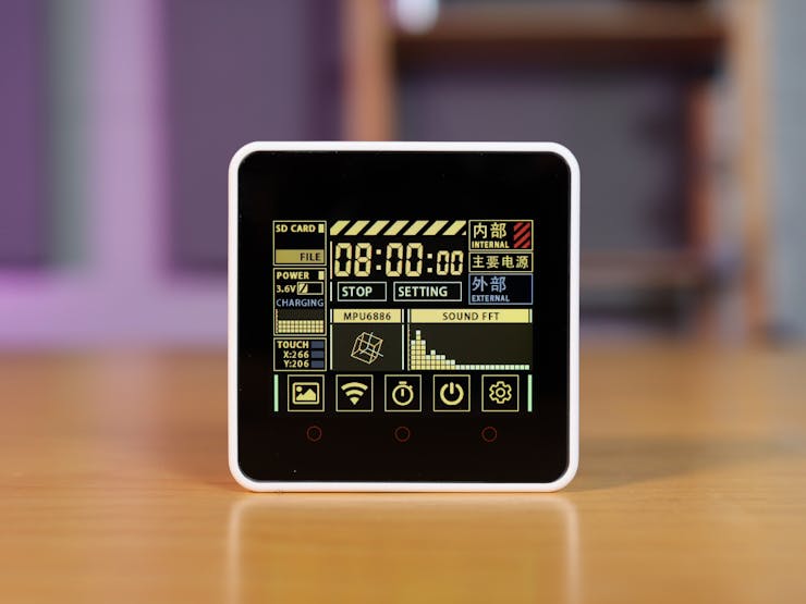

For this tutorial, we have decided to use the M5Stack Ecosystem because it offers the possibility of building such a system without prototyping specific tools, such as a soldering iron or prototyping cables. The ”heart” of this project is the M5Core2, an IoT development kit based on the ESP32 microcontroller. This ecosystem allows you to connect the provided modules through a GROVE port to the M5Core2, allowing fast deployment of hardware.
M5Core2

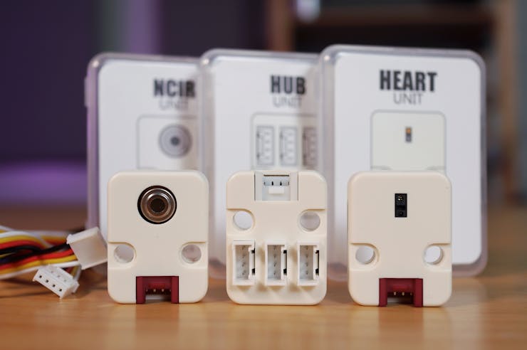

To showcase the use of IoT in Healthcare monitoring, we have picked the Mini Heat Rate Unit, based on the MAX30100 chip, with the possibility to measure the oxygen saturation in the blood and the heart rate of the patient. Another key parameter for an organism’s homeostasis is the temperature, which we have decided to record using a Non-Contact Infrared Thermometer Unit, based on the MLX90614 sensor. It allows the user to measure the surface temperature of the human body without having to touch them physically. If you want to read both sensors at the same time even if you trigger them separately you must use a 1 to 3 HUB Expansion Unit to connect both of them to the M5Core2.
Non-Contact Infrared Thermometer Unit, 1 to 3 HUB Expansion Unit, and Mini Heart Rate Unit
Wire connections
- Connect the 1 to 3 HUB Expansion Unit to PORT A of the M5Core2 (the red port near the USB-C connector) using the Grove cable.
- Connect the Mini Heat Rate Unit and the Non-Contact Infrared Thermometer Unit to the HUB Expansion Unit.

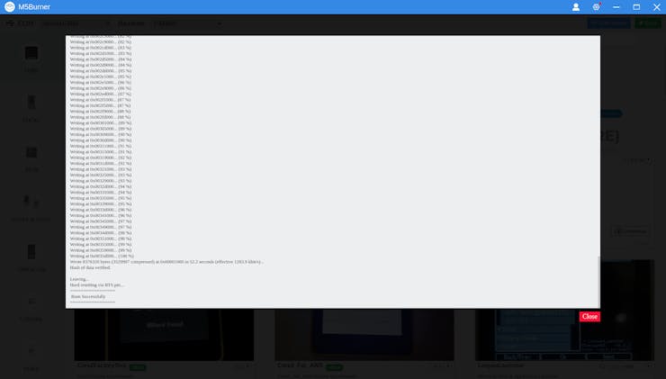

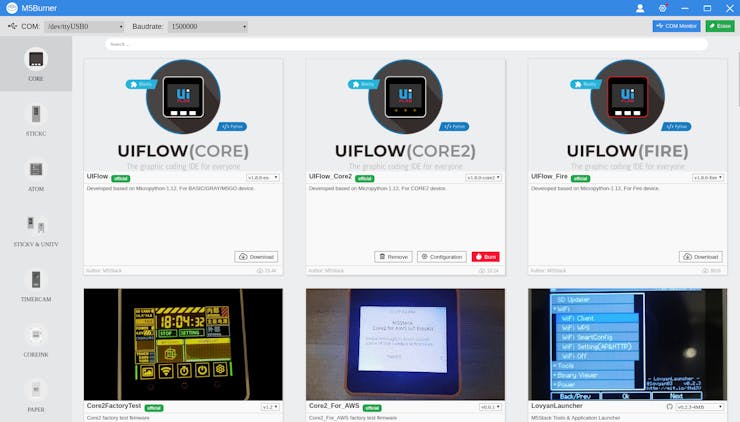

M5Burner
- Launch M5Burner and download the UIFlow(CORE2). Click the Erase button, wait for it to finish, and then press the Burn button to upload the UIFlow(CORE2) firmware on the device. We have used 1.8.1_core2. You will be prompted for the WiFi details that the device will use to connect to your local network. If the burn fails, change the baud rate to a lower one.
M5Burner

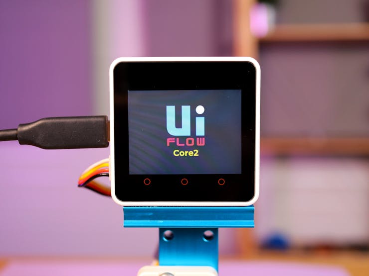

- Now click on the Configuration box corresponding to UIFlow(Core2) and select App Mode from the dropdown in the provided screen and add the Wifi details if not present.
- After it finished rebooting, you will be greeted by an initial screen with the UiFlow version in the top right.

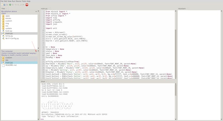

- Go to the GitHub repository of this project (also present in the Code block of this tutorial) and download the zip file containing all necessary code and unpack it in a folder (or use the git command-line interface to do the same thing like a pro).
- Launch Thonny and from Run -> Select interpreter set up the interpreter to MicroPython (ESP32) and while at it pick the device port.
- Make sure the M5Stack is connected and displaying the initial screen, click on the Shell text field and press CTRL+C a few times or press on the STOP button to connect to the device. Once you see the >> symbol, you can access the files on the device. Go to View and select Files to set up your workspace. Navigate to the folder that you have unpacked at the first step. Then go to the
main.py
file provided in this tutorial and edit the URL in theSendPOST()
function with the URL of your Webscript. You can find it on https://console-io.waylay.io/webscripts, below the name of your Webscript. Click it to copy it to the clipboard (make sure the secret is included). - Select all the files from the folder downloaded from GitHub by holding Shift and clicking the files (
main.py
, and the 2 folders:custom
,res
, files provided in this tutorial). Exclude the Readme file, right-click on the menu icon (3 horizontal lines as shown below) and press Upload to /flash, press ok and you are set. Confirm the files being overwritten.

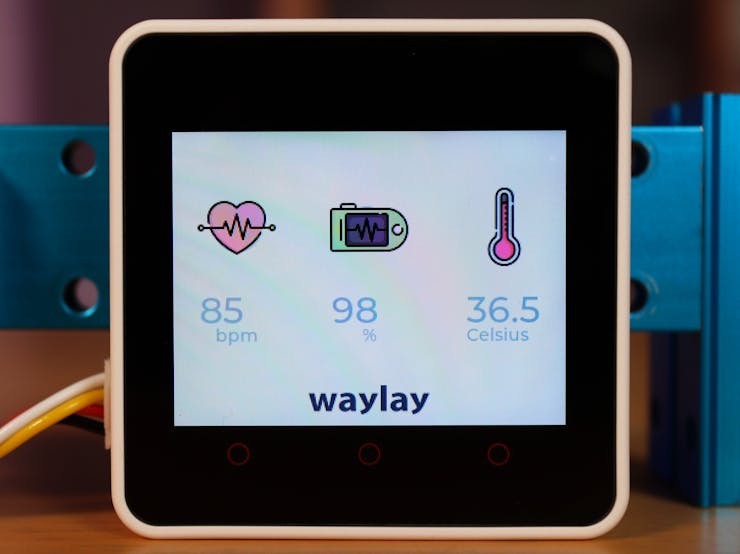

file. - Now let's test it! Place your finger on the Mini Heat Rate Unit and touch the heart icon on the display. You'll see your heart rate and blood oxygen level on the screen. And to measure your temperature, place your hand in front of the NCIR Thermometer Unit and touch the thermometer icon on the screen. No need to actually touch the sensor as it is a non-contact sensor! :D
Here's a short demo of the system:
And here is the graphical interface of the system:
Health Monitor Interface

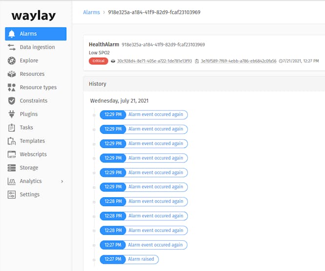

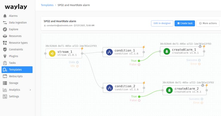

5Setting up an alarm
Alarms are a useful function through which you can get notified when the monitored values reach unwanted levels.
- Select the Templates field from your user console and click on the Add Template button.
- To create a basic alarm flow, we will be adding the necessary blocks from the blocks menu and then configure them.
- Add a Stream block, uncheck execute on tick and check execute on data, then select your Resource of choice.
- Add a Condition block, uncheck execute on tick and check execute on data, then select your Resource of choice. In the condition field write up the condition in the following format:
${nodes.stream_1.rawData.stream.replace_with_your_metric}
Ours looks like this:
${nodes.stream_1.rawData.stream.HeartRate} > 150
- Add another Condition block with the following condition:
${nodes.stream_1.rawData.stream.SPO2} < 90
- In our example, the metrics you can choose from are the ones defined in the
DataMap
variable inmain.py:
HeartRate
andSPO2
(blood oxygen level). - Add a Create Alarm block, uncheck execute on tick and check execute on data, and select your Resource of choice. Also fill in your alarm text, your desired alarm type (CRITICAL, MAJOR, MINOR, or WARNING), and create an alarm type.
- Click on the Save button and choose a name for your template.
- Now that you have returned to the Templates menu, select the previously created template and click on Create Task.
- Chose a name for your task, select the Resource choosing Reactive mode and click on Create Task.
- Now the Task is created and when the condition is met, an alarm will be triggered and it will be displayed in the Alarms field of your console and also in your dashboard linked to the same Resource as the Alarm.
