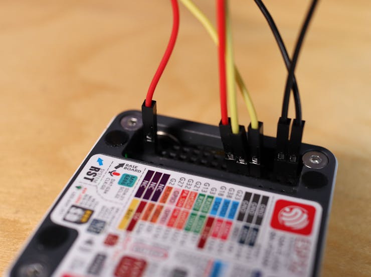

- Take out the CORE2 plate on the back to expose the pins.
- Connect one of the servo motors using the male to male Dupont wires to the following pins:
BROWN - GND RED - 5V YELLOW - G25
- Connect the other servo motors using the male to male Dupont wires to the following pins:
BROWN - GND RED - 3.3V YELLOW - G26

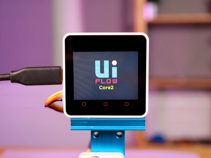

5Setting up the device

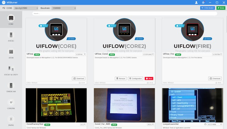

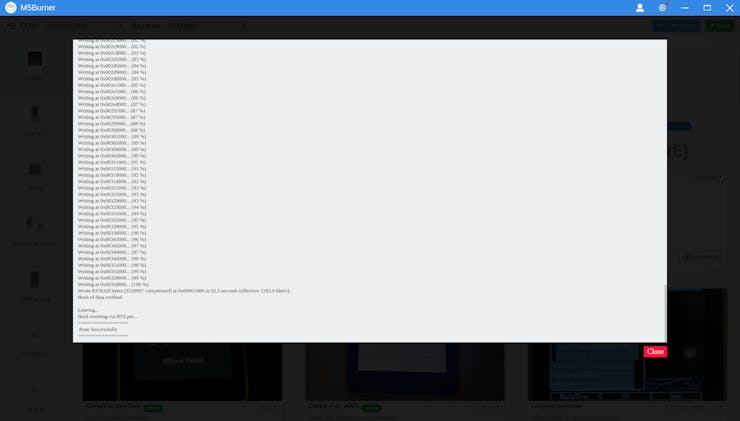

- Connect the M5Stack kit to your PC using the provided USB Type-C cable and launch M5Burner. The port name should appear on the top-left corner of the app (near COM). On Linux, make sure your user is part of the dialout group by running:
sudo adduser $USER dialout
- Download the UIFlow(CORE2). Click the Erase button and wait for it to finish.
- Click on the Burn button to upload the UIFlow(CORE2) firmware on the device. We have used 1.8.1_core2 . You will be prompted for the WiFi details that the device will use to connect to your local network. If the burn fails, change the baud rate to a lower one.
- Now click on the Configuration box corresponding to UIFlow(Core2) and select App Mode from the dropdown in the provided screen and add the Wifi details if not present.
- After it finished rebooting, you will be greeted by an initial screen with the UiFlow version in the top right.

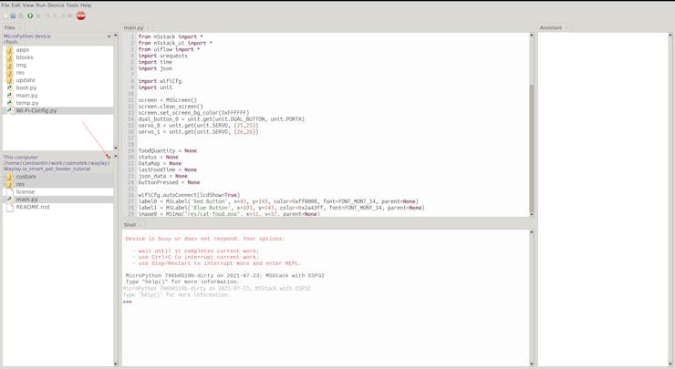

- Launch Thonny and from Run -> Select interpreter set up the interpreter to MicroPython (ESP32) and while at it pick the device port.
- Click on the Shell text field, press CTRL+C, or press the STOP button to connect to the device. Once you see the >>> symbol, you can access the files on the device. Go to View and select Files to set up your workspace. Then go to the
temp.py
file provided in this tutorial (check the Github Repository link in the Code section below) and edit the URL in theSendPOST()
function with the URL of your Webscript. You can find it on https://console-io.waylay.io/webscripts, below the name of your Webscript. Click it to copy it to the clipboard (make sure the secret is included). - Select all the files from the folder downloaded from GitHub by holding Shift and clicking the files (
main.py,
and the 2 folders:custom
,res
, files provided in this tutorial). Exclude the Readme file, right-click on the menu icon (3 horizontal lines as shown below) and press Upload to /flash, press ok and you are set. Confirm the files being overwritten.
- At this point be sure to have all the sensors connected as instructed before or else the program will hang on a white screen.
- Reboot the M5Stack by pressing the down-side button, the one near the sd card slot (the screen will shut down and refresh). The device will connect to the WiFi network and automatically run the
main.py
file.
- When the device successfully sends the data to the server you will get a
Data sent
message on the bottom-left side of the display and the200
HTTP status code on the bottom-right side of the display (meaning the request was successfully received, understood, and accepted).

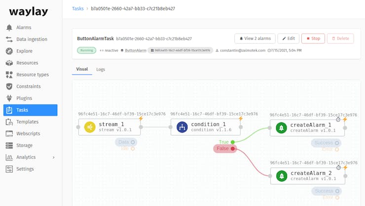

- Select the Templates field from your user console and click on the Add Template button.
- To create a basic alarm flow, we will be adding the necessary blocks from the blocks menu and then configure them. Add a Stream block, uncheck execute on tick and check execute on data and select your Resource of choice.
- Add a Condition block, uncheck execute on tick and check execute on data and select your Resource of choice. In the condition field write up the condition in the following format:
${nodes.stream_1.rawData.stream.replace_with_your_metric}
- In our example, the metrics you can choose from are the ones defined in the
DataMap
variable intemp.py
(foodQuantity
,ButtonPressed,
ButtonID
). Let’s make an alarm to check whether the Red or the Blue button was pressed:
${nodes.stream_1.rawData.stream.ButtonID} < 2
- Add a Create Alarm block, uncheck execute on tick, check execute on data, and select your Resource of choice. Also, fill in your alarm text: “Red button pressed”, your desired alarm severity (CRITICAL, MAJOR, MINOR, or WARNING), and assign an alarm type.
- Create another alarm with the “Blue button pressed” text.
- While setting up the alarm, pay attention when filling in the Alarm Type field. The Alarm Type is the property of an alarm that uniquely defines it, it is the “name” of the kind of alarm if you will. Alarms of the same type get grouped together. The text on the other hand only gives some context and does not have to be unique. In our case, we have assigned two different alarm types for the 2 buttons we have on our device: "BlueButtonPressed" and "RedButtonPressed".
- Connect the blocks as in the picture below.
- Click on the Save button and choose a name for your template.
- Now that you have returned to the Templates menu, select the previously created template and click on Create Task.
- Chose a name for your task, select the Resource choosing Reactive mode and click on Create Task.

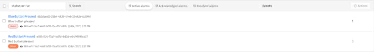

- Now the Task is created and when the condition is met, an alarm will be triggered and it will be displayed in the Alarms field of your console and also in your dashboard linked to the same Resource as the Alarm.
- Press the red button and the blue button on the device and after that, open the Alarms field in your console. It should look something like this:

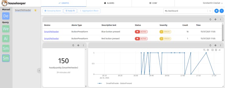

Now that we managed to consistently send data to our cloud solution, it’s time to set up a dashboard to display it.
- Head to dashboard-io.waylay.io/ and log in with your account data.
- Create an organization by clicking on the + sign. The name of this organization must be identical to the customer name (metadata property) you have used when defining your Resource.
- Click on Log in as admin.
- Click on the + sign in the bottom left, click on Query, and in the tag field fill in the value of the tags property you have picked for your Resource.
- Name your group and finally click on Create group.
- Click on your query and then on your resource name.
- Click on the + sign next to My dashboard, select the desired representation, select the metric you want to represent, and then click Save. Ours looks something like this:
- Our dashboard is made out of an Alarm widget that signals us when the button press took place, a Bulletin widget that displays the food quantity delivered by the device and a scatter plot that shows us the history of button presses.
- After adding all widgets, click on the cogwheel next to the + sign and then click Publish.
- Click on My dashboard and select your dashboard (notice that the + sign disappears), click on the cogwheel, click on manage and then select public.
By clicking on the connectivity button, you can get the link for your public dashboard to share with your friends or access it from any browser.
