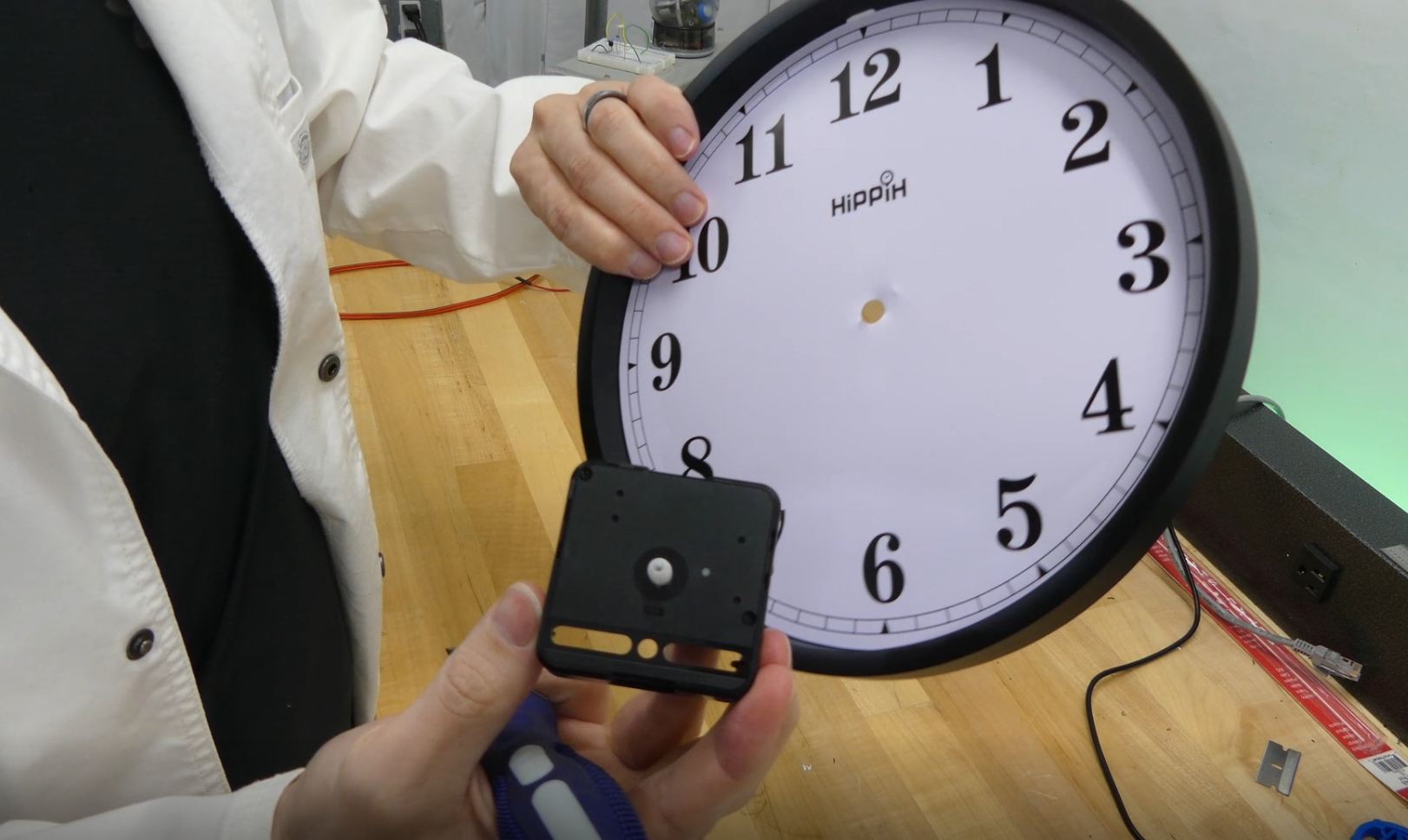

    Take the clock apart
    This is the easy step, just take the clock all apart to the base platform.  Remove the face, hands, and motor.

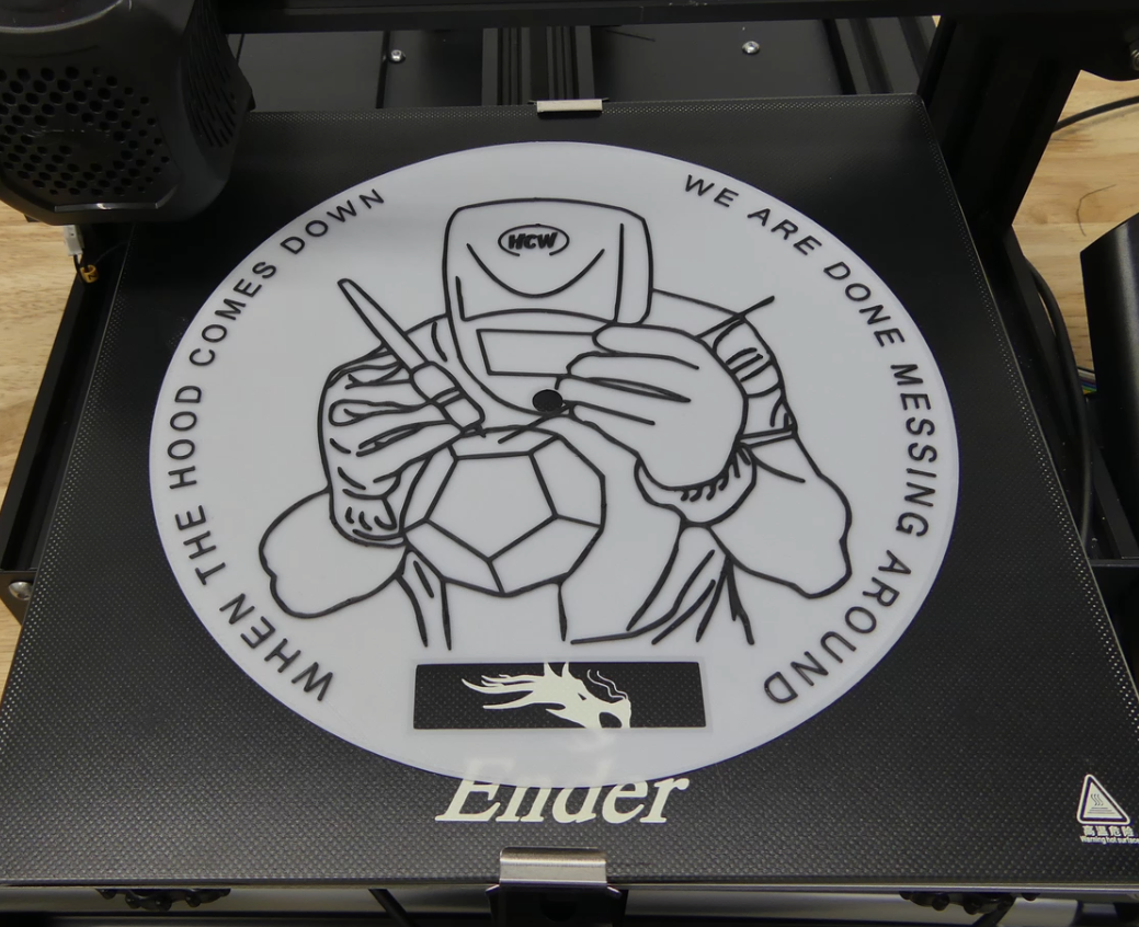

    Print out a new face.
    I used my 3D printer to make the face but you don't have to. You could just print out something on your printer. But, because I used my 3D printer with a small bed, the face I printed didn't cover the entire clock. This turned out to be OK because I had also printed out inside trim pieces to offset the face from the back of the clock.
    If you do use a 3D printer, this will have to be a vector graphic.
