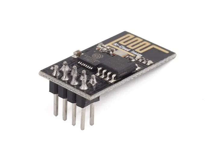

See the ESP-01 printed circuit board presented below.
Figure 2 - ESP8266 ESP-01 Board.

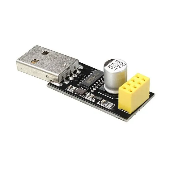

The ESP8266 ESP-01 requires an external circuit to transfer programming. This circuit consists of 2 buttons: Flash and RESET. See the image presented below.
Figure 1 - Shield ESP8266 ESP-01 Programmer.
Shields that are sold on the market do not have these buttons, and this makes it difficult to transfer code to the ESP8266 ESP-01 board.

The ESP-01 is connected in socket 2x4 presented in our ESP-01 shield programmer.

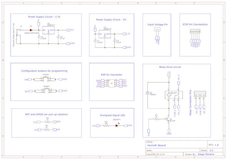

Below we have the electronic schematic of the shield ESP8266 ESP-01 programmer. It was divided into 9 blocks.
Figure 2 - Electronic Schematic of the Shield

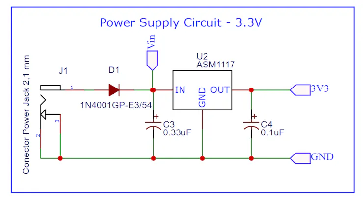

Next, we will begin the discussion of each block in the shield circuit. Initially, we have the power input circuit through a jack connector. The input voltage for the project is from 7V to 9V.
Diode D1 is used to prevent polarity reversal of the source connected to the connector Jack.
Figure 3 - AMS117 3V3 with input voltage of Jack Conector.
After the diode, the input voltage (Vin) is transmitted to the two voltage regulators of the circuit (AMS1117 3V3 and AMS1117 5V), and the pin header is presented below. The pin header is applied to offer Vin voltage for a protoboard.
Figure 4 - Pin header to offer Vin voltade for protoboard circuit.
The voltage regulator capacitors were selected based on the indication of the AMS1117 IC datasheet.
Figure 5 - AMS117 5V.
These two voltage levels are used to power the ESP8266 ESP-01 (3V3) and drive the relay coil (5V).
In the circuit, we put an indicator LED to signalize that the circuit is powered, which is presented in the figure below.
Figure 6 - LED Indicator.

See the board shown in the figure below.
Figure 8 - ESP01 Programmer Shield.
This board is sold in several stores around the world, but it has a big problem. You need to solder the buttons to set the CHIP ESP8266 ESP-01 to programming mode.
Do you want to buy a card and change the structure when you receive it?
Certainly not! That's why we created our version.
