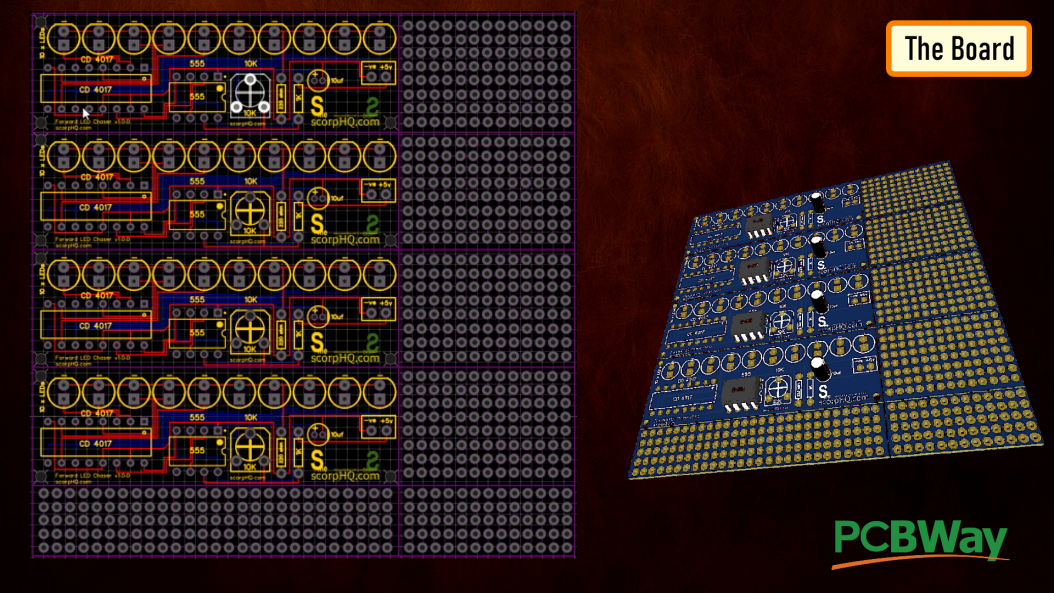

The Board
So this is how my board looks like. I have 4 breakout boards in this 100cm x 100cm assembly.
Soldering
Lets start by soldering the 2 resistances to the board. Then,lets solder the 10uf capacitor to the board. After that, lets solder the 10K pot. Next, lets solder the 2 IC bases and install the two ICs to the bases.
I am not going to solder any LEDs directly to the board, instead I will solder them to separate boards and then connect them using ribbon cables.
